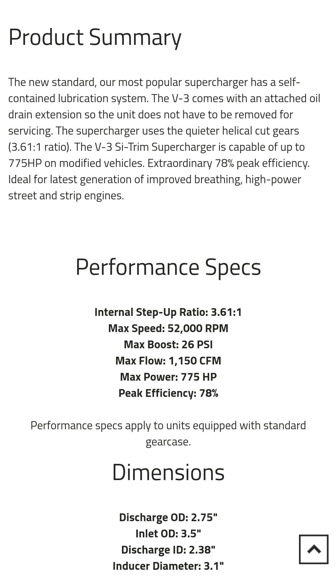

Old Jul 23, 2020 | 10:53 AM
  #239
Turpid porpoise's Avatar
Turpid porpoise
Joined: Jul 2014
Posts: 2,356
Likes: 359
[QUOTE=Speedy007;1601879590]
straight from vortech's website, maybe you thought you had a ysi instead
Internal Step-Up Ratio: 3.61:1
Peak Efficiency: 75%
52000
MAX SPEED: 52,000 RPM
22
MAX BOOST: 22 PSI
1250
MAX FLOW: 1,250 CFM
900
MAX POWER: 900 HP
The numbers you quoted are for the V3 Ti, which you don't have. You have a V3 Si which is what Neutron and I both posted the data for.
