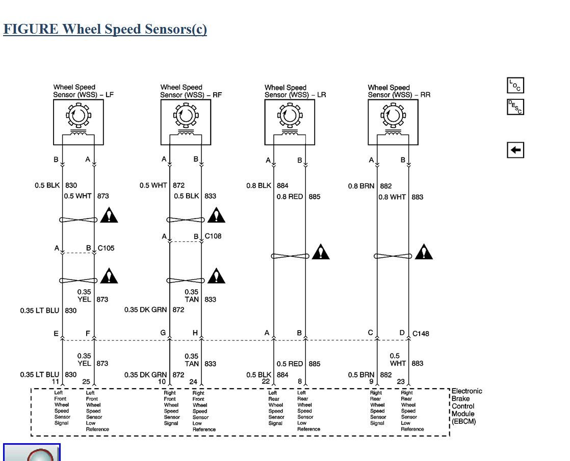

I know there is a lot of information on this topic. I have followed most of the advice I have found on the forum. I have a 2002 Z06 18,000 miles. I am getting C1233 code. After I clear the code it is come back on when I hit about 65mph. I can drive it for days and stay under 65 mph and the code never returns.
I have tried the following:
  • Switch the right and left wire harness that plug into the speed sensor, no change in code, also cleaned and check the connectors (male and female).
  • Tested the resistance and voltage of both front speed sensors, both seem to be in spec.
  • Cleaned grounds near the front fender wells.
  • While connected to my scanner monitored the wheel speeds they are always the same.
  • I ran jumper wires from the left side to the right side on both wheel speed sensors, drove the care still same code.
I suspect that I either have a problem in the wiring harness or a problem with the EBCM. The solder repair on the EBCM I have read about doesn’t seem to address this code.
Any thoughts?

The C1233 indicate RF wheelspeed sensor . Have you verified every connection point (C108 and C148 ) for good continuity including the EBCM terminals ?
