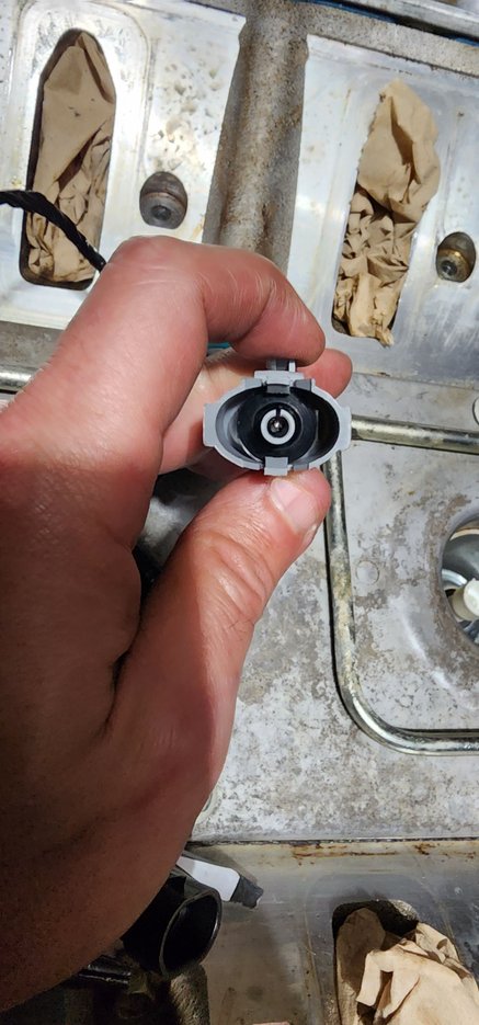

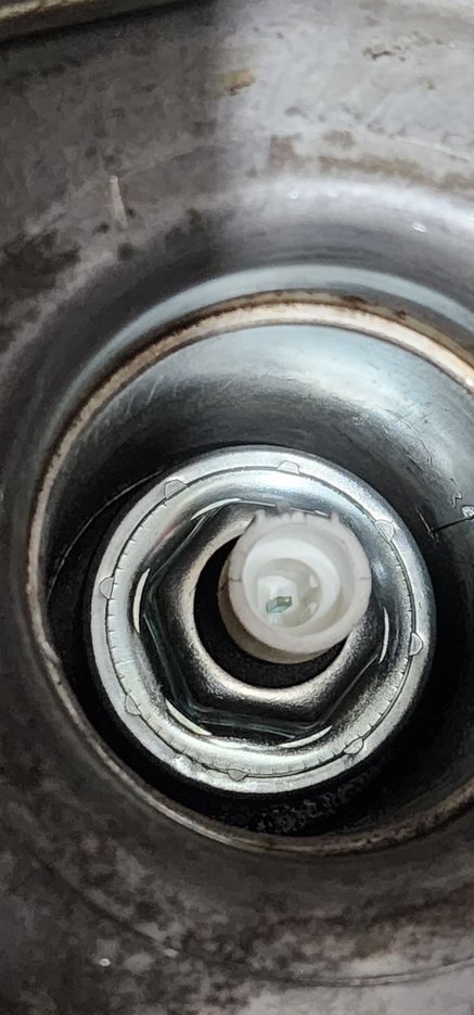

I think i might know the answer to your question but it will raise another question.
I have a 97 C5. When I bought the car 2 years ago it had a check engine light for both knock sensors. I was told that they were just replaced and it must be a glitch in the system. the car runs fine no issues. I have put maybe 6k miles on it and last week I noticed I needed a new belt and also one of my valve covers are leaking. So since I was going to be taking some stuff apart I said I'll go ahead and replace those sensors while I'm at it. This is where the problem starts.
After alot of searching and alot of frustration I found out that the 97 and 98 C5s have a different knock sensor and harness than the 99s and up.
The 97 and 98 harness is no longer in production and you cant buy a new one. All anyone has is a harness for a 99 and up. The harness has a different pigtail than the 97 and the sensor for the 97 is different from the 99 and up. If you replaced them and got codes and yours is a 98 then i am willing to bet the reason is due to you putting 99 and up sensors and harness in.
My question is what are we suppose to do to fix this?
I will attach the new harness and sensor I bought compared to the old sensor that came out of the car so you can see the difference.
I don't have the 97/98 harness so I am screwed until i can figure out what to do.
As you can see from the photos, the newer harness and sensor are completely different
This is the sensor I pulled out of the car which was unbranded and broke anyway.
This is the correct sensor for the 97/98
This is the harness for the 99 and up.
