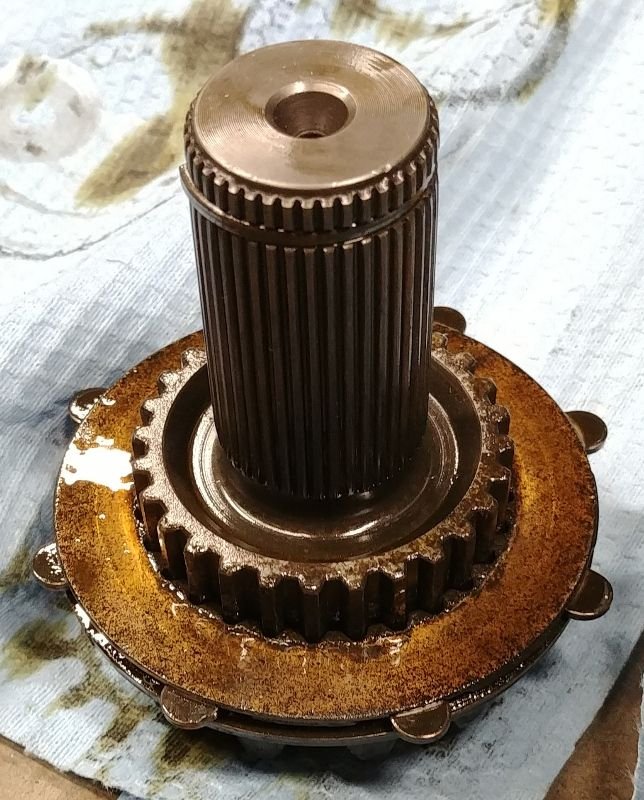

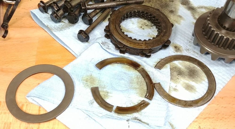

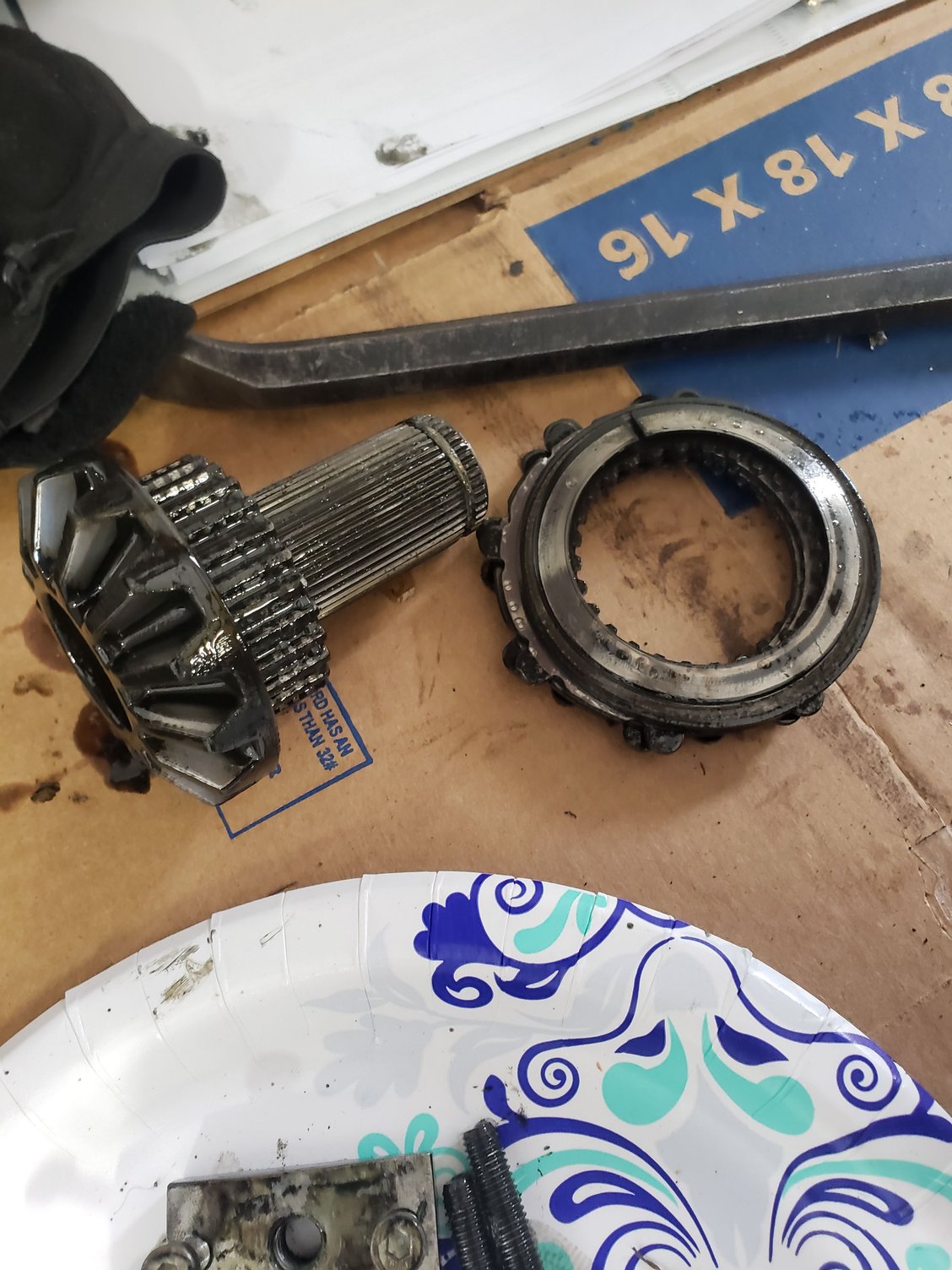

Originally Posted by MetalMan2
You're right, it's not. My Z06 with 70k, spun freely by hand when tested *out of gear*, and these were what remained of the belleville springs that came out of the LSD:
And the clutch packs were TOAST:
I did a rebuild of the LSD using C6 Z06 clutch packs and belleville springs.

Likes: 10
From: Aiken SC
Both Belleville washers were broken and had sections missing. There was scoreing inside of the diff casing, nothing crazy. I replaced with C6Z clutch packs, washers, side gears and shafts. It was a pleasant weekend job. Thank you for all of the input and help!!
