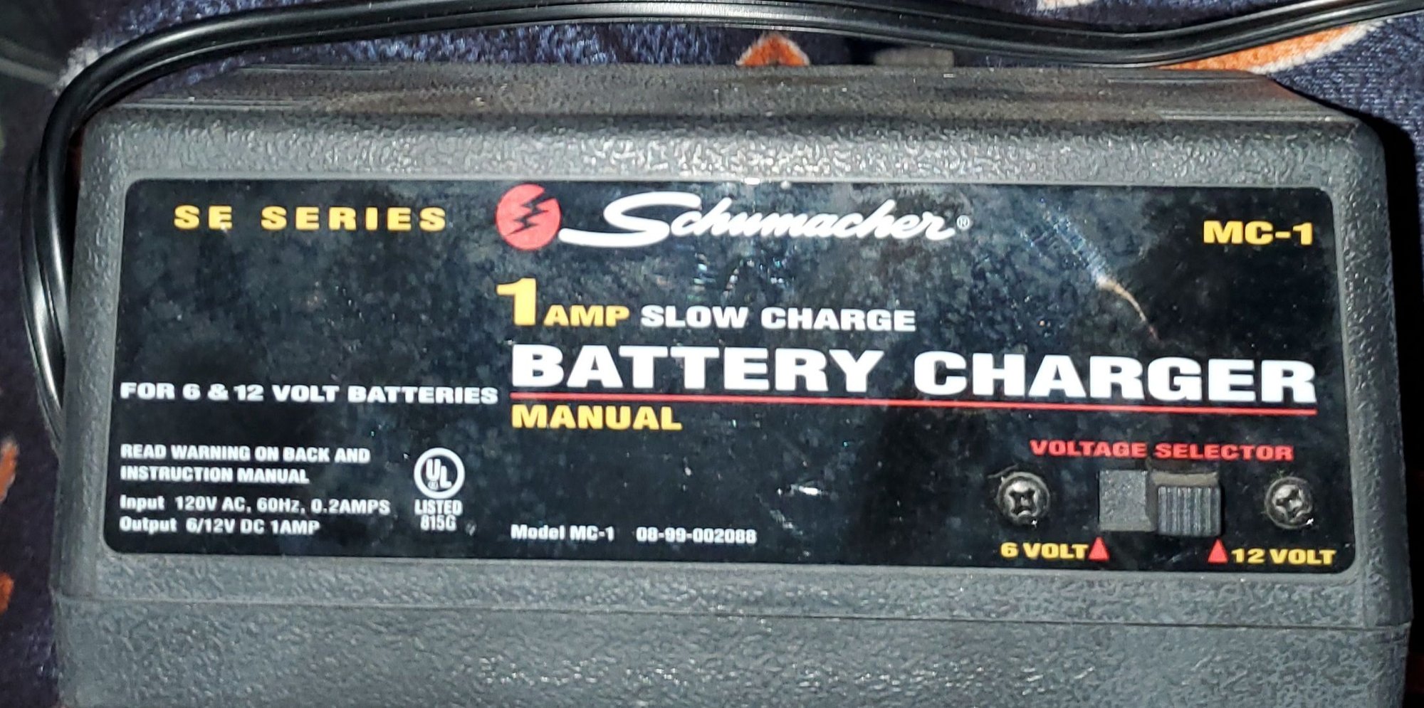

Yeah florida would be nice right now. Chicago. Yes to everything. After car sat for a week the battery is still 12.6. I hook the batt back on and the car starts right up with fast cranking. Again i checked meter with putting it in line with a battery charger and read 4amps charger, its a 1amp charge Its for electric bike battery. black ground to meter wire. red wire to battery negative.
This is not how i hooked up the wires. This is just to show meter works.
And by the way there is a safty switch internal that shuts off after 2 seconds of over draw then kick back on and that's
continuous.
I don't know why this popped up in my head but it's like choking or friend to death bring im back and do that over and over.
