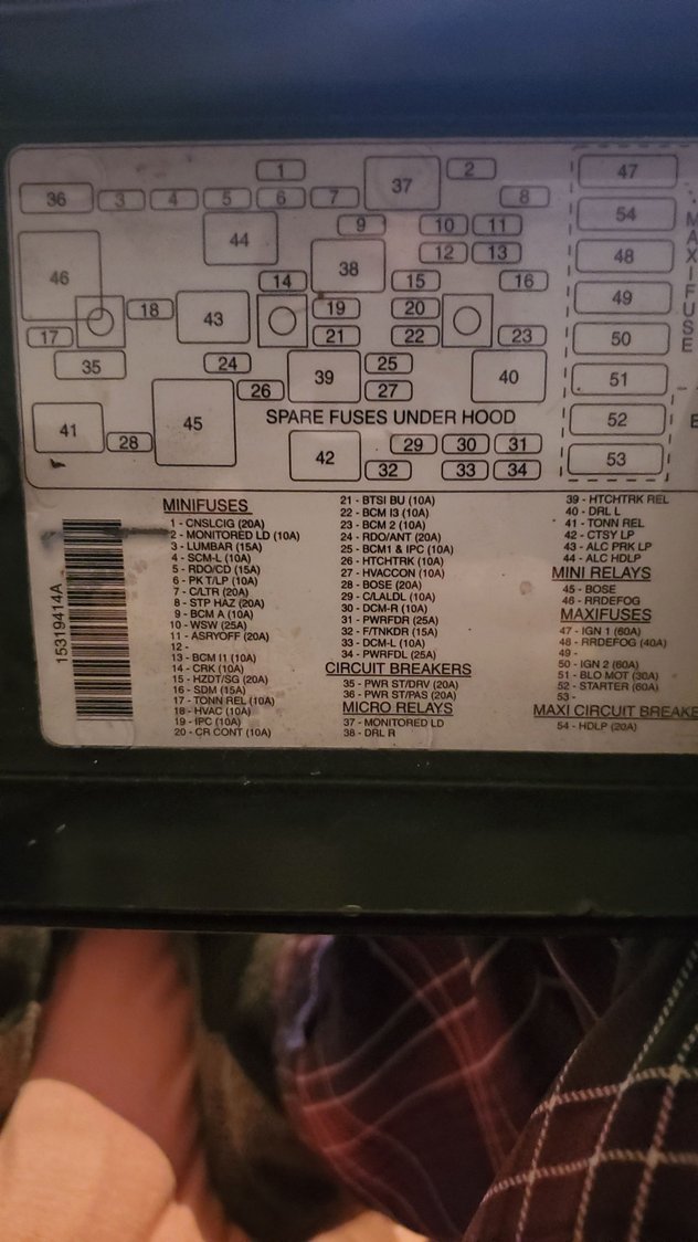

Ok guys finally warmed up. So this is where I'm at. Car is 3.4amp. sleep mode .230
I didn't unplug PCM in sleep.mode Pulled top plug of PCM first, went from 3.4 to .200. Don't know what this means.

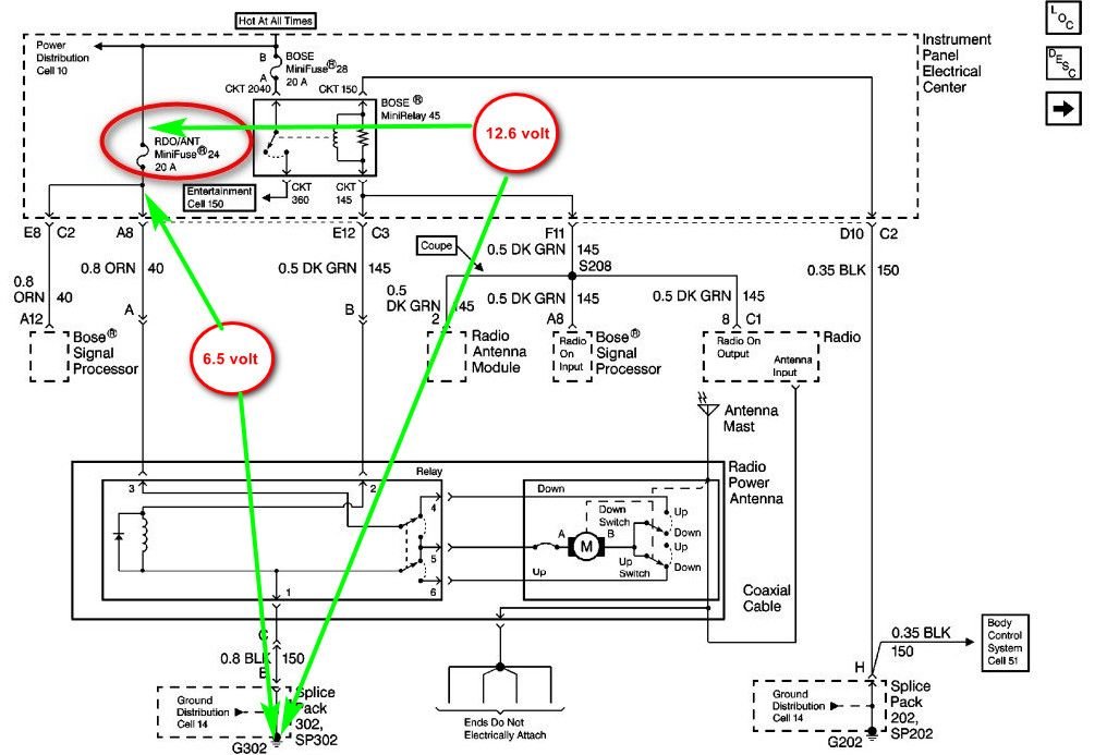

second fuse 24 keeps blowing. One side of the fuse insert reads battery voltage 12.6 and the other side reads 6.5v. Again don't know what this means.

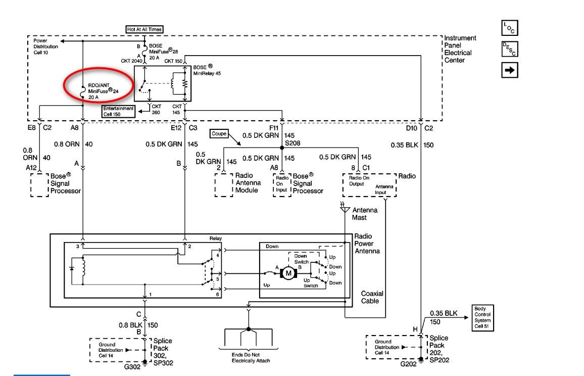

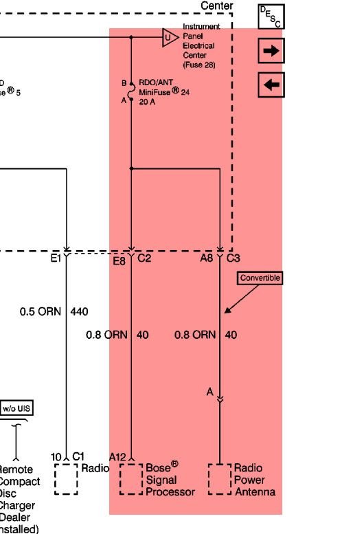

The Fuse 24 is feeding your Bose signal processor and the Power Antenna .
Try to disconnect power antenna first and see if the fuse still blows
The fuse 24 is feeding the antenna motor through the relay

My car doesnt have power ant. Relay is pulled out. But again, how is the load side getting 6.5 volts???

Is this the correct way of understanding on how you measure your voltage values 6.5 and 12.6 ?

Yes. Where would the 6.5v come from. Thanks for ur help.

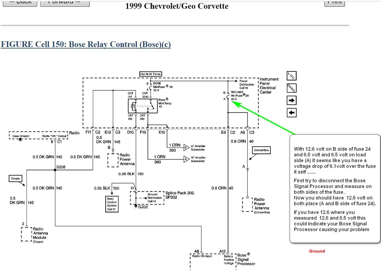

Try to do what written on the schematic , disconnect the Bose unit and measure the voltages
Thank you ill give it a try, once it warms up around here.

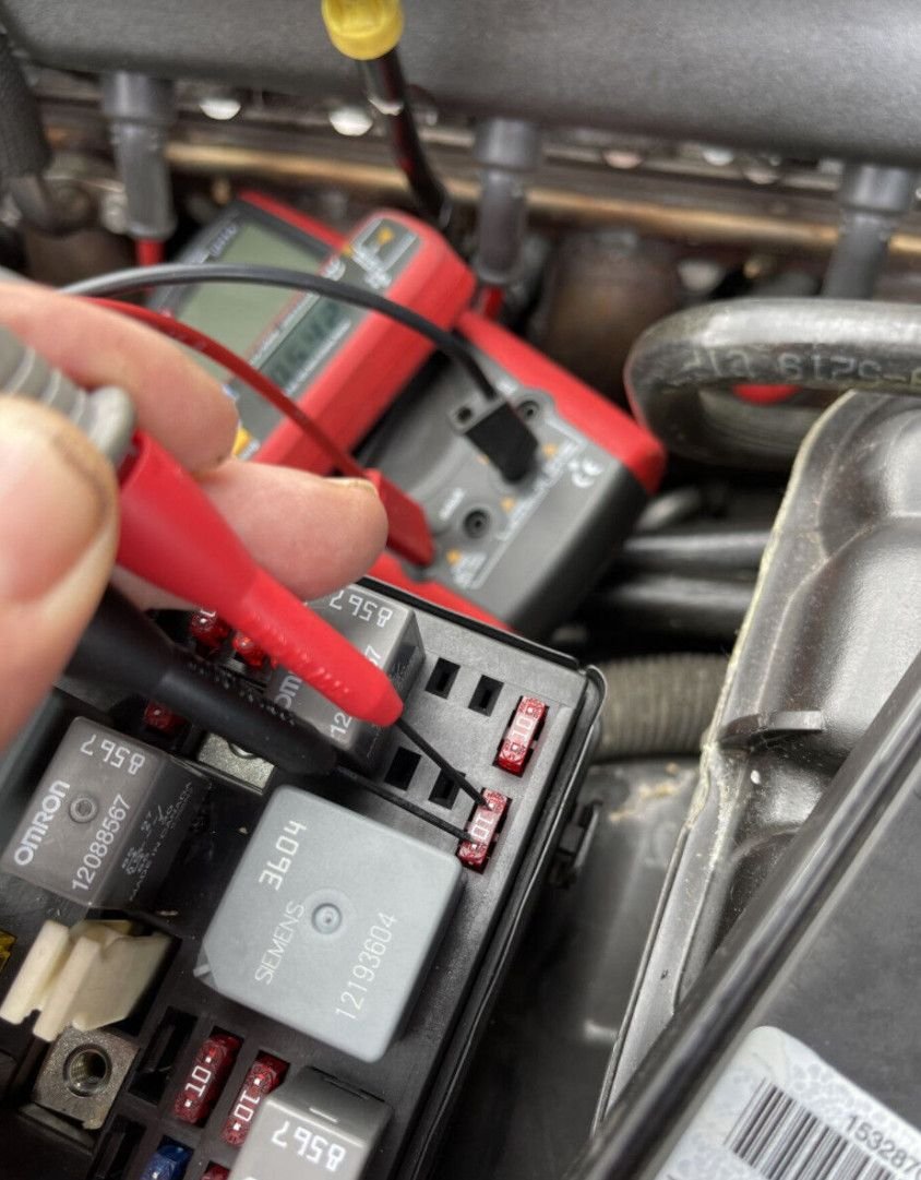

Try to open hood and your passenger door and activate the doorlock like this . Then you can leave the passenger door open as long as you need without interupting the BCM. sleepmope when it appear after 12-15 minutes .
Now you can access both fuseboxes withaout interupting the sleepmode of the BCM
Then measure the voltage across each fuse in passenger footwell and engineroom with your DVOM in mV range .
Measuring voltage drop is much easier and quicker way and you don't interrupt the sleepmode of the BCM like you do when pulling fuses

Thank you, I ruled out hood fuse box by disconnecting power so it is completely out of the equation. My tips of prongs are bigger than ur, i have to go out and get some needle like tips.
And yes i locked both doors.
