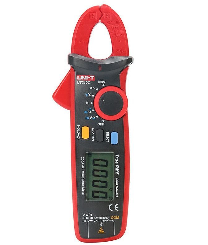

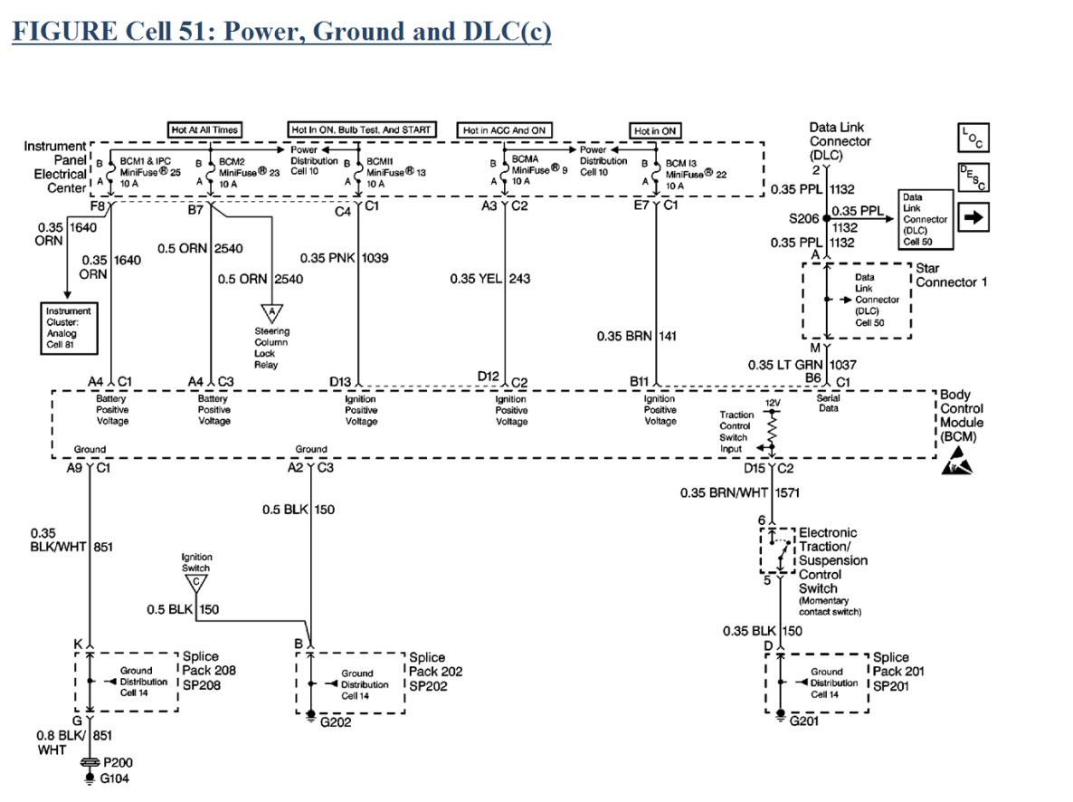

When your BCM has gone into sleepmode , can you measure the voltage above each fuse under hood and in the instrument panel (passenger footwell with DVOM range in mV (millivolt) and report back if you have any fuses above above zero mV ?
BCM has two MiniFuses (23 &25) feeding the BCM when ignition OFF.
This UNI-T UT210E Handheld Digital Clamp Meter is very useful when tracing current leaks on cars. I use mine a lot ,it's accurate and it's easy to use

Ok just to clarify, One side of the fuse is hot all the time but im going to measure the other side to ground???

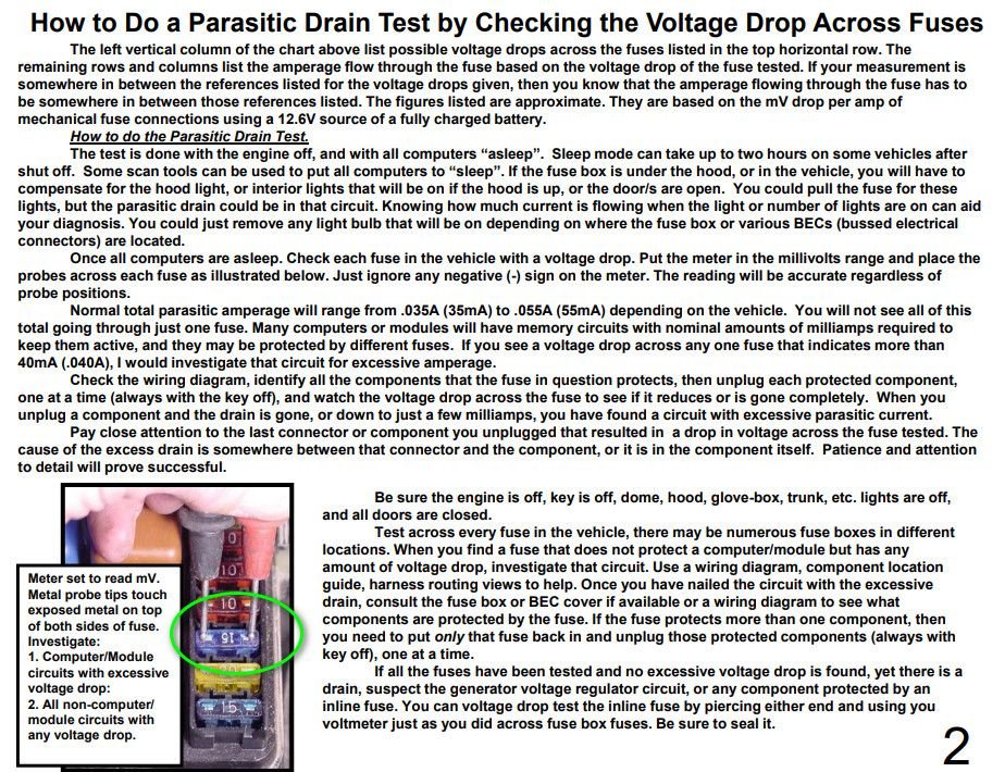

No , you measure voltage drop over the fuse itself , like shown below .Bothe sides are hot , but with a mV drop if you have a current leak
When I left my foglights on , I measured 30mV over the 10A MiniFuse

When you measure across fuse 23 and 25 you should have a millvolt reading that corresponds to 210 millamps of sleep mode current, that will tell you that the BCM is the cause of excessive current draw.
