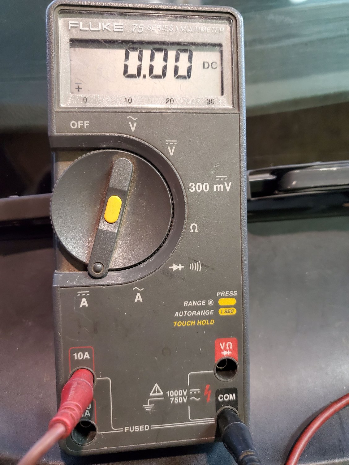

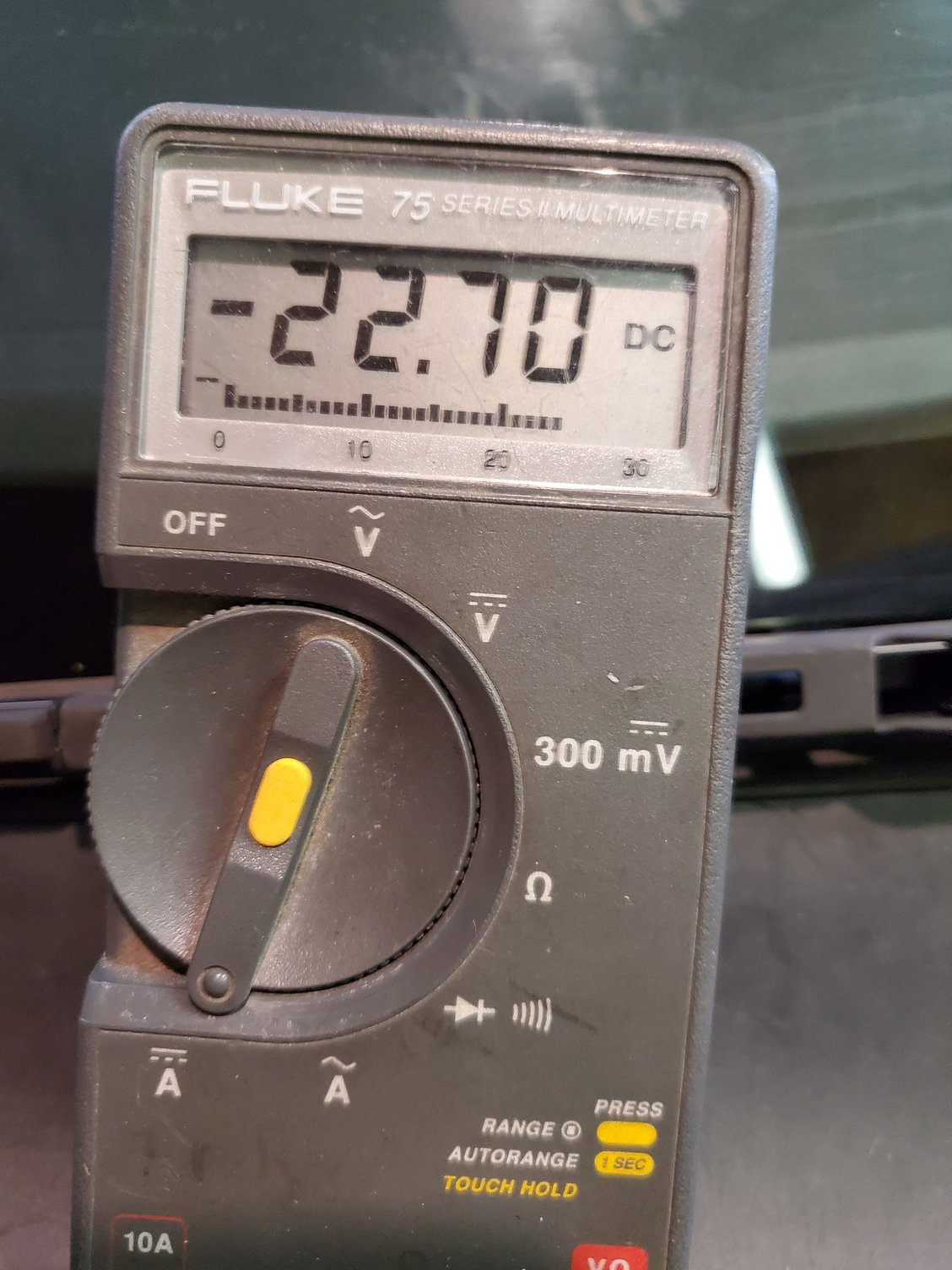

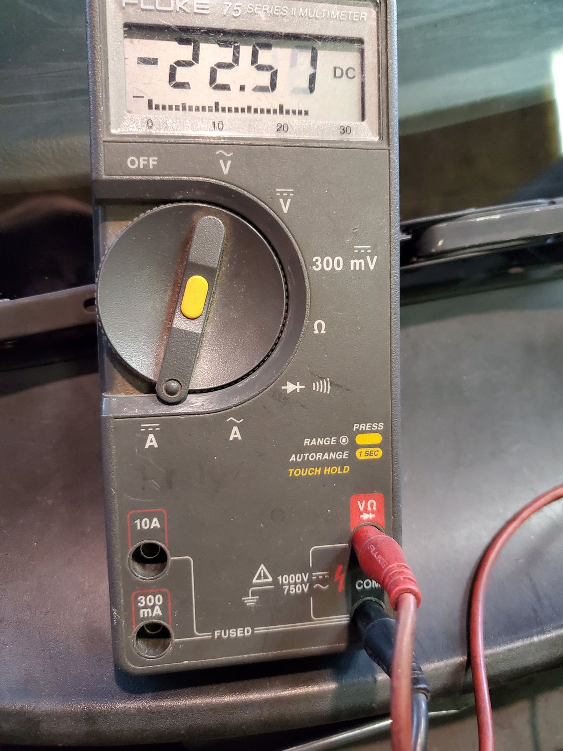

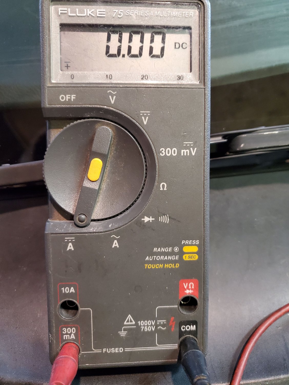

Thanks guys for answering. I have no power seats, i'm using the check the fuses for voltage draw. Here's the meter and this draw is constant. Does not change when it goes into sleep mode. Thanks for the read.

What am I looking at in that last picture? You have the meter leads connected to the Volt/resistance input but the rotary switch set to DC amps. The meter won't work like that.

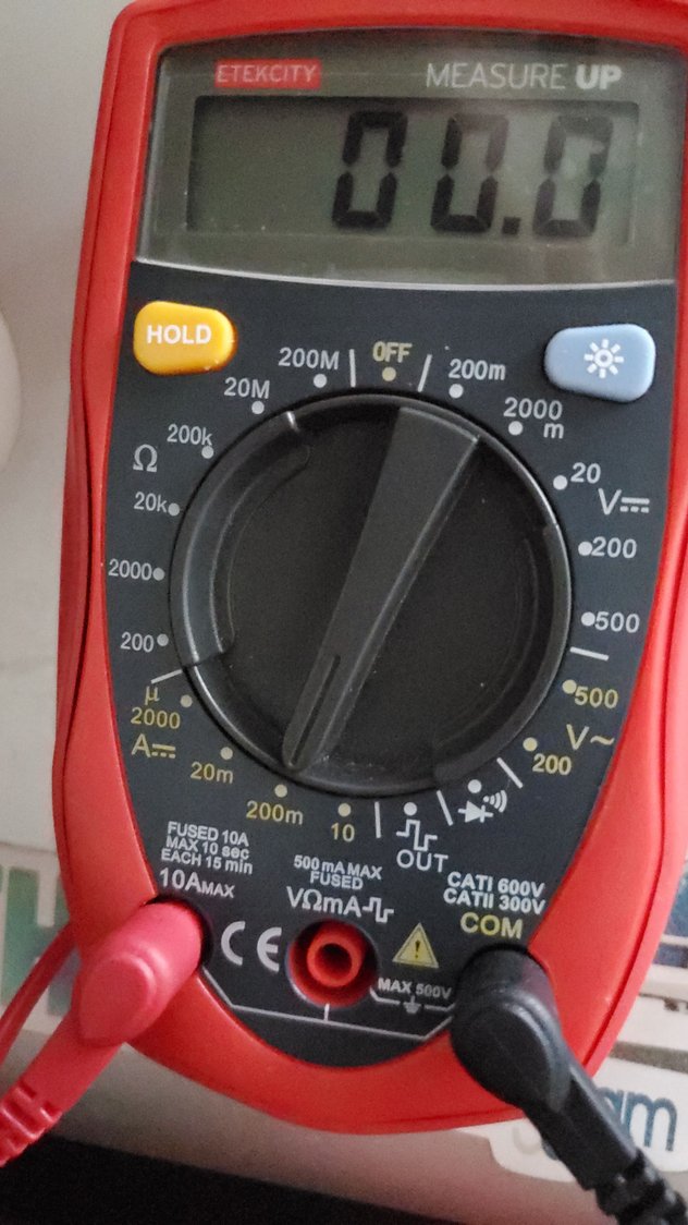

I showed all the positions on the meter to show what values im getting. The two that are on the right connections show 0 amp draw that can't be right or am i missing something here??
Yes i forgot to change to ml amp. It's impossible not to draw amps especially not in sleep mode?? I'm i doing something wrong??

I order for you to check current draw the meter has to be in series with the battery (unless you use a shunt in series).
Disconnect the neg battery cable from the neg terminal of your battery and let it hang disconnected for the moment
Connect the red meter lead into the 10A socket of your meter
Connect the black meter lead to the common socket of your meter
Set the meter to DC amp, don't press the range hold, let it autorange
Connect the red meter lead to the neg terminal of your battery
Connect the black meter lead to the Neg battery cable end
What does the meter read now? If it reads more than 10Amp (unlikely) disconnect the meter leads, you don't want to blow the fuse in the meter if you can help it (they cost about $10 ea)
If it reads less then 0.3A repeat above but with the red meter lead connected to the 300mA socket.
A prefect functioning car will still draw some current after it goes into sleep mode so a reading of zero can't be right.

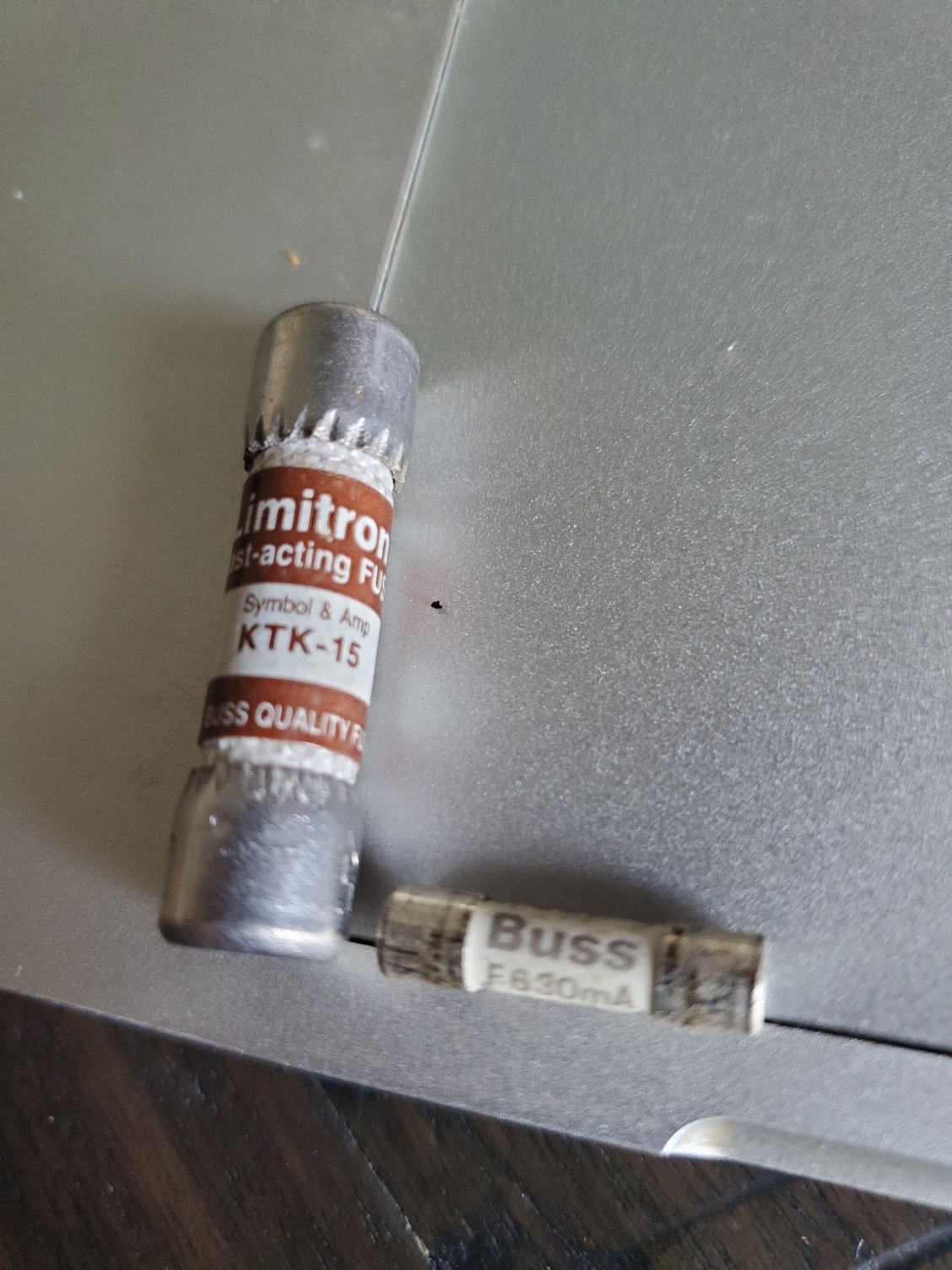

Thx for the reply guys, ill check those i did disconnected the red cable as you said but ouvioul meter wasnt working.. Don't know what happen but both the fuses are blown in the meter.

If you blew the fuse, you either over currented the meter OR put the meter leads across the positive and negative like you would measure VOLTAGE. That will blow then every time. You MUST read current in SERIES from the negative battery terminal to the NEG Battery cable. Always start the current measurement in the 10 AMP scale as the car can draw 5-6 amps during the first connection of the leads. I saw mine draw 8 amps at first connection.
If you are drawing 25 AMPS, the meter would have blown the fuse right off the bat and you would have seen a BIG spark when you connected the leads. The correct current draw that you should be seeing is 20-25 MILLIAMPS That would be 0.020 on the 10 amp scale.

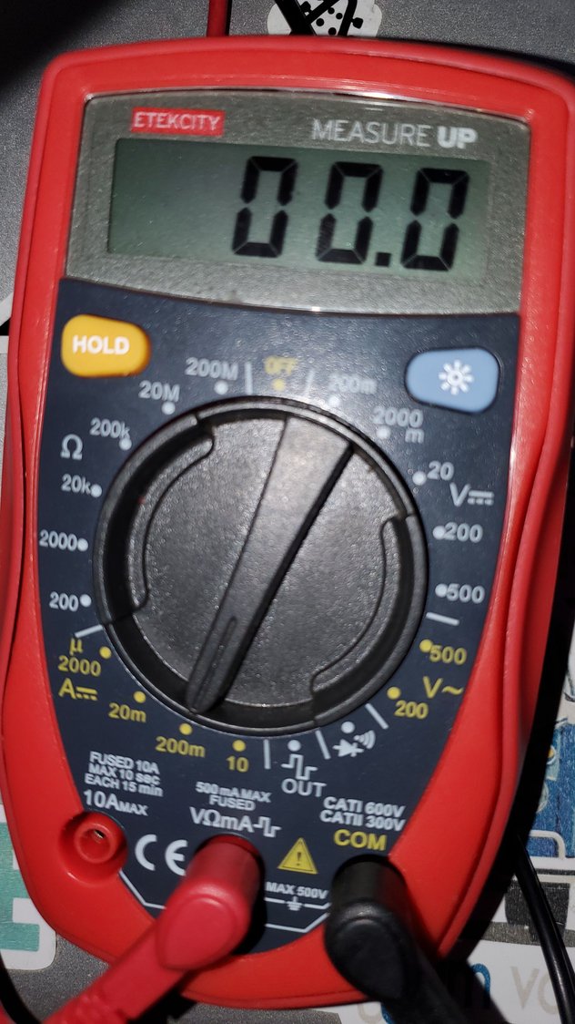

Ok guys sorry i didn't get back sooner. Update i finally got back to tackle draw issue. Pulling .250a. Did all what was suggested and the common list to check. Disk connect positive wire under hood to the fuse back and same reading so, i can rule out fuse box under hood out, i think. So i don't know why i did not get voltage across fuse so i pulled the fuse and draw fell to .150. had to help neighbor and the temp dropped to low 20s. I read the battery volts were 12.6 before leaving After a week i checked the battery again and still 12.6 so connected battery and started car with absolutely no problems fast crack. Left battery cable on. Checked volts 2 days later battery at 7v took 5 min to charge full 12.6 again. and car started prefect again. Ok here's what confusing i connect inline with the ground wire with both my meters and it would not show an amp reading. While still connected i hear a clicking noise by the front right light.. I check the meters by putting in line with my 1amp charger and it went up to 4amps, i have a 6amp fuse in my meter.
PS i checked all relay with a laser temp gauge and there all the same reading.??
PSS I'm dead serious i'm so sick of this. I will pay u $50. Anyway u want to get payed.
Any thoughts???
This is how i set the meter.

You measure 0.25 amp inline with the battery - is this immediately after you connect the meter or after a few minutes after it goes to sleep? Do do have an after market stereo or alarm system?
