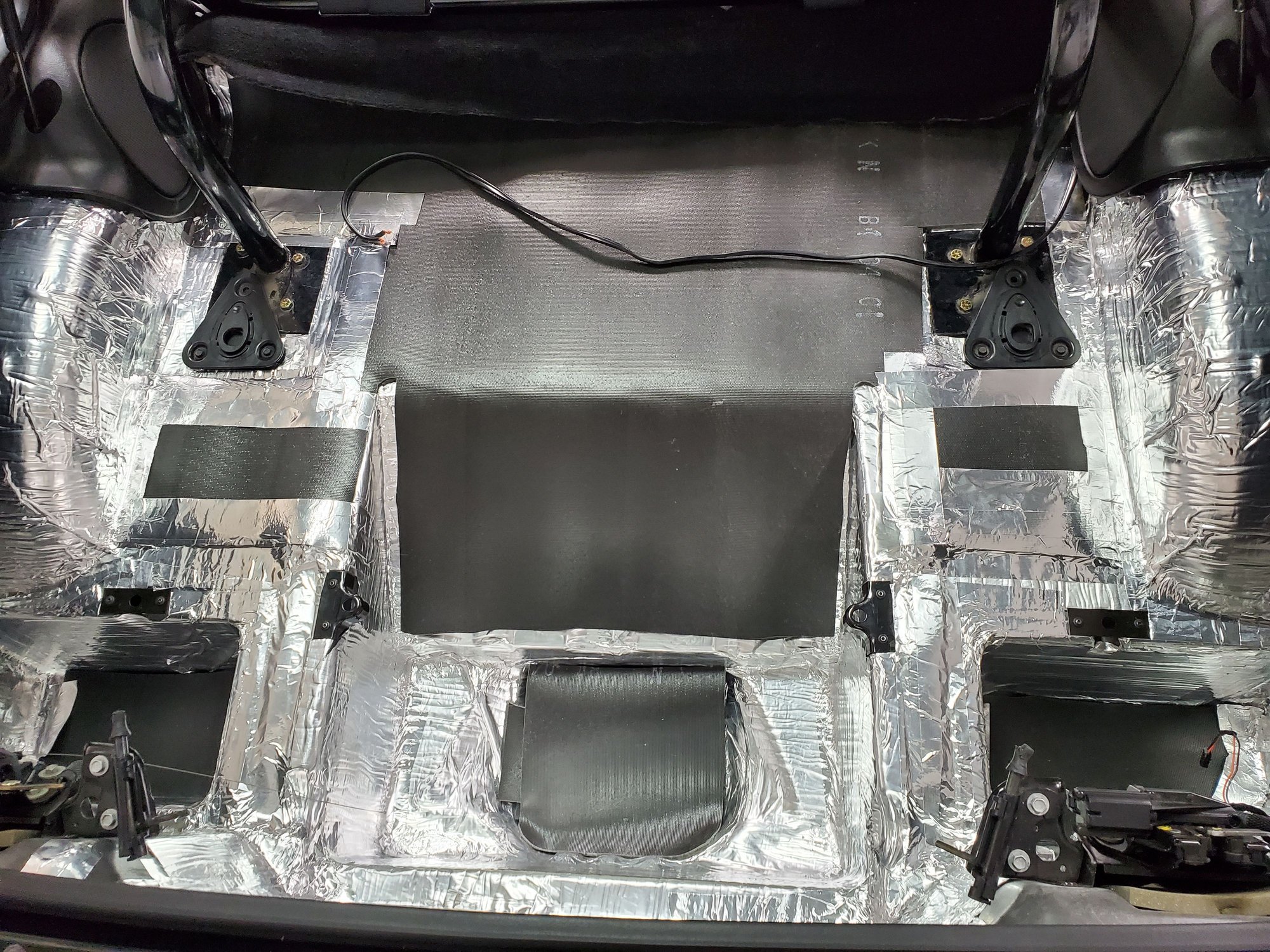

Give yourself plenty of time. The worst part is getting some of the plastic trim out, but there’s some videos on YouTube that help. Maybe do the front one weekend, then the back afterward. It’s not hard, but you will need a set of panel removal tools and a little patience. Also a good idea to bag and tag all the little push in connectors as you go.
I went full bore with sound dreading, foam, and MLV layers but that’s a bit of work. I would recommend laying down some Kilmat on the large flat surfaces and for sure on the wall behind the seats. You don’t have to cover every square inch and it doesn’t need to be perfect, just hit the big panels that tend to resonate.
I bought this stuff on Amazon. The trim tools are excellent quality. If you get the Kilmat you will need a roller and work gloves. The edges of that stuff will give you a ration of paper cuts without gloves.
