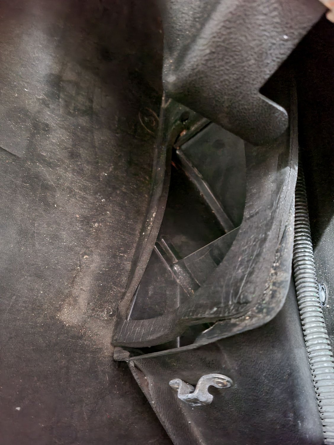

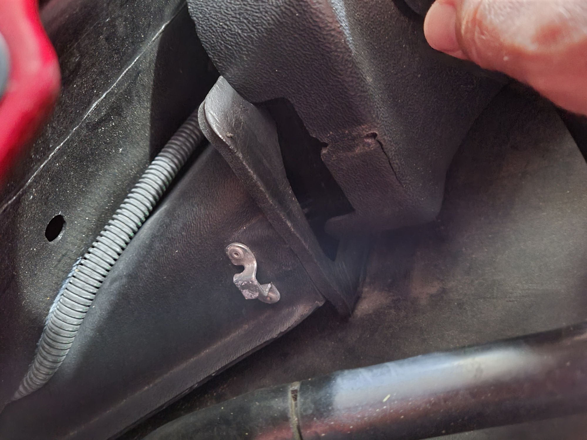

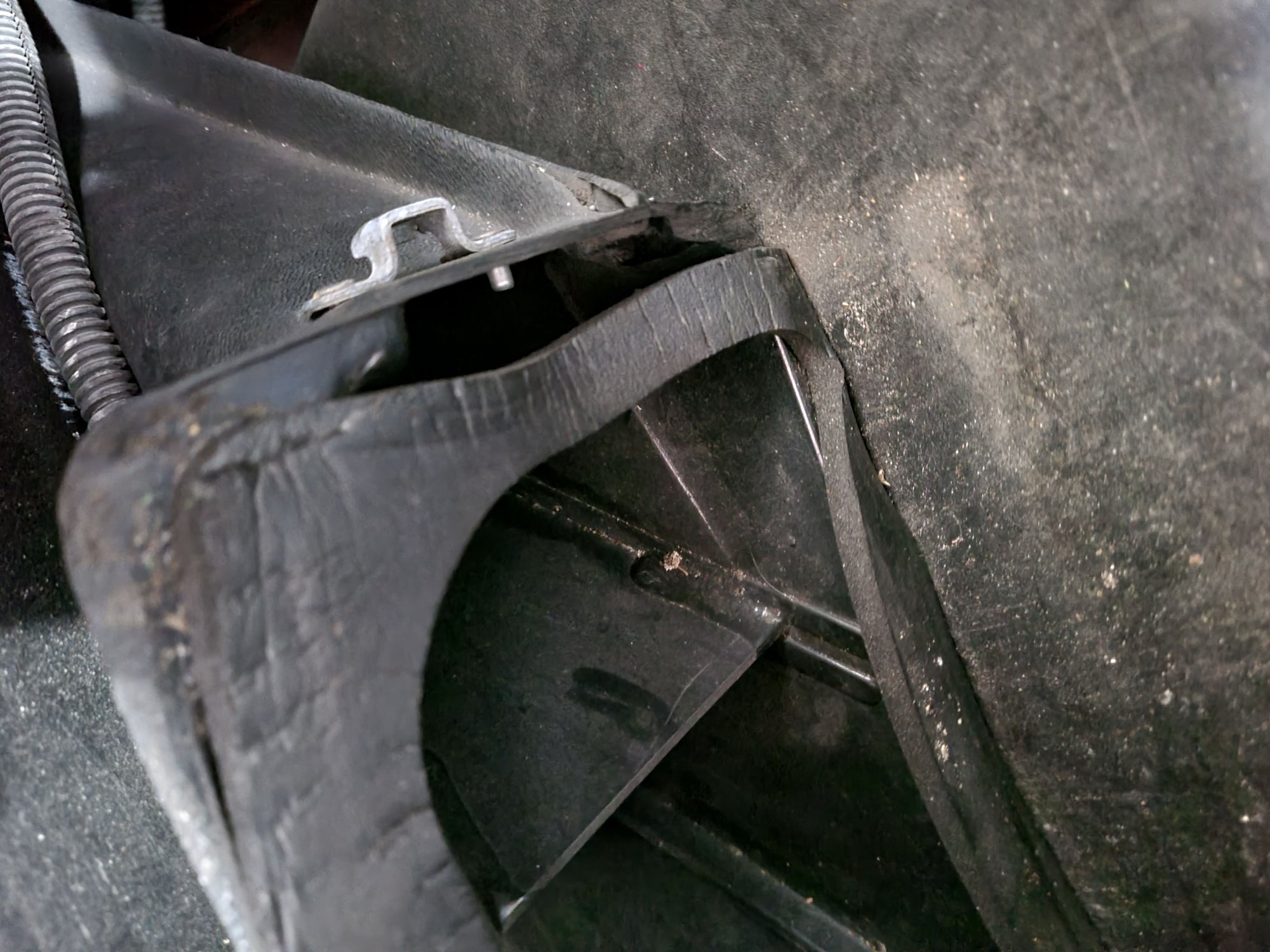

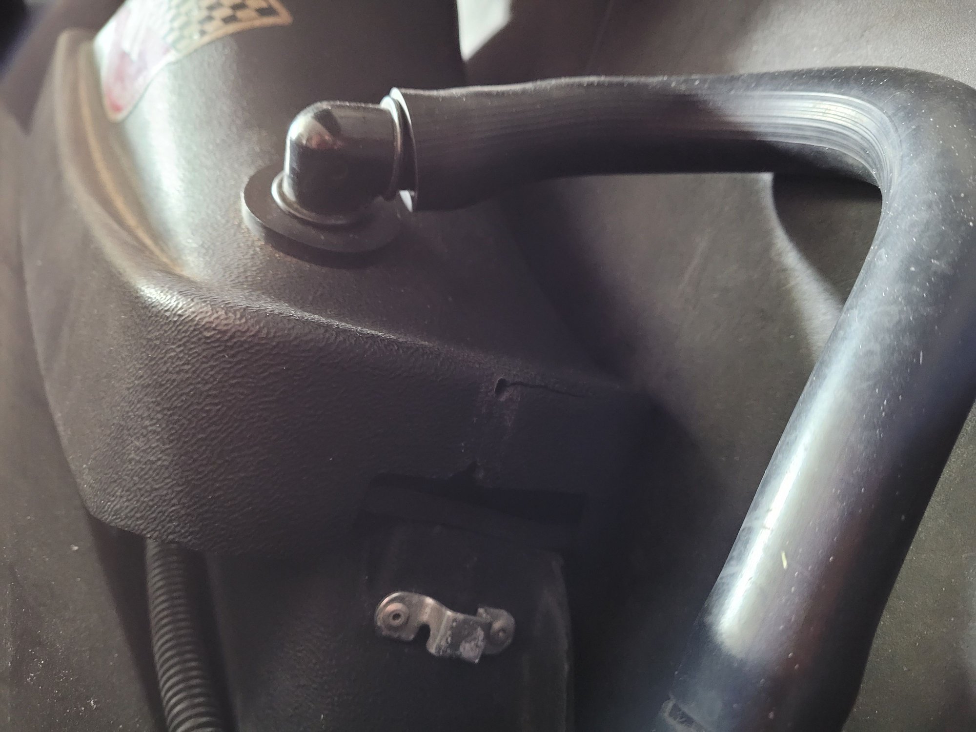

Ok. I took some pictures of current set up.
The gasket doesn't even have a surface to seat on ? How would I fix this?
Old Aug 26, 2021 | 03:10 PM
C5 Diag's Avatar
C5 Diag
Moderator, Tech Contributor
Posts: 15,595
Likes: 4,055
From: Cape Coral, Florida
No idea of what I’m looking at here but any seal, clamp etc downstream of the MAF has to be sealed…the air filter or any sealing surface upstream of the MAF sensor will not cause a P0171/P0174 !!

That is the square box that the intake filter sits on. I think I need a new housing?
Old Aug 26, 2021 | 03:18 PM
C5 Diag's Avatar
C5 Diag
Posts: 15,595
Likes: 4,055
A leaky air filter will not cause the lean code…it is upstream of the MAF…if you are still getting a lean code you need to look elsewhere !!

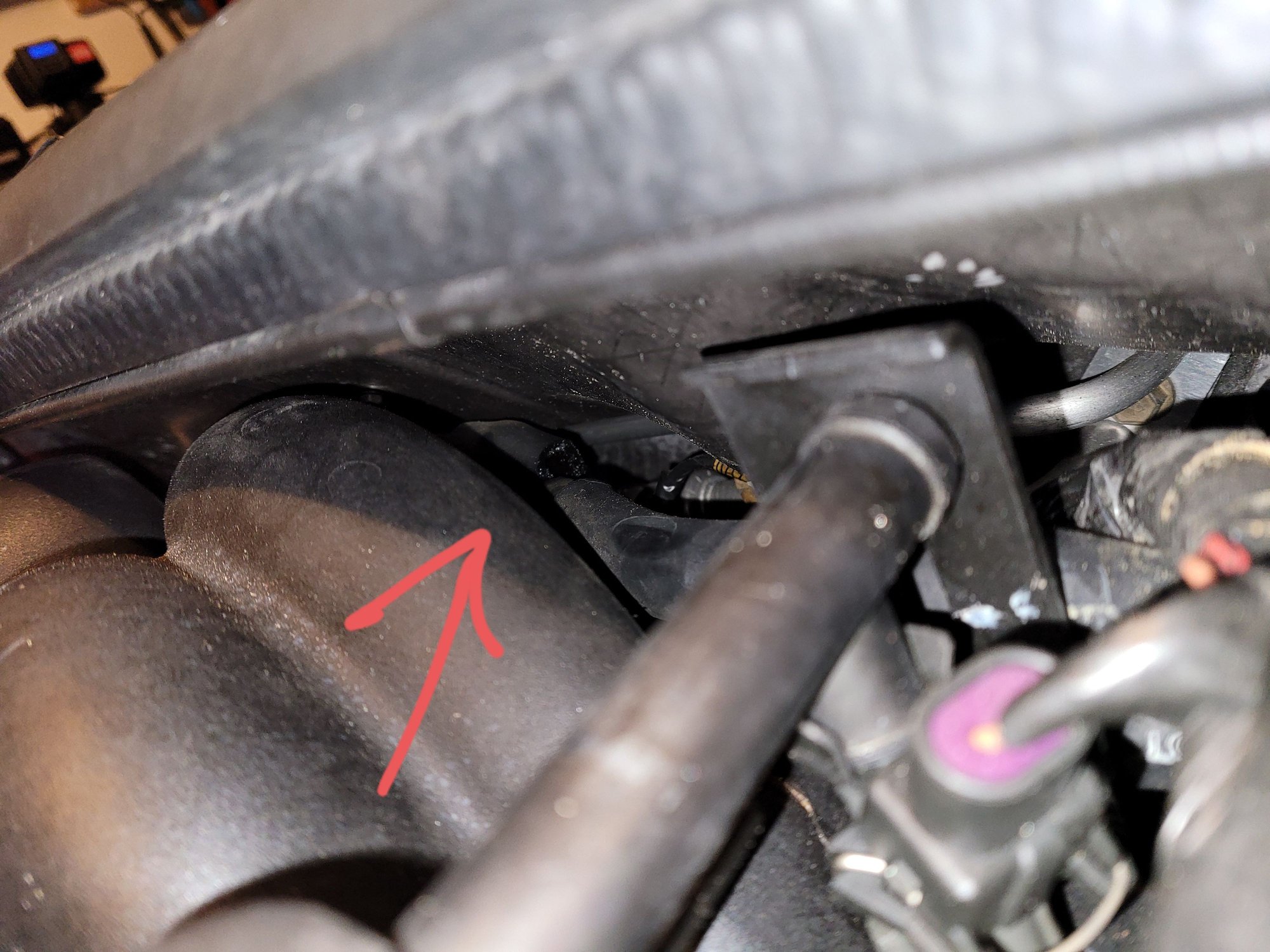

I found the problem. There is a break in this hose line. What is this hose that connects to both sides of engine.
Old Nov 20, 2021 | 09:22 AM
Stingroo's Avatar
Stingroo
Joined: Jan 2019
Posts: 4,308
Likes: 3,455
From: Somewhere, Florida
St. Jude Donor '20-'21-'22-'23-'24
That's your PCV hose. That would definitely cause smoke and an oil smell.

After reviewing this post, can you please post the model year of this car as there can be variances in troubleshooting fault codes by model year cars?
Regarding the OP post #6, that is a Varam Intake system and the airbox latch is broken off...details of this air intake system here VR-B2 (vararam.com)
As I too have this intake system, the Mass Airflow Sensor (MAF) installation is very specific in placement/orientation and could allow unmetered air into the intake if not properly installed.
Detailed install instructions here.pay attention to MAF installation steps 10 thru 14...
http://www.vararam.com/VR-B2_instructions.pdf
OP Latch broken off
