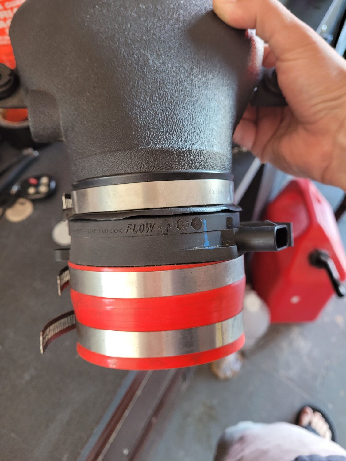

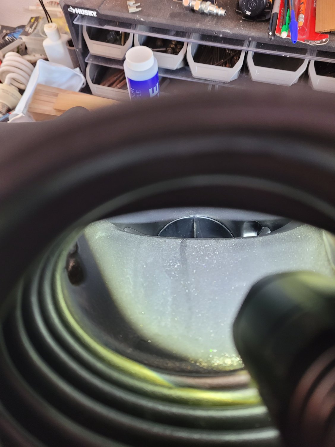

The picture of the MAF picture installation is confusing. Is that a picture of it looking inside the powerduct? I have the oem duct, If I look inside it just sets in and stops. It even has a alignment nook to attach the maf assembly to the duct. I dont see how this would cause it? I do need a new seal for the air box and one latch is broken, maybe random gusts of air come thru and trigger it? But that is before the maf? I dont know ha.

Here are a few threads for you to have a look at...

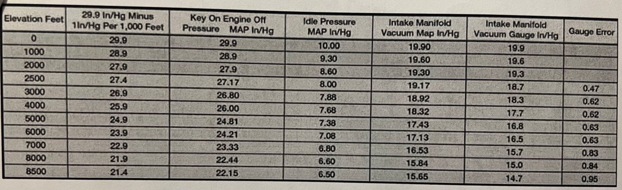

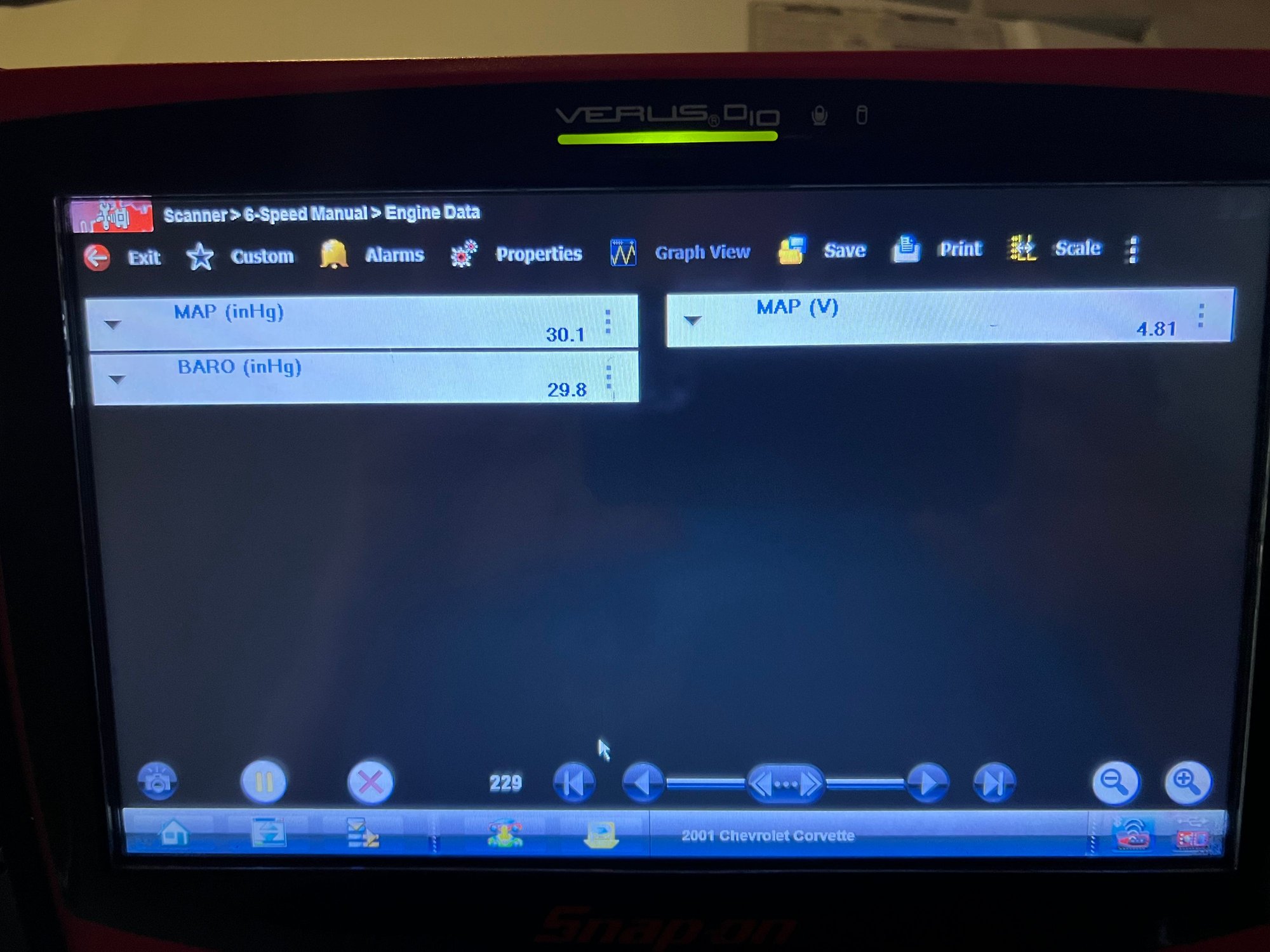

Im not sure why my MAP is 14in/hg. I am in Clearwater FL. Ill have to check MAP with engine off. What does this number mean?

Not a problem !!…OK, so you do have a P0171/0174….KOEO (Key On Engine Off) you should be close to my numbers in the pic below if you can read them on your scan tool and your upstream O2’s should oscillate from 200-800mv if you can see that…don’t know what “intake work” was done but that’s my first guess !!…if it was removed I’d recheck the torque on the bolts…your MAP will be high like that if you have a vacuum leak so that’s my opinion right now…like I said to diagnose a vacuum leak write down your long and short terms on both banks at idle…raise the RPM to 3000…if it’s a leak your short terms will quickly correct and go negative…your long terms will slowly decrease…if they don’t you have a BIG leak…a Forum member brought his car over here with the same issue and at 3000 RPM fuel trims didn’t budge…he had a pretty big hole in his PCV line and when we took the fuel rail cover off you could hear it…we went to the Zone and bought a short section of hose and then the sun came out and birds started singing !!…so do that and let us know !!…my friend Matt has a great YouTube channel and I’ll include the first of a 7 part series on lean codes…you’re about 135 miles north of me if you’d like to drive down here to have me look at your car !!

I ended up with same results with key on ignition off..not sure if scanner takes it.

Also the MAP was 10in/hg at idle 635rpm..

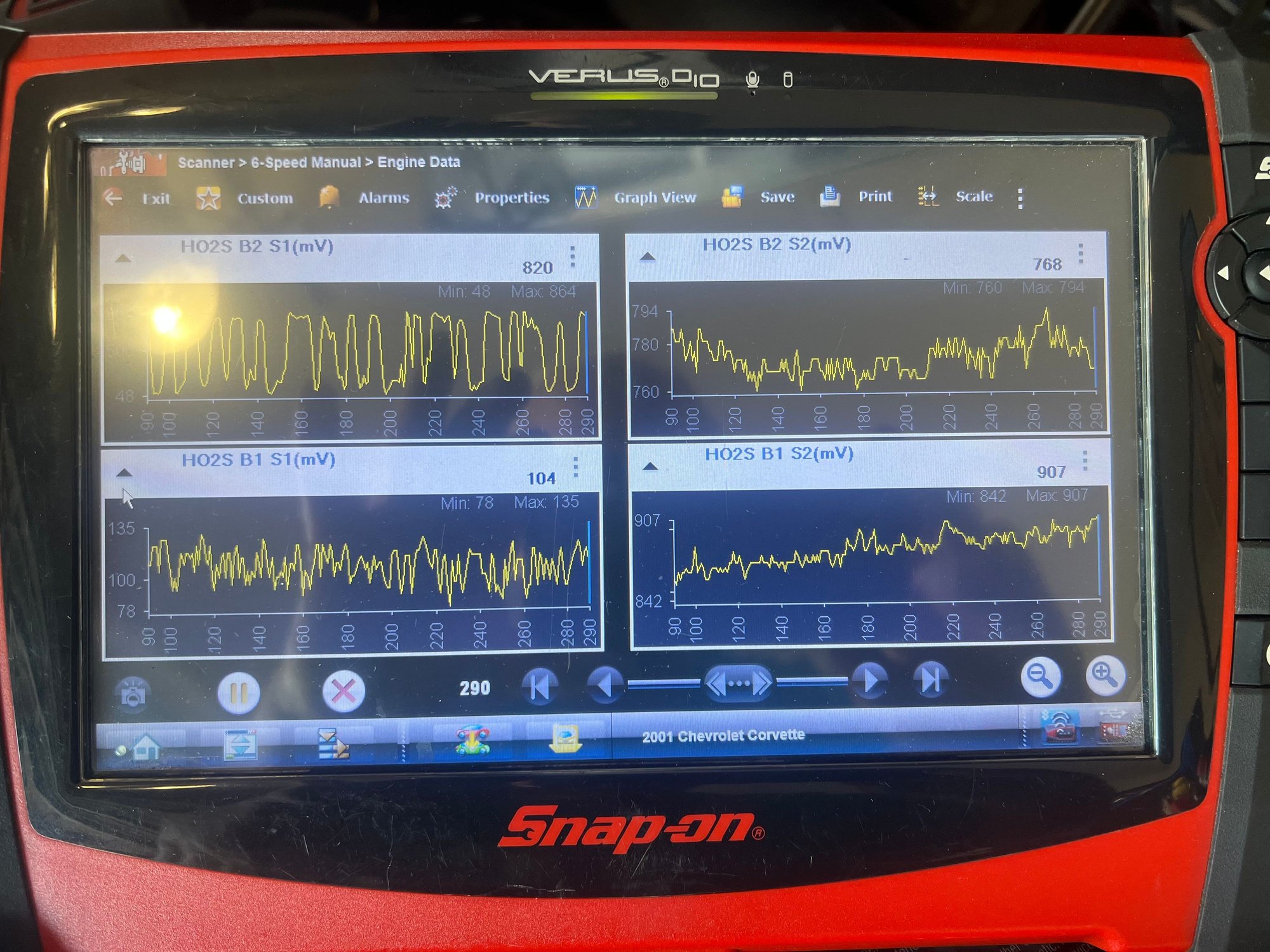

The O2 Sensors live data also showed:
B1 S1 / B2 S1 did fluctuate from .2v-.8v
B1 S2 / B2 S2 stayed at .6-.7V
Im not sure which is upstream or down.
Maybe I should come see you ha. I got burned twice on repairs. The first dealer did the intake manifold and oil pan gasket..the oil pan still leaks, maybe the intake does too. The second was a race shop. I brought it for a lean code and they said it was a missfire and the engine fan wasnt working. The wires were brittle so I did change them myself with plugs, but I diagnosed the fan and it worked. The next day the lean code came on and I called back and they said it would be another 150$ diagnose fee. Oh ya I found the pcv hose assembly snapped in half with electrical tape on the pcv valve...which prob made the car overheat when they were doing the high pressure fuel inj cleaning...pshh have to do everything yourself these days.

Old Jan 18, 2022 | 08:30 PM
C5 Diag's Avatar
C5 Diag
Moderator, Tech Contributor
Posts: 15,601
Likes: 4,060
From: Cape Coral, Florida
With the long terms decreasing it sounds like a vacuum leak !!…if you want to bring the car by that would be fine…I’ll put my smoke machine on the car and see where the vacuum leak is…let me know…also your O2 sensors are operating fine !!…sensor 1 are oscillating and sensor 2 are steady !!
