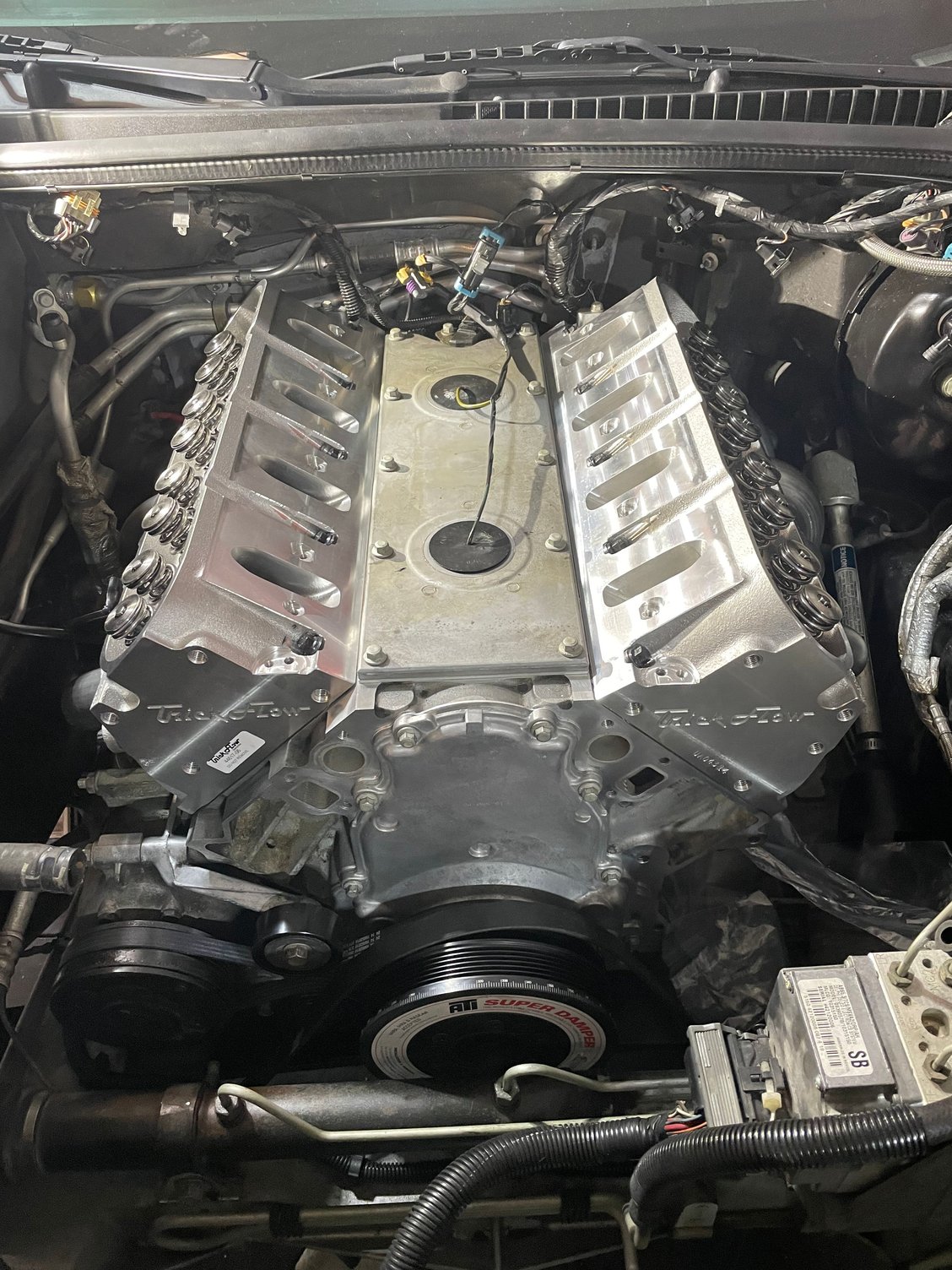

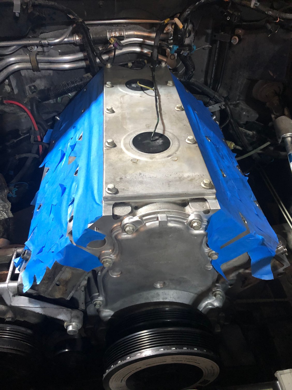

My 2 sons and I did everything in a weekend. That included balancer, headers, cam, timing chain, oil pump, intake manifold, throttle body, valve springs, x-pipe, and cat-back system. Had to go to Ace Hardware for some wooden dowel to hold up the lifters. Also had to get a valve spring compressor that would work without removing the heads, but other than that, no 'special' tools were required. The parts, fluids, pizza, and beer was the most expensive things.
