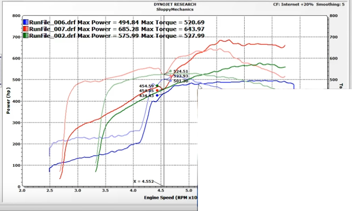

Interesting comment about the 5.3. In cubes, most round it to a modern 327. Coincidentally, a LOT of older guys will tell you the 327 was the best SBC ever built, too.
The closer you get to pure drag racing, power is important, not displacement.
I like to ask this question:
"How much power can a 122 cubic inch engine make with a 1000hp turbo?"
A: 1000hp
Now,
"How much power can a 500 cubic inch engine make with a 1000hp turbo?"
A: 1000hp
Thus, when power output climbs and holds quickly (as with drag racing, high stall converters, the RPM is up with power) The displacement of an engine is meaningless quantity with no sway over the outcome besides the simple fact that larger, heavier engines tend to contain more rotating mass and inefficiencies which robs extra power due to friction and energy investments. In other words, the lightest, smallest engine internals with the most power output is ideal.
So what is engine displacement good for then? Why even use a V8 when Inline 6 cylinder such as 2jz-gte can supply 800rwhp easily?
Torque at low RPM is considered "fun" and can easily spin the tires and accelerate quickly for "fun" (no competition) when riding around city streets, where the engine isn't sitting on a max power high RPM all the time like in professional drag racing.
In other words the large displacement cars aren't strictly drag cars, they are daily drivers, street cars with a broad torque curve that means you don't have to stress the engine to such a high RPM in order for the vehicle to respond and feel fast, for the purpose of fun.
With the right size turbo or other forced induction you can further tailor the torque curve to be broad instead of focus on drag racing, even with a small displacement.
For example with any positive displacement blower you can easily have big block'esc torque early as 3000rpm with very small displacement, as 4.8L, lets see...
That curve is from a 4.8L Engine with a blower and stock engine internals, perhaps 200,000 miles, Look up "sloppy mechanics 4.8 G35" for more examples
