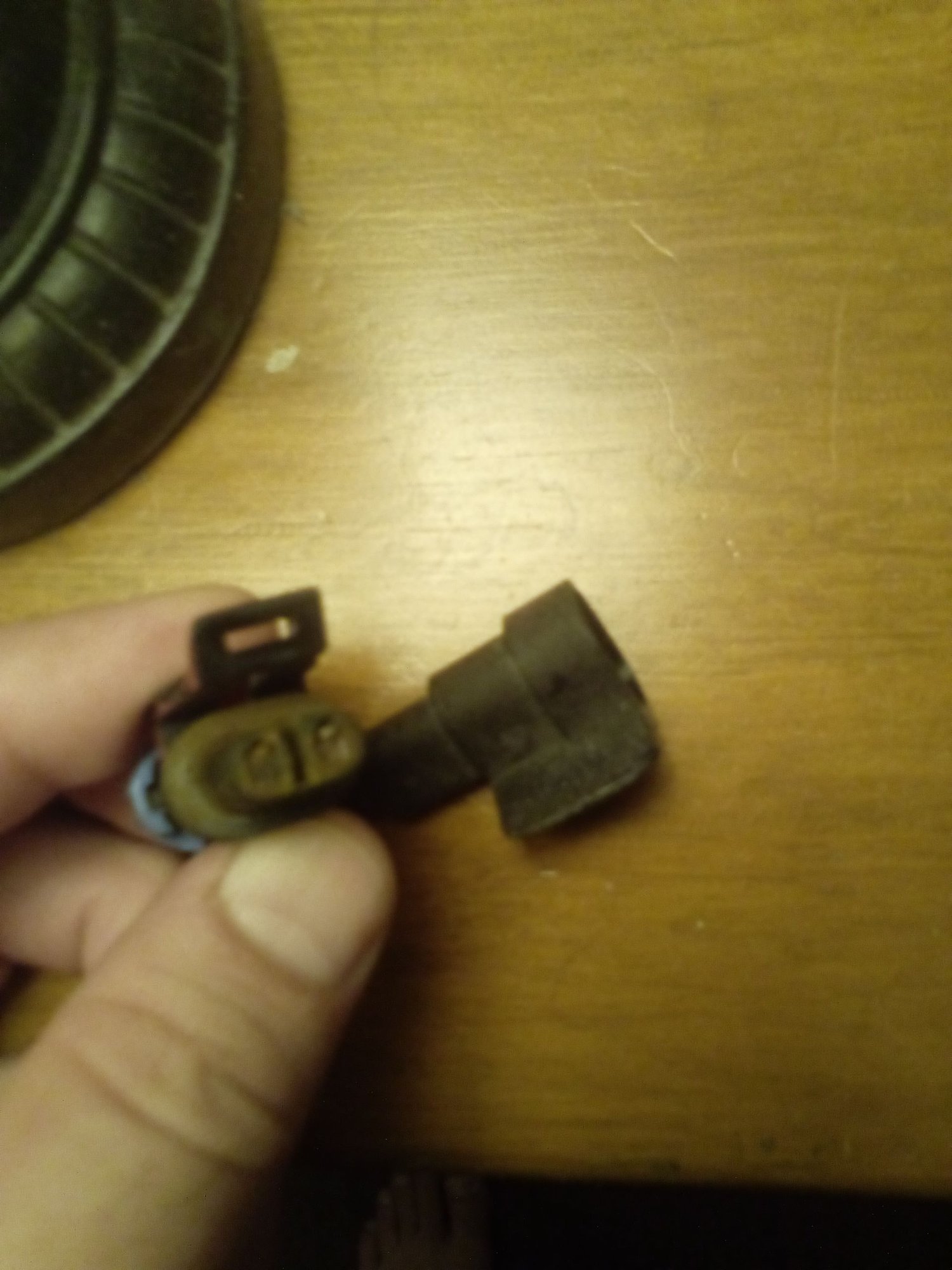

Well picked up the new sensor from autozone but the original pigtail had both prongs from the old sensor broke off. I had used a pigtail off a 2008 junkyard saab i had laying around for the ambient temp sensor the pigtail was the same. Haven't driven it yet to see if it works but hopefully does the trick. The wiring does feel old and brittle so hopefully nothing wrong with the wiring up in the harness. It should reset after a few miles if all is well according to the other thread link posted above?

Great took it for a ride started reading instantly ext 64 degrees as my phone does and 60 ext at 8pm as my phone had predicted.
