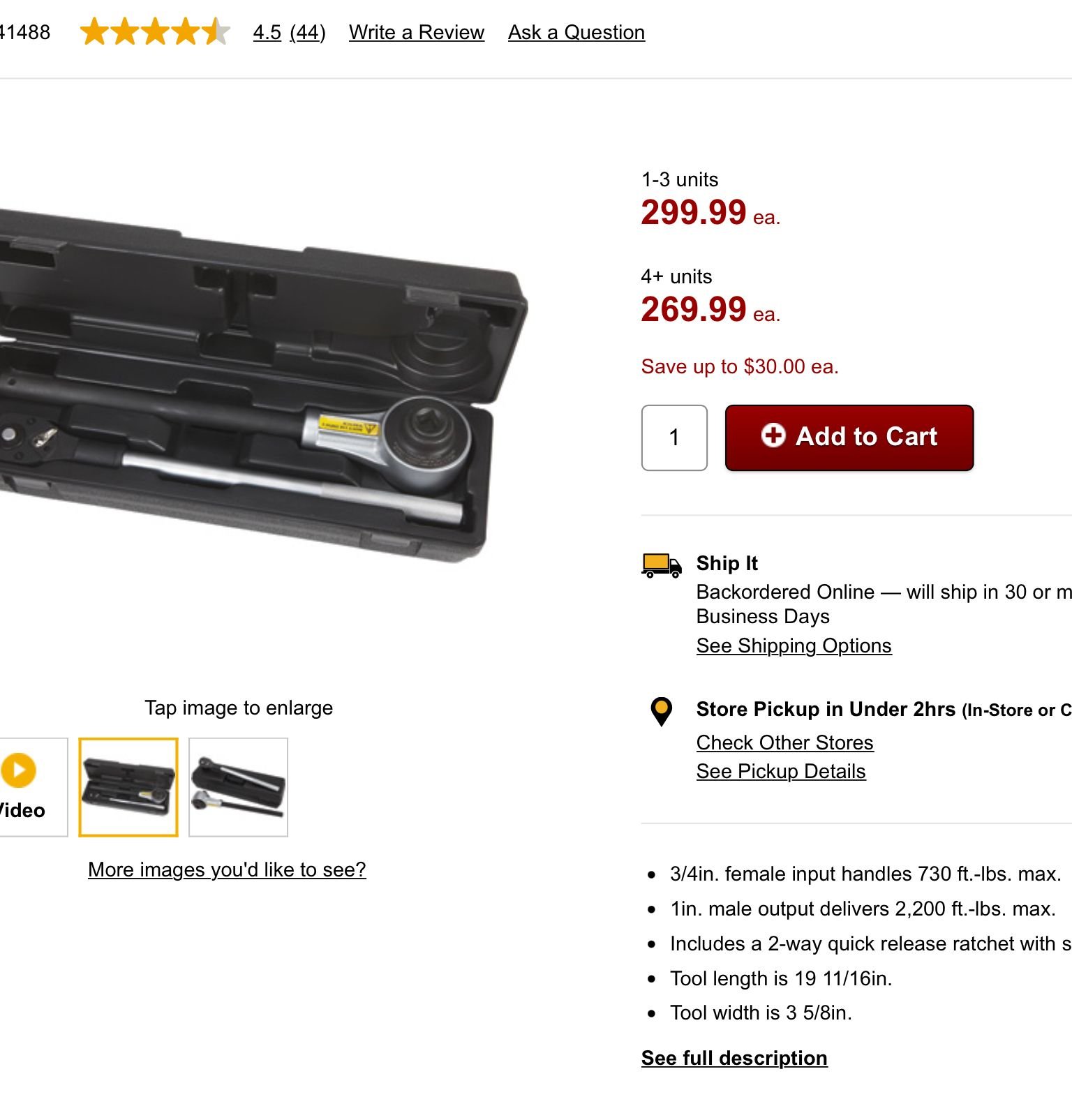

Originally Posted by Gordy M
I have done several, myself and some friends. The more you have worked on the easier it is. My last one took about 4 hours and by then I knew what I should be doing and my helper should be doing. Along the way I found an 30 to one reducer tool from HF that was used on truck times. I wedged that into the frame (took some doing) and the balance and used a 1/2 wrench to remove the bolt and put the new bolt on the last car was for an SCCA autocrosser so we had to use the Stock HB, so we torqued it to 37 ft-lb and then used an angle guage to the 240 degree. Took turns turning the bolt--takes forever--but was easy to do. Unfortunately I did not take pictures of the 30-to-1 tool I had wedged in.
I know this s an older thread, but some may still be subscribed
I did not find a 30-1 multiplier, but did find a 3-1. Perhaps that’s what you had…
https://www.northerntool.com/shop/to...3947_200623947
