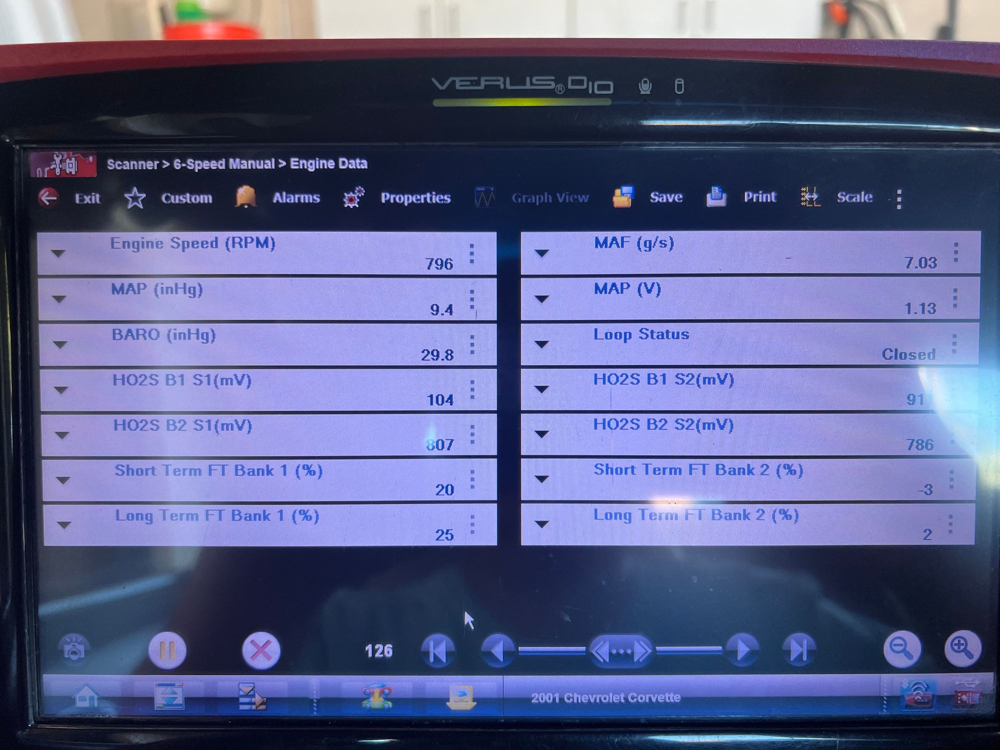

Yes, if the car still stalls with the MAF disconnected it’s not the MAF…a PID (Parameter Identification) are each separate item in live data you are viewing…below are 14 data PIDS on my scan tool at idle…my long term fuel trims maxed out on bank 1 when I had a faulty O2 sensor…bank 1 O2 sensor stuck low at 100mV.

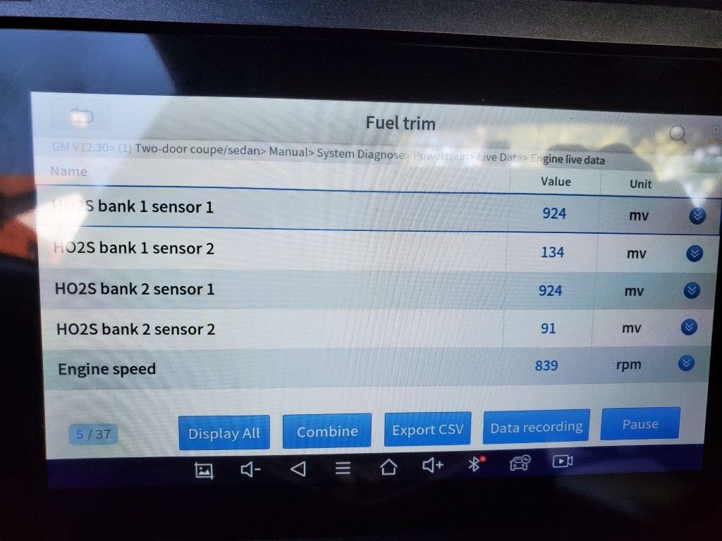

Idle before stall:
Idle after stall:
Idle after turning off the car with the switch after stall:
after tests, turned off:
Old Aug 6, 2022 | 09:48 AM
C5 Diag's Avatar
C5 Diag
Moderator, Tech Contributor
Posts: 15,565
Likes: 4,034
From: Cape Coral, Florida
Originally Posted by biker_il
Idle before stall:
Idle after stall:

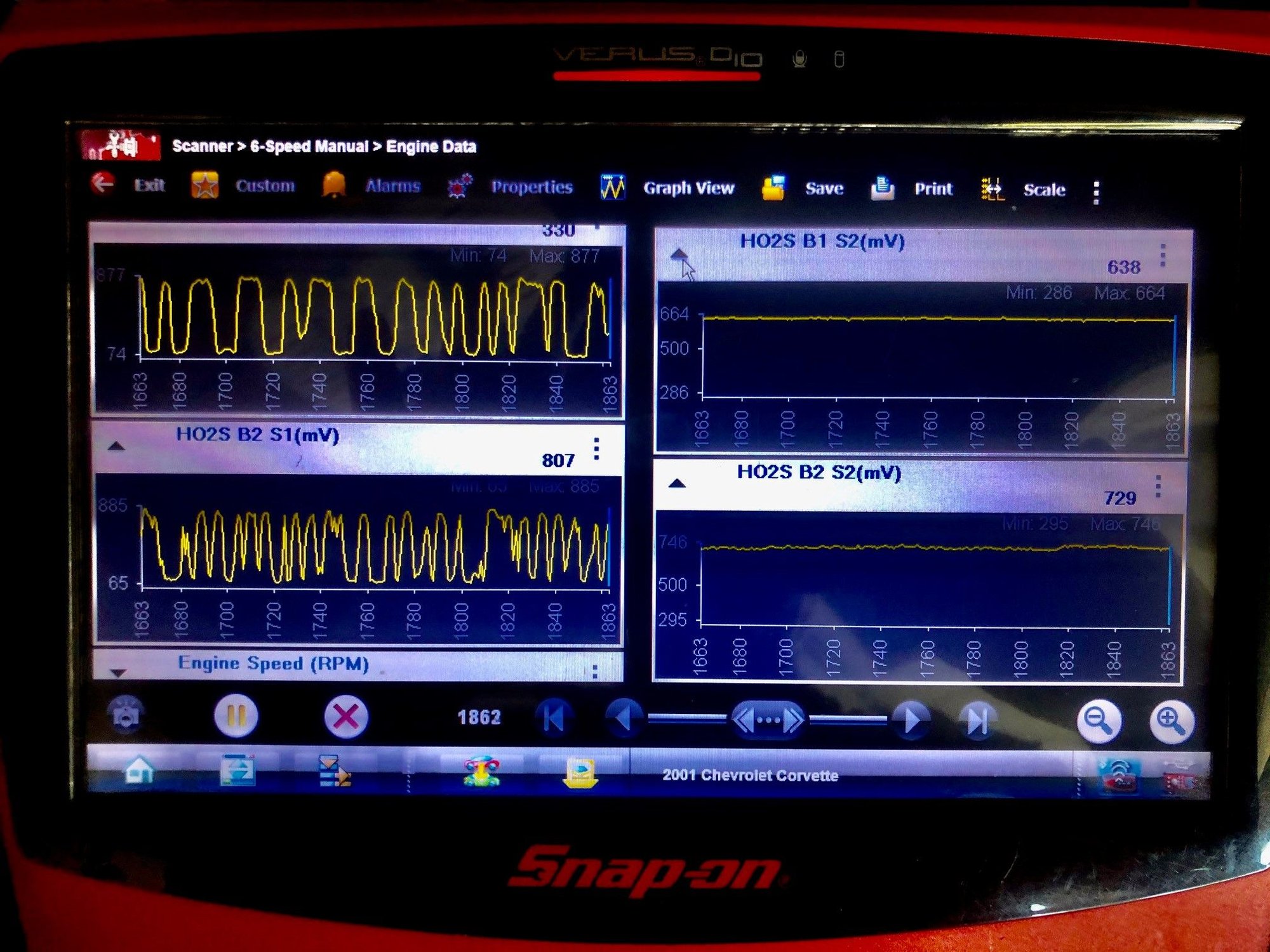

Looking at the O2 sensors in all of your screen captures tells me nothing unfortunately...the Sensor 1 O2's oscillate normally between 200-800mV and that screenshot only captures that point in time...you need to GRAPH the O2 sensors and post that.
all on idle

Looks like your Bank 1 Sensor 1 is stuck RICH if that is what you are seeing at idle at normal operating temperature...if the upstream sensor is rich (above 450mV) then the downstream sensor should also be rich…this might be an actual rich condition...try disconnecting either the brake booster hose a bit or the PCV line going to the intake manifold...we are creating a lean condition so see if that B1S1 goes way lean while graphing the upstream O2...if the O2 stays rich it may be a faulty O2 sensor...this is opposite of what I had...my exhaust stunk because the PCM was scheduling too much fuel to the injectors...your PCM is removing fuel so the car will fall flat on its face...your stall possibly.
Looks like your Bank 1 Sensor 1 is stuck RICH if that is what you are seeing at idle at normal operating temperature...if the upstream sensor is rich (above 450mV) then the downstream sensor should also be rich...your downstream on Bank 1 is looking rich so this might be an actual rich condition...try disconnecting either the brake booster hose a bit or the PCV line going to the intake manifold...we are creating a lean condition so see if that B1S1 goes way lean while graphing the upstream O2...if the O2 stays rich it may be a faulty O2 sensor...this is opposite of what I had...my exhaust stunk because the PCM was scheduling too much fuel to the injectors...your PCM is removing fuel so the car will fall flat on its face...your stall possibly.
in this photo you can see when I disconnected the brake booster hose:
and here it`s idling after the hose is back on:
1. The engine reved a bit for a second or two when I pulled the hose.
2. Maybe the temp went up and it started responding ok.

The O2 sensor responded to a lean condition so it looks like the sensor is OK…now it looks like the O2 is working OK…what happens if you let it idle for a while ??…does it go rich again ???
