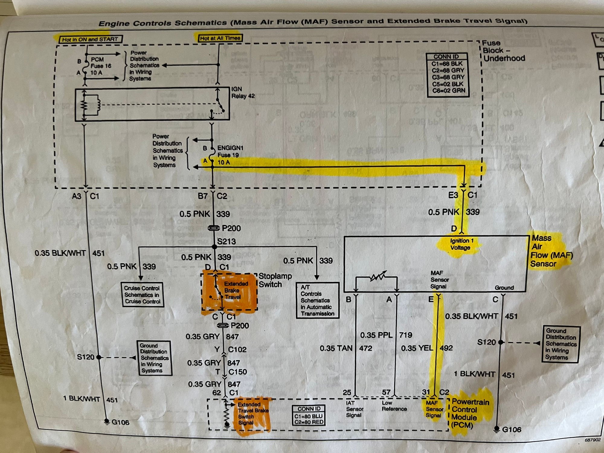

meanwhile I managed to screw something else.. my MAF is not responding, shows 1.4g/s and pink wire when switch on, shows no voltage, yellow shows 5v
like you mentioned here https://www.corvetteforum.com/forums...post1604761844.
is there a fuse or common ground to the MAF? or any idea?

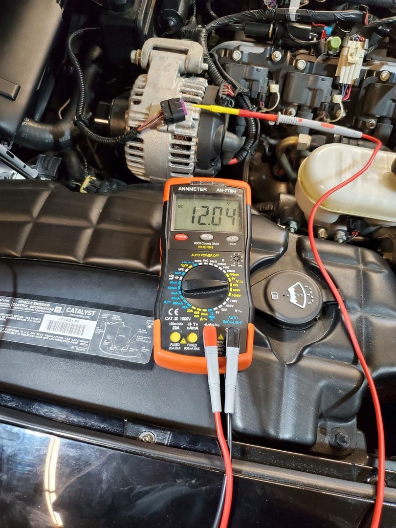

With key on or in start you should see 12 volts at fuse 19…do you ??…the ground G106 is above starter…I believe your 03 should be the same as mine…take a 12 volt test light connected to battery POSITIVE…touch tip to the MAF black/white ground wire…the light should light if ground is OK.

Fuse is good (I see 12v) and ground is good...
Does the pink wire runs straight from the maf to the fuse?

No, the wire runs from the fusebox to the MAF sensor…do you know how to read these wiring diagrams ??…I doubt you have a piercing probe but try piercing the wire with a needle or similar a few inches back from the connector and see if you read 12 volts…you may have a bad connection right at the MAF…if still no good you will need to find the underhood fuse box pin E3 and check there.HOW did you screw up the sensor ??

I did pierce it about 5 inches back on the braid and nothing....
I guess I should trace it to pin E3 and maybe even rerun a new wire....damn..

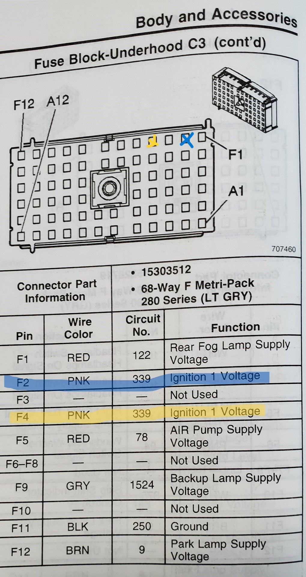

I can`t find how to disconnect c3 plug from the fuse block, i guessing with a screw through the metal thread
Don’t know how far you’ve gotten but this video may help !!

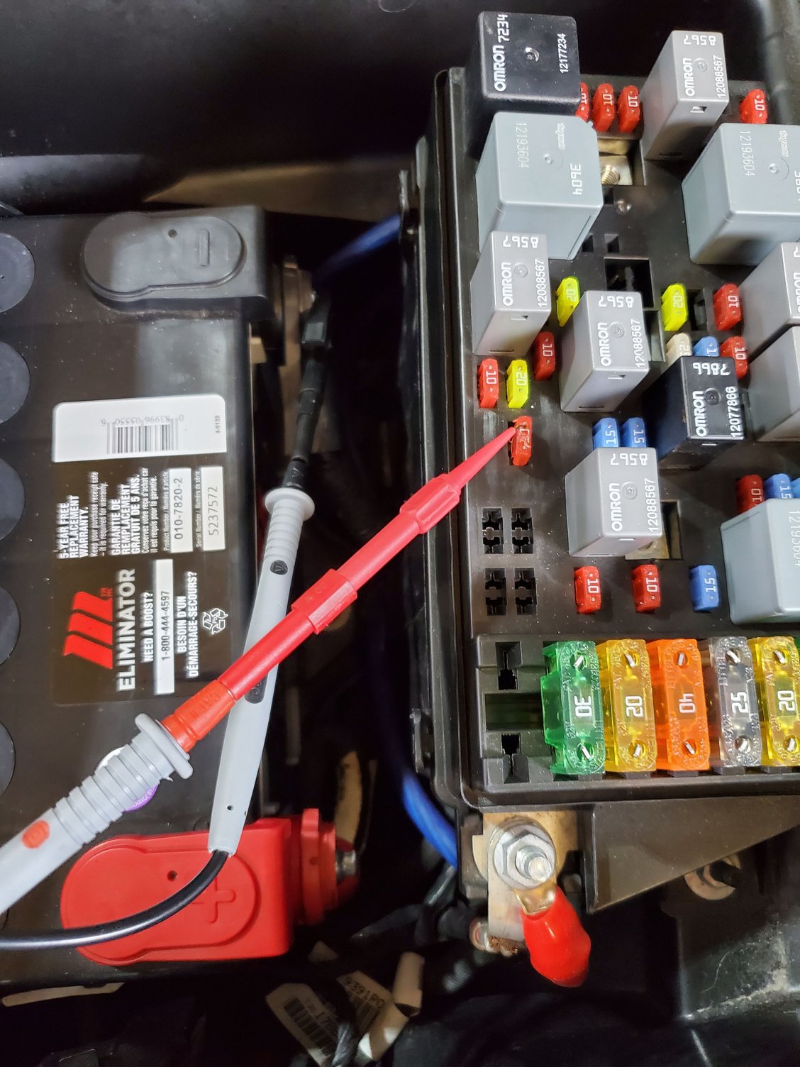

Traced the pink with a sounder all the way to the fuse block connector and it was good but the fuse didn't make a sound so I figured it was the fuse holder.....and it was spread...

How did this happen ??…you said in post 66 that the fuse was good…I assuming you didn’t check that fuse with your DVOM or test light ??…even though the fuse was not blown you still have to check power.
I guess the fuse leg that goes to the MAF was loose so i got power on both legs and tested the fuse too that was not burned
