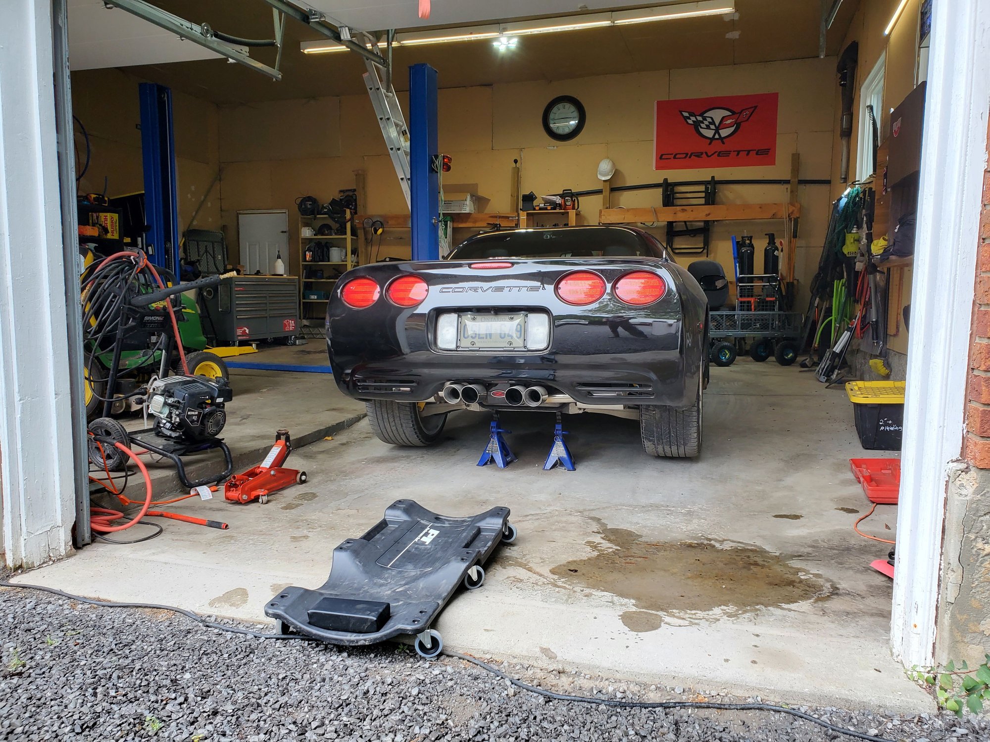

I`m Back!
Got her on jacks and it wont stall... so only on load

Well it sounds like something electrical…if it’s fine when it’s warmed maybe an electrical connector is making better contact (expands when heated)…it may be a crank sensor or it’s connection or maybe the fuse box…I would scope a few things to see what’s dropping out…if this all happened after replacing the ignition switch I’d readdress that…I’d pull the switch and inspect all the contacts…the circuit that supplies power to the PCM (where the crank sensor gets its power) may be dropping out when it stalls…if you can monitor the fuse voltage somehow either at the PCM (back probing the wire) or at the fuse (if you have some very thin copper wire you can wrap it around the blade and reinstall the fuse)…you can try PCM fuse 16 because that circuit is always powered with the ignition key in ON or START.
