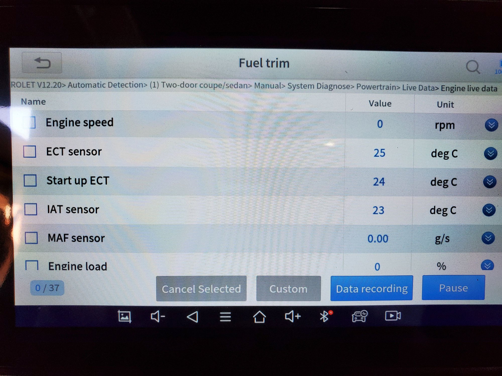

the scan tool recognize that the car is a 2003 Chevrolet corvette but asks for body style and transmission type. (attached screenshot)
i don`t think there is an option for generic/global, it either recognize the car automatically or you have to enter it manually.

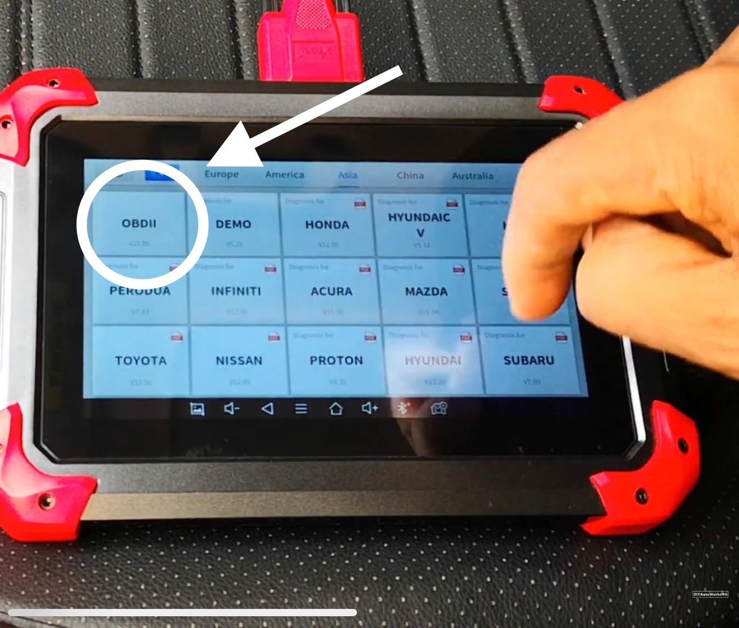

This is your generic/global OBD2 tab !!

So it’s not an ECT issue but look at the ECT with Global OBD2 (tab above)…you probably never gone into it.
