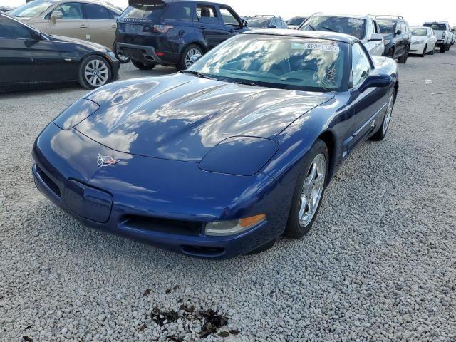

I just bought a 2004 Commemorative coupe, that was in a flood. The fuse box in the floor was under water and has dirt and sand in it. I think I need to replace it. I have one from a 1999. This is what does not work: Turn the key to start and I get nothing, no click or no indication it wants to start. Windows don't move, radio and HVAC do not light up. DIC says "NO COMM". SO I thought that I would start with this Floor fuse box to start with. Mileage is 41,000. Or should I replace the BCM?

Sorry to hear your car was in a flood…I’d replace the car so call your insurer…the car does not have an IP68 rating as many electrical devices such as call phones have…not only is your fusebox and BCM compromised (also PCM and TAC module) but even “IF” you can get the car started again you WILL have other issues down the road as far as wiring and any sensors and connectors are concerned that were submerged…too many to name…you will have many more COMM codes to follow !!

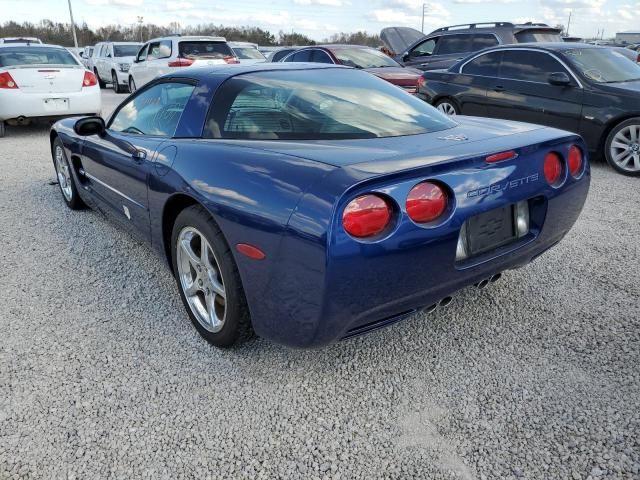

Does anyone want to buy this car? I have $8100 in it? The water line was low.
This is the water line that was on the car when I purchased it.
Water line on the car when I purchased it.

Ed, if you are interested in keeping the car, your best bet is to find a 04 base model on COPARTS and buy it with the consideration that the car was either rear ended or side impact. You can swap harnesses, ECMs, BMC, etc... and electrical components and it should be all bolt in and plug in. At least you will have un molested electrical components from which to trouble shoot from. The 04 doner should have some of the other miscellaneous parts you need.
Still a major project but way better than trying to clean each (each) connection and chase down circuit boards. Hard but doable.
