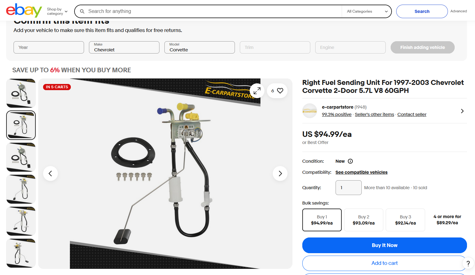

I see a right side on fleebay there is people selling the right side with yellow wire. There is no mention of who makes the dang thing. Has anyone tried one of these?
https://www.ebay.com/itm/297346482439

Yaa, i bought the same one about ten yrs as a backup. My pass side went out, so i gambled and i thought i came out ahead since i bought 25 new. when i went to install it i noticed the wires were diff colors, OEM is grey and blue. I said *** it i didnt want to do this again so i put the dust back on it and bought a OEM used one for 10bucks this is yrs later and still works. Ill only ues that one if all else fall to fine an OEM unit.. Didn't want to take the chance and the quality didn't look good as OEM. Didnt care if the ohms was in spec.

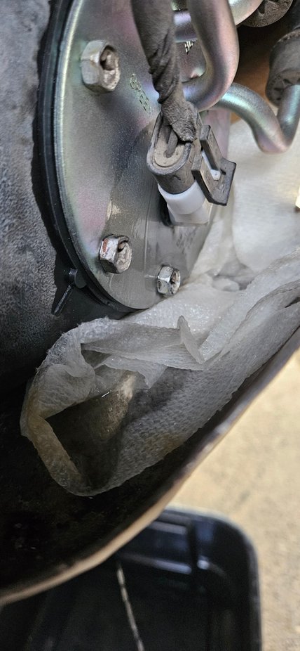

I replaced the right side sending unit with new Carter brand and had the same issue 7/8 and goes to zero on the gauge and triggers low fuel light on the dash. I do not remember if i cleared the P1431 code after changing the right side sending unit. Would that in itself cause the same issue of 7/8 dropping to zero again?
Installed new RA Delphi brand pump assembly (with new sending unit). Bought a "low mileage" used right side sending unit from ebay. After install, the Delphi leaked at the electrical connection, so I installed a new GM 10333749 sending unit on my original left side pump assy. After all of that I cannot fill the tanks now.
I have the FSM and I'm wondering which scan tool I need to operate the fuel pump to diagnose WTF is going on with the car. Pretty sick of sucking gasoline fumes in the driveway...
Edit: I wish I could have just went to RA or the dealer and buy that right side sending unit and/or a left side pump assembly.
New Delphi pump assy leaking at Electrical bulkhead. Very noisy btw

Though you do have an uncommon leak, I'd try to find exactly where the leak originates. Possibly try sealing all the bolt heads. If it is actually coming thru the electrical plug itself, it's probably junk. But if you can gain access on the backside of the connector, you may be able to somehow smear enough fiberglass resin around it to seal the connector against leakage, and fiberglass resin will be impervious to gasoline. If not, try Vettenuts or C&S. Hope this helps......
