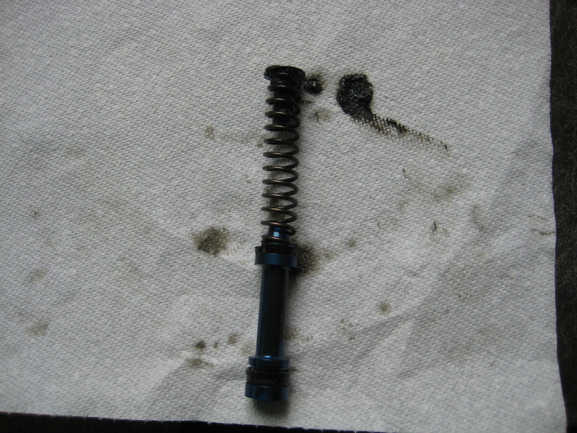

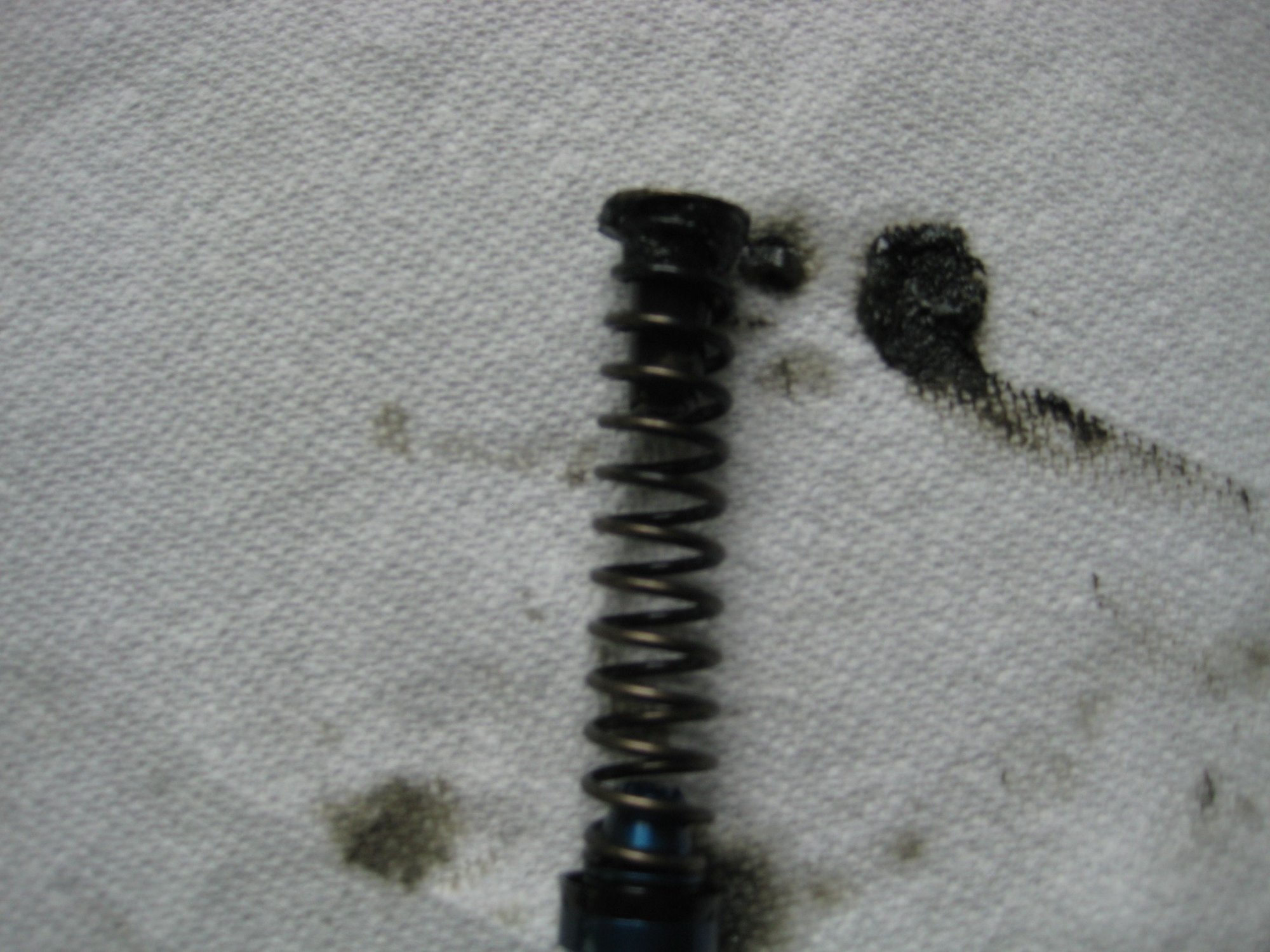

Although I cannot find my pictures of the brake master, here is the clutch master apart. This is from the '04 I bought with 5436 miles in Nov. '19. This is some of the dirt, rest was in the master. This is a known issue. Some cars do better than others. Climate probably makes a difference. I have seen it go both ways. Looking at the pictures of for sale cars on the forum, I have seen more of them with dark brake master reservoirs. The cap is vented to atmosphere, just like all the running gear.
