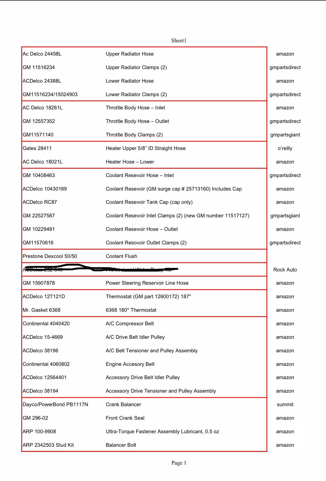

If you’re doing stuff while you’re in there, here’s the list I used.
The true GM OEM water pump is ACDelco # 12681185. They are not getting any cheaper, and are back ordered on Summit. Available on some GM sights, but cost more.

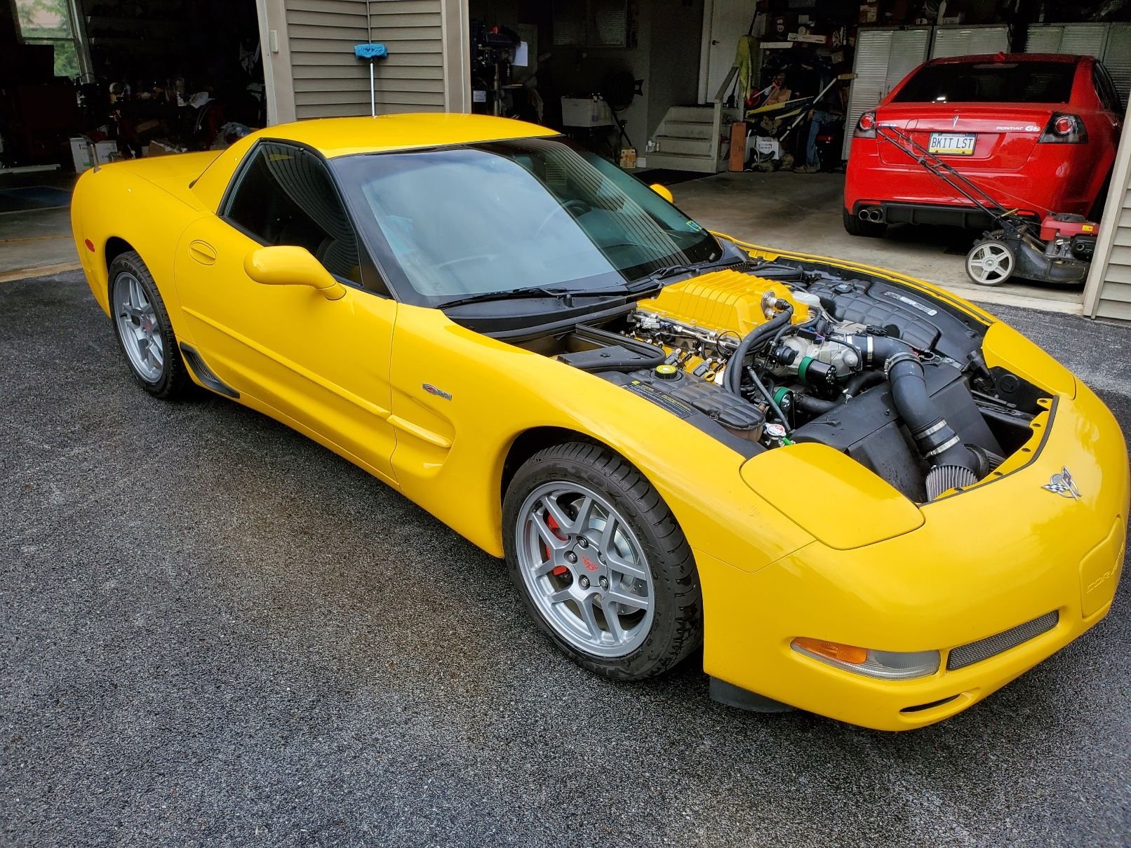

I did NOT want to remove the Rack - So I did mine by lowering the cradle / lifting the engine. I did a LOT of other stuff 'while in there'... Heads, Cam, Guts, Pump & Seals, 3/8 shorter Engine Mounts (The are not motor mounts - motors are electric), Radiator, Headers, New, pinned Balancer, LSA, Intercooler & Plumbing, etc. For me, it was the best way - I also have a lift.
YMMV.

Your car looks amazing, btw.
Which coils and valve covers did you choose?
