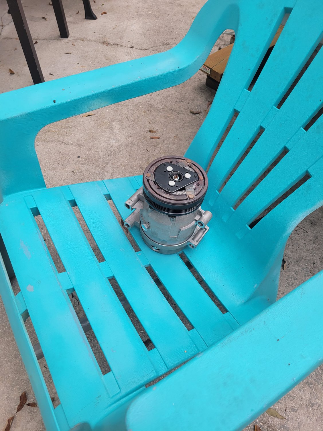

reads about 85 high and low side. My ac compressor makes a loud light grinding noise when the ac is turned on. I recently replaced it so its brand new.

A brand new compressor will be hard to turn by hand but it will turn. One that has run for some miles should turn relatively easily by hand. It sounds like your compressor has seized if you cannot turn the clutch by hand. If it is, in fact seized, that may explain the scraping noise you hear when you turn on the a/c. Does the paint on the clutch look like it has burned off? When a V7 compressor seizes, it either breaks internally sufficiently to rattle around broken parts or it locks and causes the clutch to slip until it overheats and lets go.
You describe a noise only when engaging the a/c but say the clutch does not rotate so my guess is you have a seized compressor.

I am trying to spin the clutch by hand it is in deed stuck. This is a brand new compressor used for only about a month.

You will find a good AC Delco A/C Service document here:
https://www.corvetteforum.com/forums...post1607386295
It does have a chart about oil balance. From what you described, you did not account for the oil removed from your system when you replaced a few components along with the compressor. Depending on how much trash you find when you pull your orifice tube, you will want to replace the accumulator dehydrator along with the compressor at a minimum. If you find debris then you need to decide about replacing the condenser or flushing it and flushing the evaporator and lines. You may also get a feel for debris by draining the oil from the compressor ports and the compressor crankcase and looking at it and straining it through something like a coffee filter.
If you do flush, at least you will have a zero oil baseline. Then you can add a full 9 ounce oil charge.
The AC Delco guideline also describes use of a suction screen and a filter in the liquid line to protect the new compressor. Lately I have been advocating use of the suction screen in compressor replacement related threads because the screen will reduce the amount and size of trash that can enter your new compressor. Suction screen kits very similar to the AC Delco kit described in the guidance are available on Amazon for about $20. The AC Delco kit is no longer made but there are sellers on ebay that have NOS.
