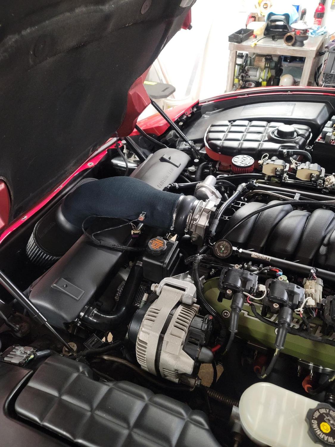

Long story short I have a dyno appointment on Tuesday the 16th. When I drove my car on the trailer I swapped out my new Halltech Killer Bee intake. However, I'm having fitment issues like crazy.
Is there any way that I'm doing this incorrectly? I've already started from the filter to the TB and vise versa. I cut a notch out of the coupler where the new MAF is located trying to get it to push up to the TB to help with clearance issues. My hood is hitting the intake so bad its pushing it up and looks terrible not to mention the stress on the fiberglass. The filter seems too big/bridge could be too long but I could be wrong. I really want this intake to work but so far I'm hardly impressed especially with the price tag it carries. If anybody has any tips or trick I would GREATLY appreciate it. Attached are a few photos to show what I'm dealing with.
Again, all help is appreciated and thank you in advance.

What is keeping the tube from sticking up? Is the bottom of it hitting something?
You could also try to trim the tube itself to move it toward the TB if that helps.

Isn't that the Halltech conversion intake, to use with a 102 mm throttle body? It looks like that the transition hose is the wrong length.

The tube is seemingly not positioned towards the TB enough to allow for the bend to transition over the radiator in the correct spot, that's why I cut a notch out of the coupler to allow it to be pushed more towards the TB but it isn't enough. With that being said I also mocked it up without the coupler and its very, very close but almost impossible.
I don't want to trim the tube just yet seeing how its almost a $700 system but it looks like what it needs.

According to their website they have 2 Killer Bee kits. I'm sure you ordered the correct one but are you sure you received the correct one? I can't tell from the description on the website what the difference is between the two. I think they are located in Canada so doubtful they are closed for MLK, Jr. Day, I'd call them. Let us know what the outcome is, I'm curious to know. Good Luck!

Looks backwards

I've flipped it every way possible and also the filter. The way it's shown is the closest it will get.

Mine looks similar but my hood closes better. The response I got from Halltech was that some trimming of the tube may be needed...

My next step would be to trim the rubber coupler even more. Cut it all the way around at the edge where you notched it for that MAF.
The coupler is doing no benefit for you extending past the outer most hose clamp. That extra material may be binding up on the MAF sensor and being stiffer than you want the coupler to be.
It's also a very short area to have a couple bend how you want it so it may be tricky. Plus couplers are cheap.

You visually checked and confirmed it's on stock motor mounts? On the radiator side, might be worth double checking to make sure it's completely seated in the bottom mounts and top mounts are installed right/flush etc. Kind of a stretch, but that's all I can really think of here. I noticed my intake fitment being off a tiny bit after milling the heads and lowering the intake/TB slightly, but nothing way out of alignment like this.

I did. I also went out in this freezing weather to triple check and make sure the radiator/condenser are in the correct locations (in the correct spots in the tabs on the bottom and the slots on the sides). I understand heads being milled changes the geometry but what are we talking 20 thou? Is something so small going to determine if we all can use a cold air intake or not? haha
Something worth noting is when I pulled the coupling off and fit it in what seemed to be the correct location it was almost butted up against the TB completely and also had a pretty good angle going upwards.

I mean in a pinch like this, get the filter/tube assembled, lay it on the radiator where you need it to be then duct tape the tube to the TB...make your own coupler just for the dyno run lol. Use enough tape to be "rigid" and not collapse during a pull.
Then when you have more time, trim the coupler to work.

When the time comes, assemble the tube/filter and "install it" without the coupler. Then you can see the angles/distances you are dealing with. Proceed accordingly with coupler trimming.

Yeah I've tried that but what I'm seeing that needs to be done is trim the coupler and tube. I really appreciate your advice.

Mine sits like money, but I am using a sliver blade. it does make contact with the hood insulation. Might want to try the hump hose.
