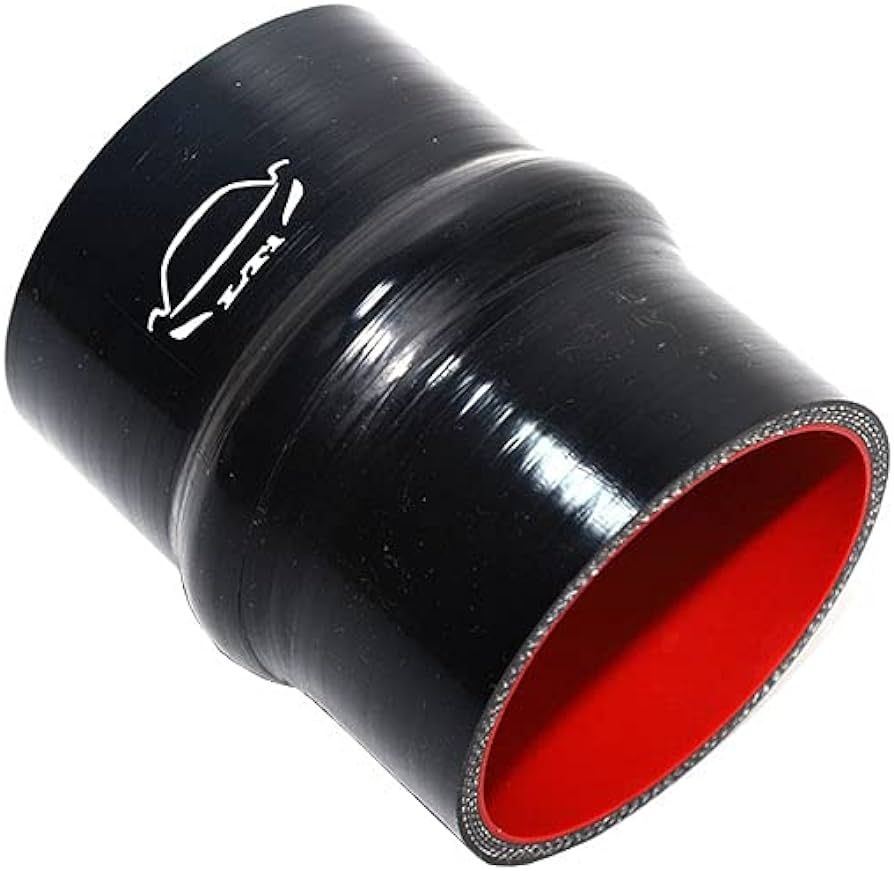

It's a rubber coupler with a "hump" in it. Typically allows the coupler to flex a little more for alignment.

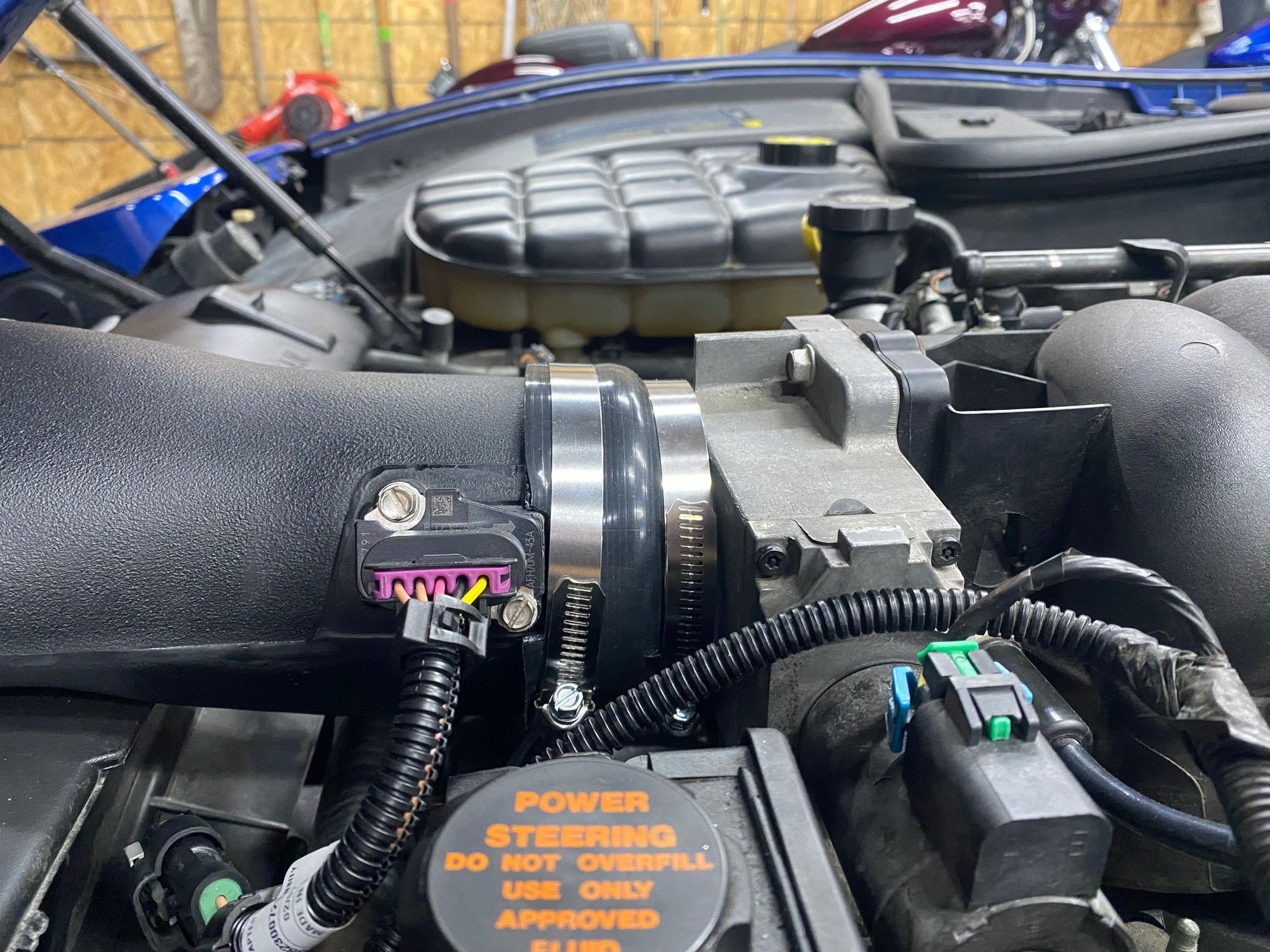

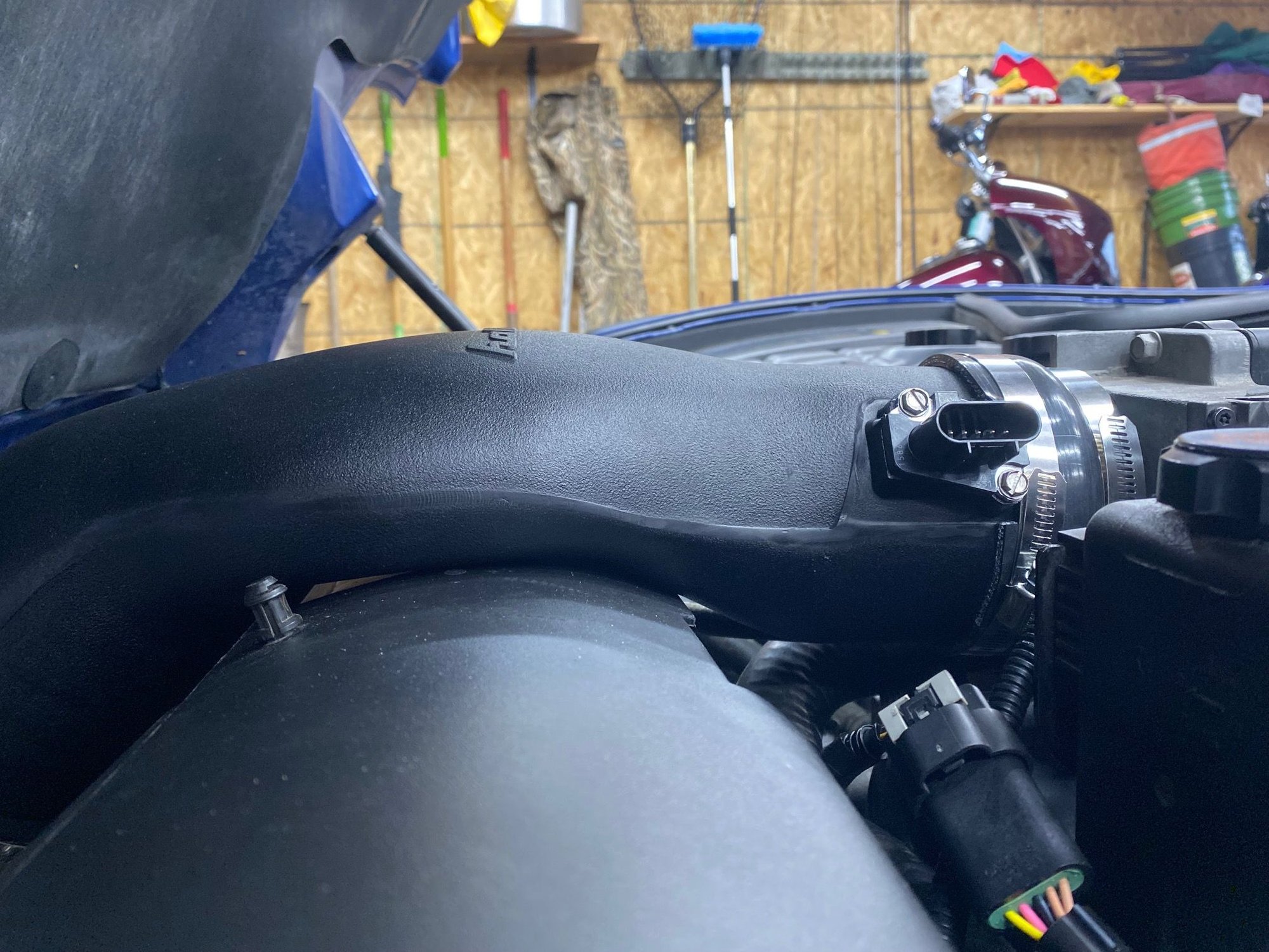

Update: I cut the coupling way down and got it to fit for what I believe is "the best it's going to get". I think the filter may be hitting the hood a little or if at all but it seems close. Anyways here's the fitment now.
I don't want to be the guy to leave a negative comment about Halltech but to be absolutely honest I'm not impressed. Sure the fix was me fitting, cutting, fitting more and trying to get it to work but the fact it hit my hood, my DM from Halltech, then emails to 3 different addresses and still no response is frustrating. Not to mention the filter came "wavy" on the top straight out of the box that I didn't want to mention.
I'm happy with the intake, it seems like a great idea and design but for the hefty tag that comes with it I would expect top tier quality no issues, no hiccups and no defective filter etc.

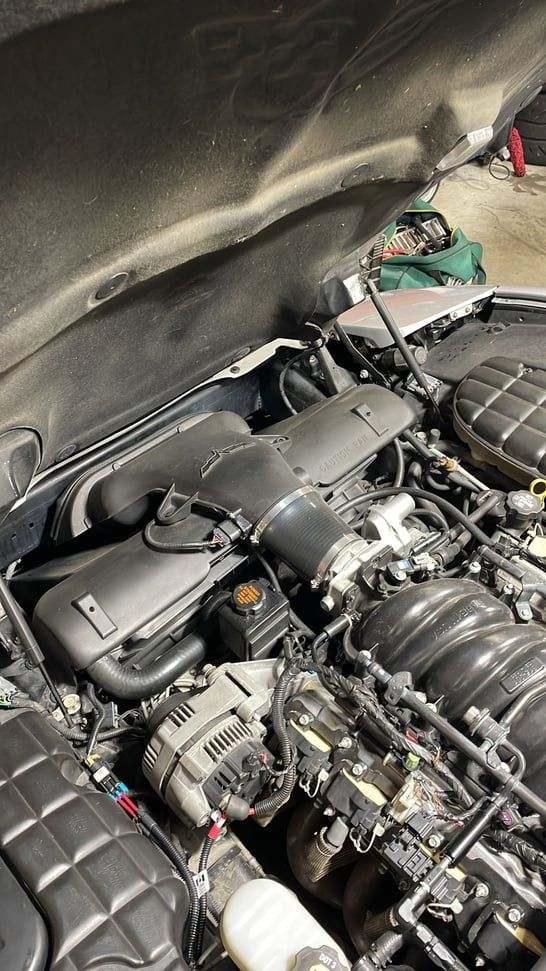

This is why I went with a stock C6Z LS7 air bridge and LS7 card MAF on my C5Z...OEM fitment/quality and it performed on par if not better than my previous Halltech intake that put the filter down under the front bumper support and not very serviceable. You can find people giving away these stock LS7 air bridges that will flow plenty for a LS6 car.

I had an idea to keep my car OEM+1 approach. At the time FAST 102 intakes were $900+ and the Dorman LS2 offering was ~$400. With a little porting I'm pretty sure I'm within spitting distance of an actual FAST intake. Now the Dorman intake is up to ~$900...along with a ported LS2 TB and LS7 air bridge the car is happy.
I figure the LS7 intake is on a bigger cube higher HP motor from the factory. How could it be negative for my cam/exhaust LS6 at ~400hp

Honestly the halltech looks pretty similar to the ls7 anyway, I would be surprised if there was a big difference in power

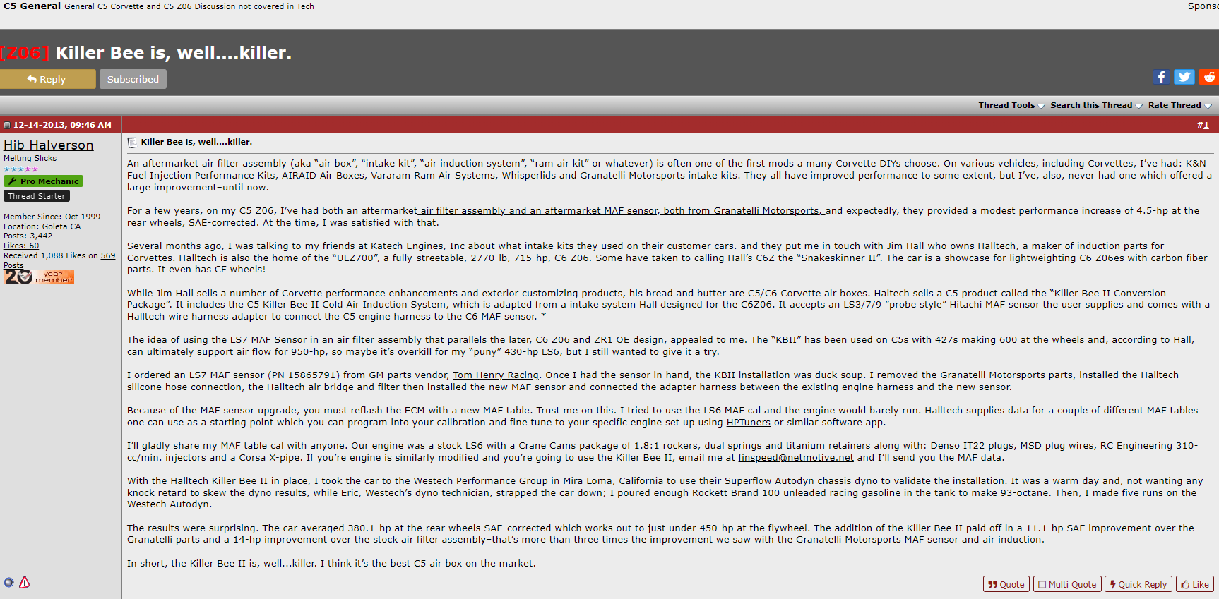

Our intake does not require carving or cutting. We saw your pics, and I mentioned in this thread that we have only seen this problem where the radiator was an aftermarket larger intake, and or the motor mounts dropped the engine. Glad you got it sorted out, but neither Dru our CEO or I received any emails from you. I did talk with you by phone at the beginning of your purchase.
Pro Mechanic Hib Halverson did a report on our intake many years ago. Check it out: Z06 Killer Bee is, well....killer. - CorvetteForum - Chevrolet Corvette Forum Discussion
Do not forget to get the ecu MAF tables swapped out for the Z06 tables. The car will not start or run until those tables are corrected for the Z06 tables. HP tuners has the stock tables for the Z06, which will get you started, but you should dyno tune this setup.

Appreciate you making this post. I have the same issue with fitment on my Halltech KB2 intake. I thought I was the only one..
I ended up putting a Blackwing filter in for the time being with my build with the OE air bridge. I don't know that I'm really being held back much with the Blackwing setup, but I'd like to explore options of a better fitting air bridge as my OE unit has a slightly loose fit between the bellows and the plastic bridge portion.
