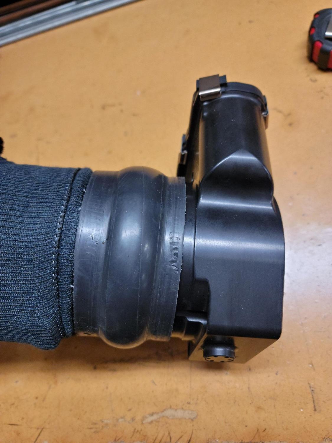

Just chiming in to say I bought this killer bee intake last spring and had the exact same fitment issue. Radiator, intake, throttle body on my car are all stock. I fussed with the thing for days, back and forth with Dru trying his various suggestions and nothing made it fit right. The shape was just not correct and the hood would not close over it. I returned the part and was charged a 20% restocking fee. I contested that the part was defective if it can't be installed on the car and he agreed to waive the restocking fee, I just had to pay shipping both ways.
I'm surprised this issue is still ongoing.

I am using the coupler that came with the kit. Im willing to try another one. What are you using? Quick google search did not yield a hump hose with a 4.5" to 4.0" reduction.
Just a generic 4" hump hose. The OD of the KB is just over 4", the OD of my 90mm silver blade is just under 4". Even with tape on the throttle body it slides right one.
It also fits on my 103 throttle body, not very easy though.

The Killer Bee intake tube I have is 4.5" OD so I need the reducer coupler. I wonder if there was a design change at some point and its only the later versions that have issues, in addition to the supplier change.

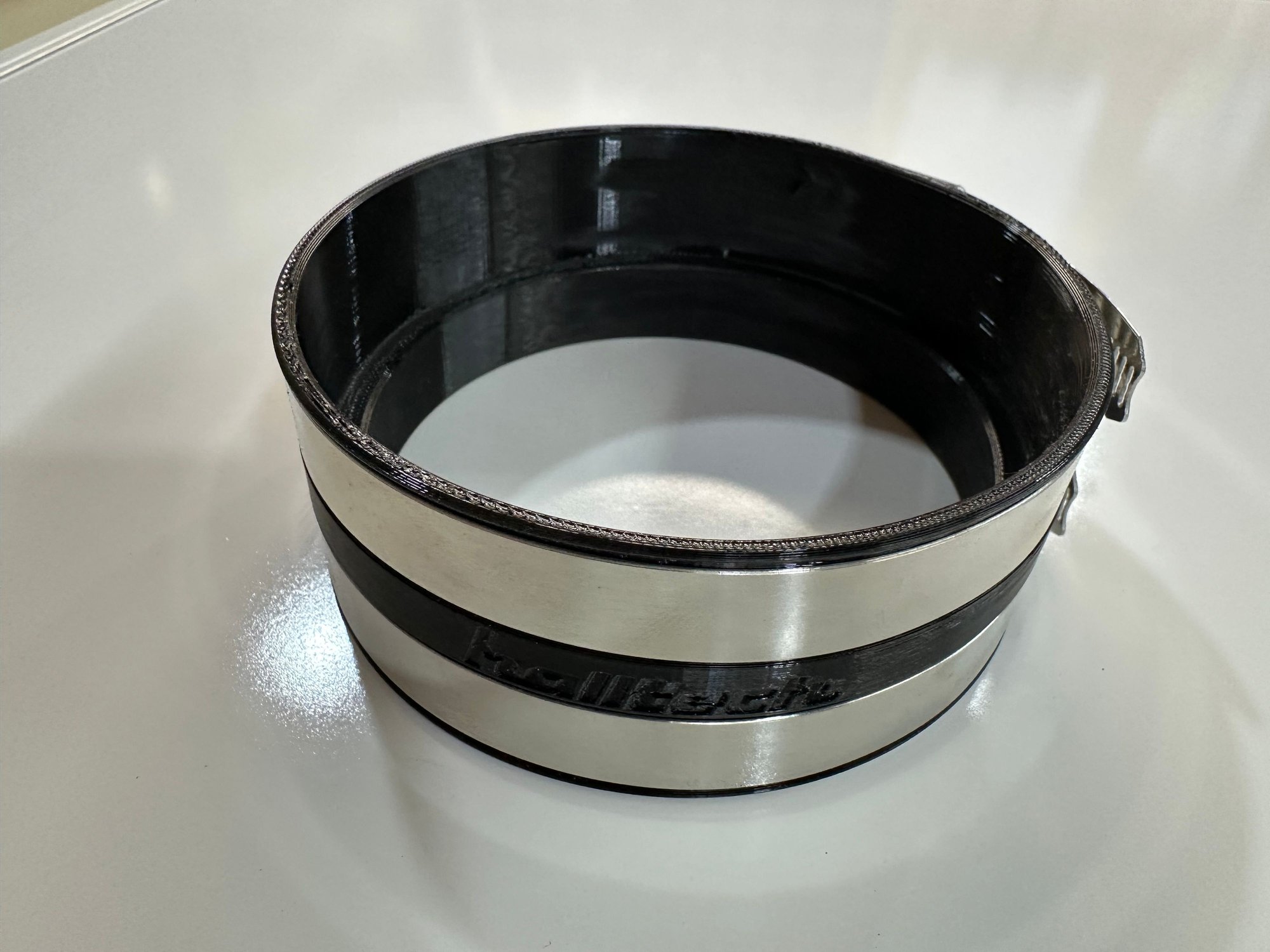

Hey everyone, I'll post photos later of our new TPU custom hose to solve this issue. The perfect length, the perfect intake diameter, and the perfect t/b diameter. Complete with hose clamp location slots, and our logo.
To Halltech Killer Bee Intake Fitment

Looks like a great solution! Again, props to you guys for making the effort to continually improve.

3D printing saves the day! Great job! So does that mean people will get different couplers depending on what TB they are running? Most likely need to offer a LS6, LS2 and 102 size couplers?

Our CEO, Dru Laws, teaches Mechanical Engineering at a local college (spare time) Here, he is just showing off!
