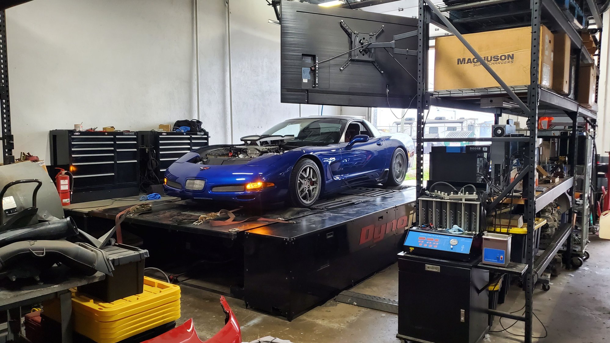

Well, I said as long as it makes 600 or more, then I would be happy and the project was a success. And that's what we did last night. Power peaked a couple hundred rpm lower than I expected it to, but the dyno was off a bit on the synced rpm, so the dyno was behind about 100-200 rpm. I think realistically it peaked about 7200-7300. But the power carries pretty flat up to 7800-7900 where we let out. Torque peaked higher than I expected, but it's a nice curve in my opinion. I think it'll want shifted around 8300-8600, but I'll have to play with it and see where it falls back into the curve again.

That is probably in the top 5 for naturally aspirated LS motahs that I have ever seen!
Fantastic.
It is very refreshing to see an N/A enthusiasm.

On the dyno sheet? If so, we had that hooked to the vac pump. So I was reading how much vacuum it was pulling on the crankcase
