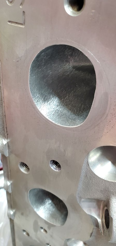

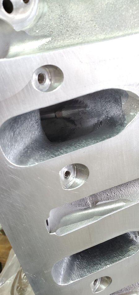

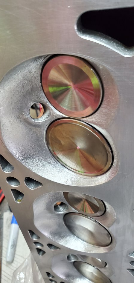

TFS 220 heads heavily worked over to replicate a tfs245 and then some. 2.1/1.6...360ish/270+

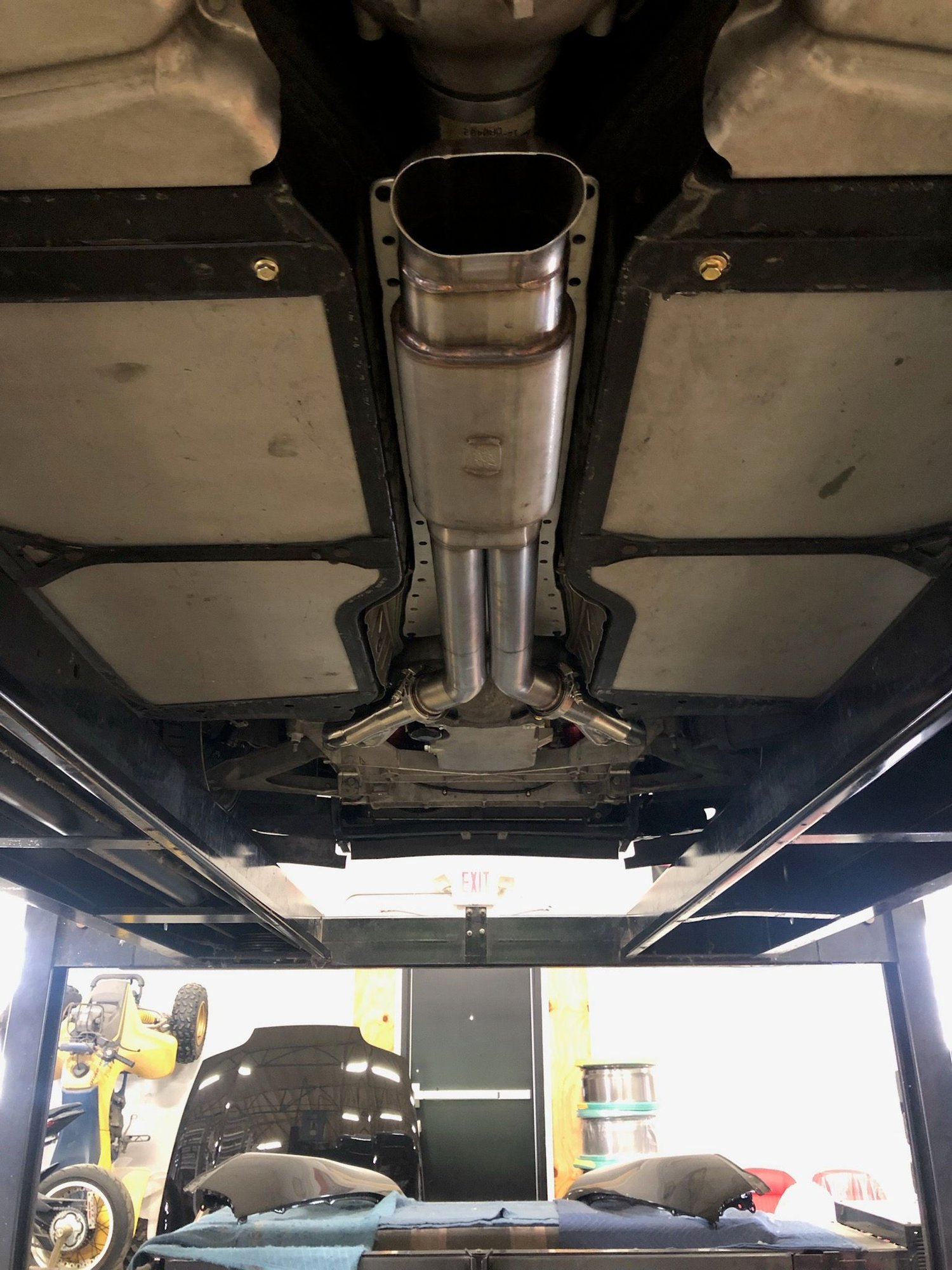

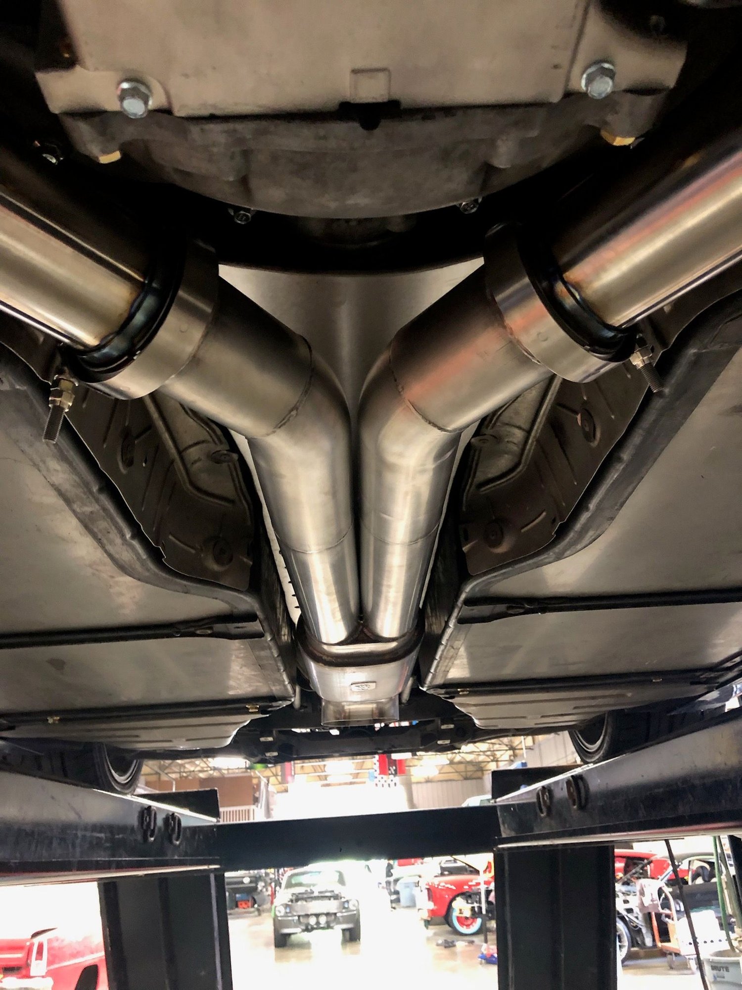

2" Headers, 3" collectors into a single 5" oval spintech pro bullet muffler

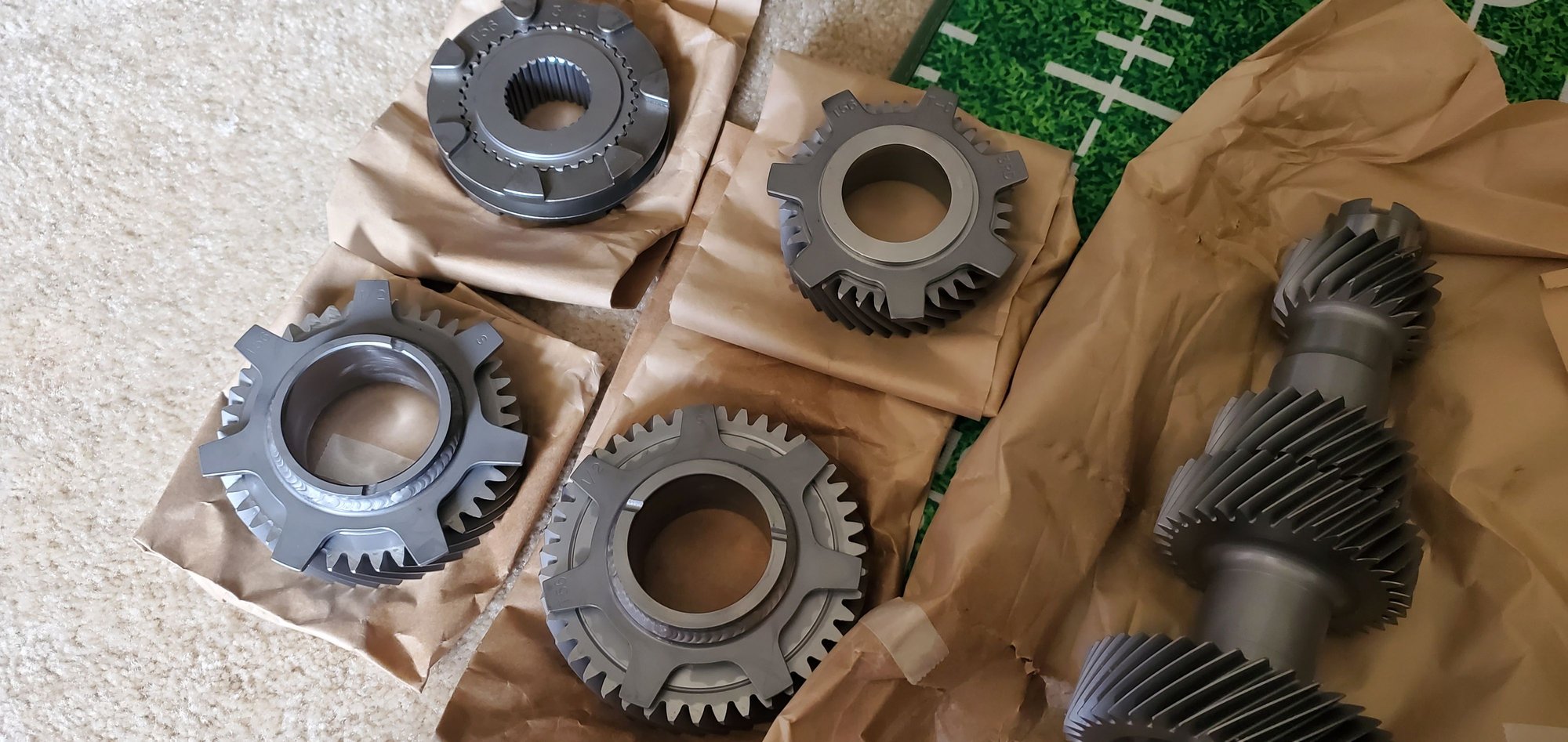

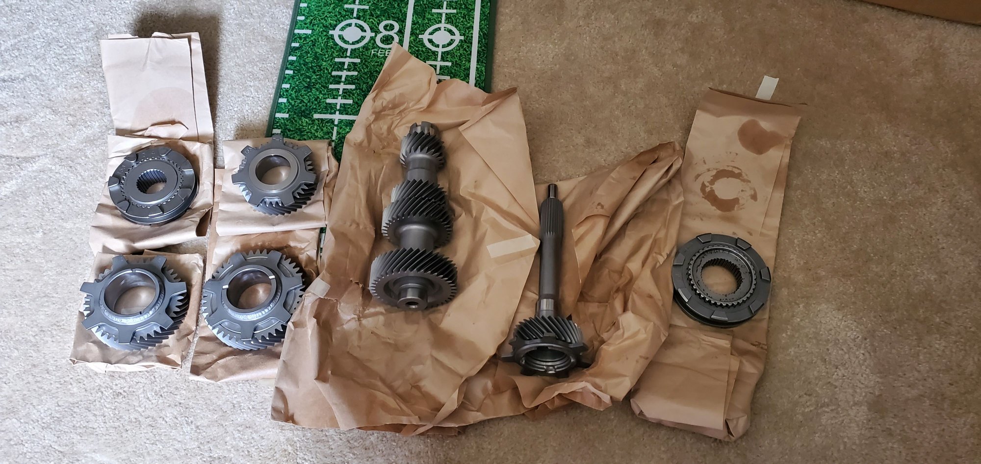

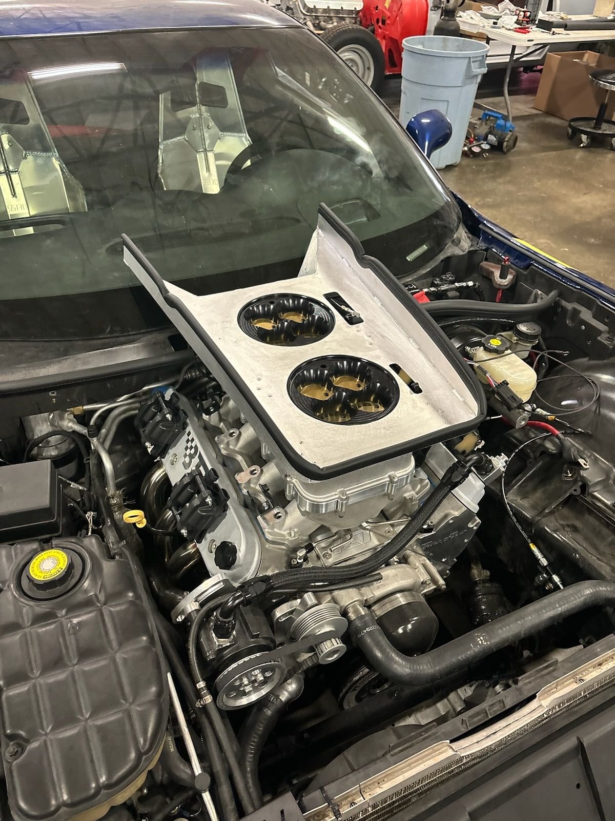

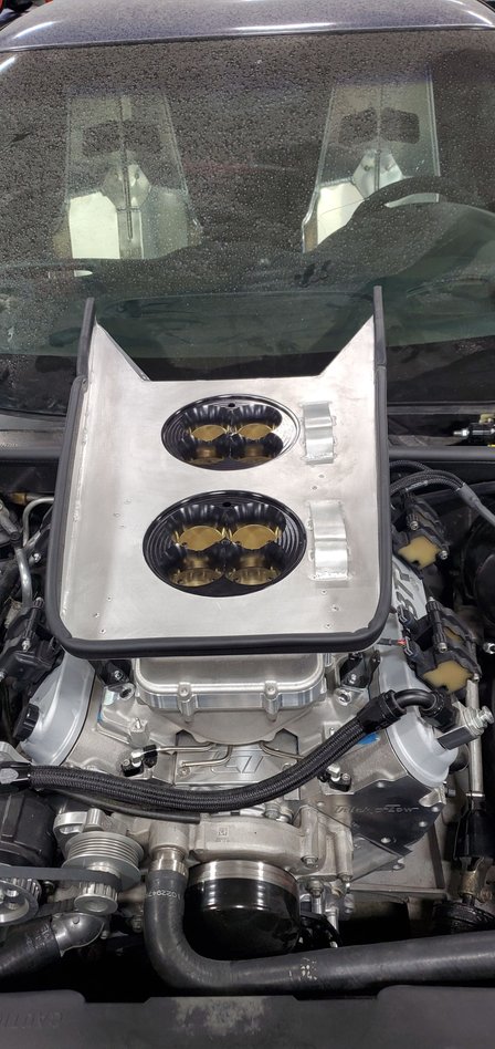

Had Liberty faceplate 1-4 in the trans, put a 3.90 in the diff. Switched the car over to a holley terminator with an HCR harness instead of Holleys junk harness. Put some Kirkeys in it, a VFN cowl hood to clear the manifold and built an airpan for the throttle bodies. Goal for the motor is around 700-750 fwhp. Figuring 1.7-1.8hp per cubic inch which shouldn't be at all unrealistic. Should land it around 600-630 whp I would imagine and trap around 138-140 if i do run it at the track on motor. The car will eventually get nitrous again in the form of a direct port.. But I need to get used to the thing again once its running and tuned since I haven't driven it in about 2 years now.

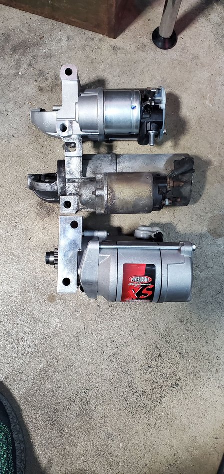

If anyone wants to know the size comparison between a new lt style starter, stock c5 starter, and a power master 9509 starter.. The c5 starter wasn't going to fit well with the 2" headers, so I tried the powermaster out... That was going to be a pain so I bought an lt truck starter and it just falls right in place.

Thing of beauty! man, that exhaust is INSANE!

Thanks man. It has been a process lol. Hopefully have it home in the next couple of weeks and spend the winter taking my time wrapping everything up. Was trying to get it running and on the dyno before winter, but I am losing my battle with Father Time and Mother Nature. So instead of rushing everything, I will take my time and make sure I don't miss anything,.

Cool build but that exhaust would last exactly .001 seconds with me lol. That's going to be LOUD and dare I say unbearable lol
Honestly, shouldn't be too bad. I said before if it is on the ehhh side then I would add a second muffler.

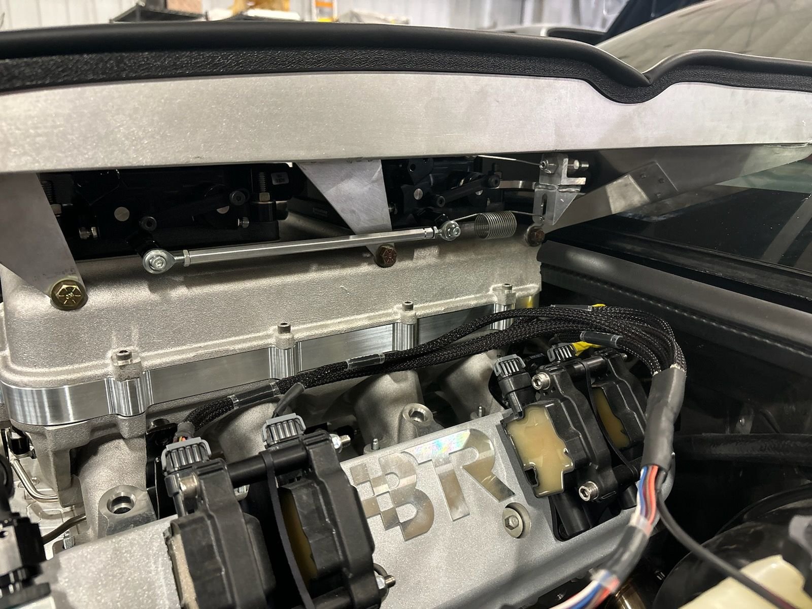

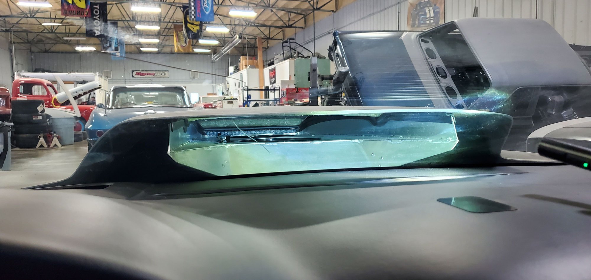

Some shots from a week or so ago of the hood.

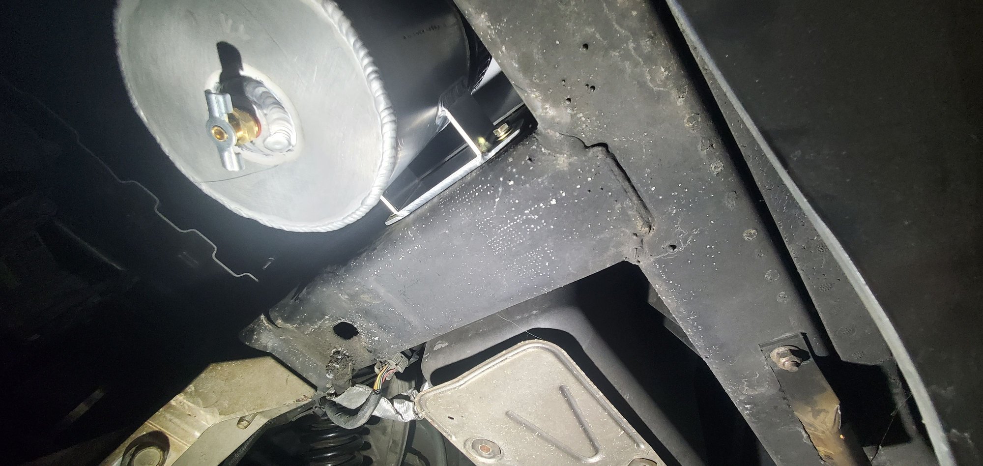

Couple shots of the air pan with the caps welded on to cover and seal around the linkages. Couple more of the catch can @jayyyw made for the car. Trimmed the turn down at a 45° to get the noise out and back instead of straight at the ground.
