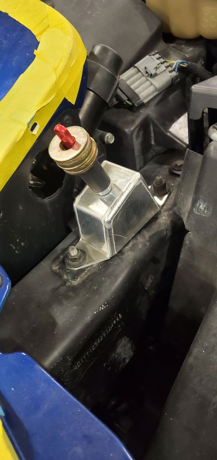

Here are the custom aerocatch pin mounts my friend made for the front latches.

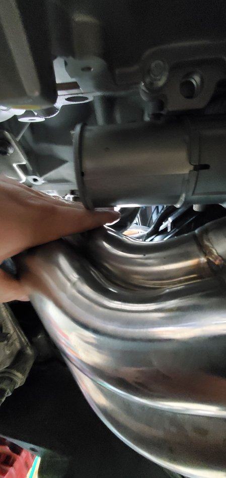

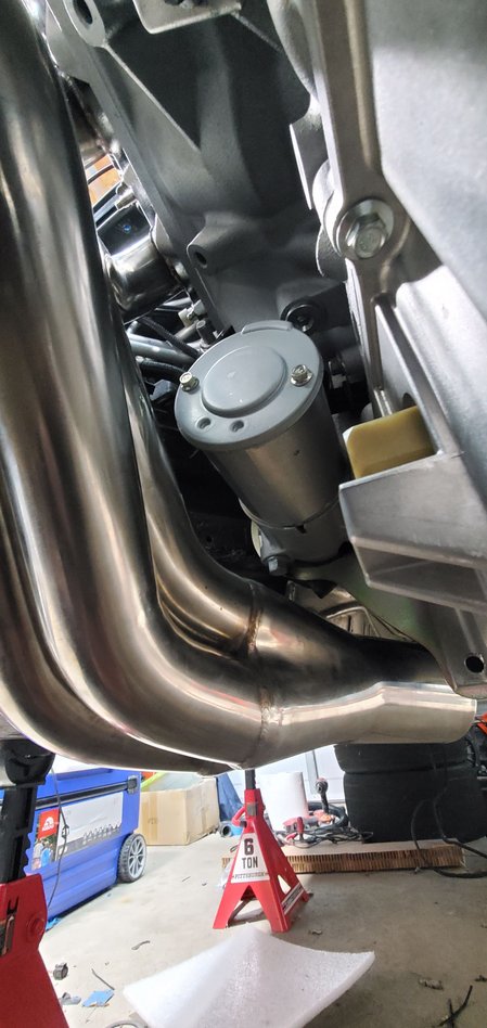

If anyone wants to know the size comparison between a new lt style starter, stock c5 starter, and a power master 9509 starter.. The c5 starter wasn't going to fit well with the 2" headers, so I tried the powermaster out... That was going to be a pain so I bought an lt truck starter and it just falls right in place.

I’ve heard the LT truck starter has more torque as well. Seems like a nice upgrade. I should get one
You happen to have a part number or model year to share?

Starter itself 12695760
Factory LT heat shield 12633476 (not sure if this will fit, but it is cheap)

What outcome would you like to see? It has started to be a common replacement for larger primary headers. I can leave the headers installed and install/remove it.
Here is the space around it installed.

I took note of this for the turbo install. Good information I had not had previously. I've already got the power master one with a blanket on it, but it doesn't clear I know which way to go.

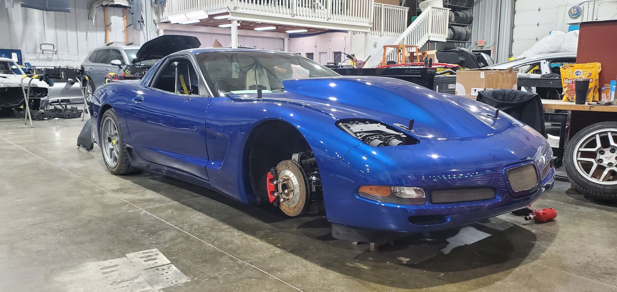

Old Nov 8, 2024 | 06:47 PM
mykream's Avatar
mykream
Joined: Oct 2016
Posts: 1,209
Likes: 363
From: Massillon Ohio

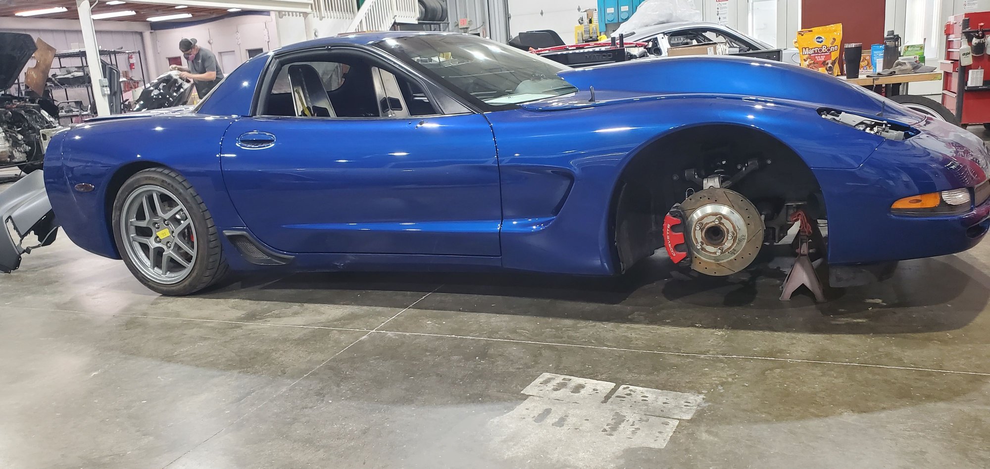

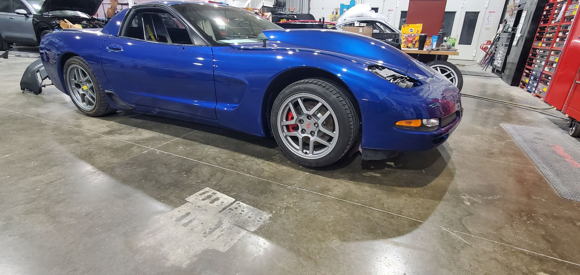

Body parts are back on. Thing is looking hawwwtttttt

That is some fierce motivation there now!

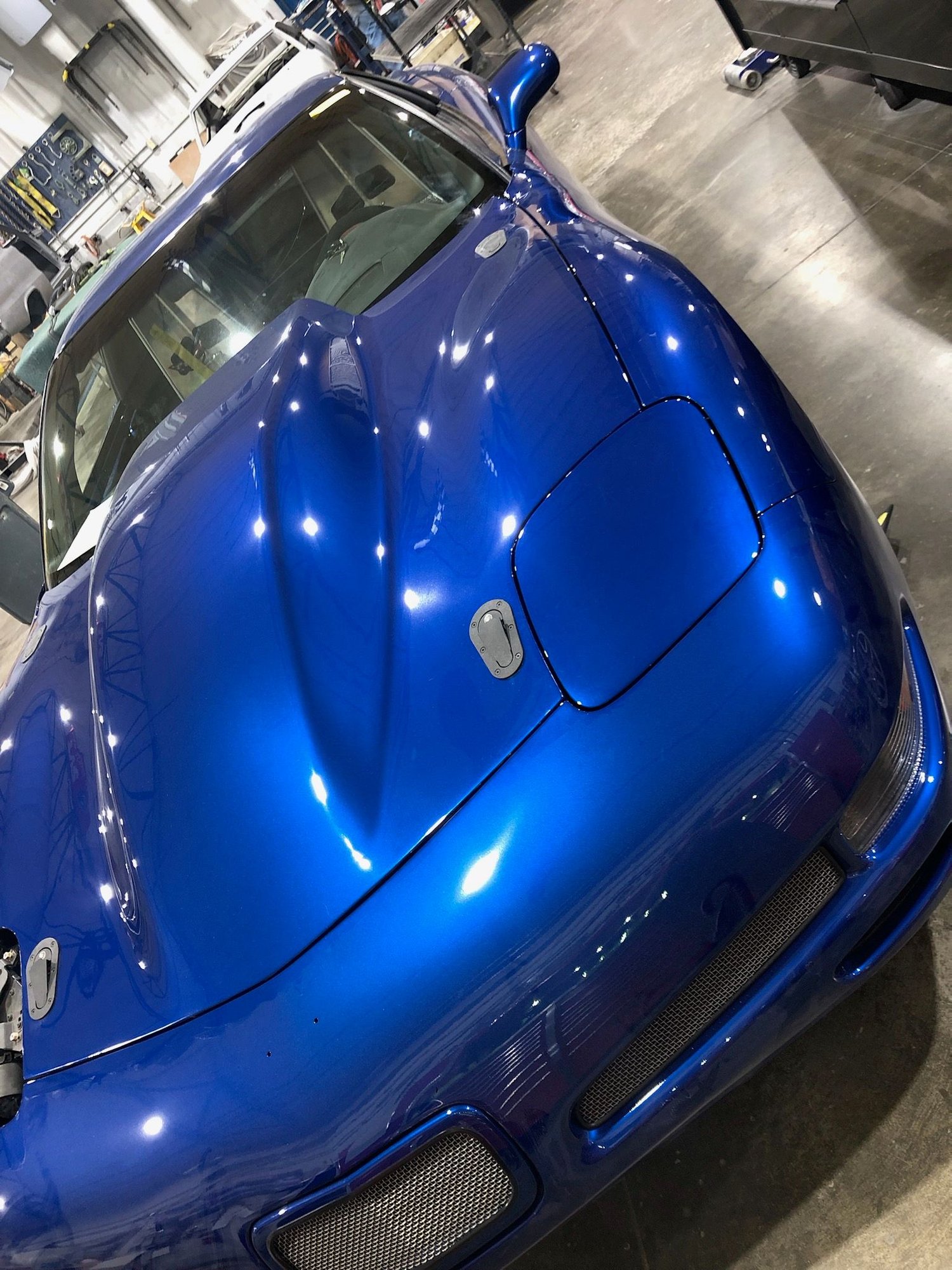

Old Nov 11, 2024 | 09:50 PM
mykream's Avatar
mykream
Joined: Oct 2016
Posts: 1,209
Likes: 363

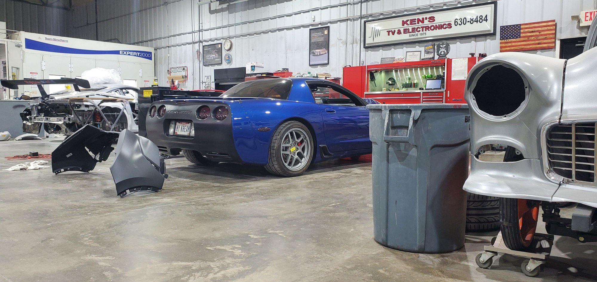

More pics I took today

I want to see that car jump a coke can next summer. Because it totally looks like it could! Badass

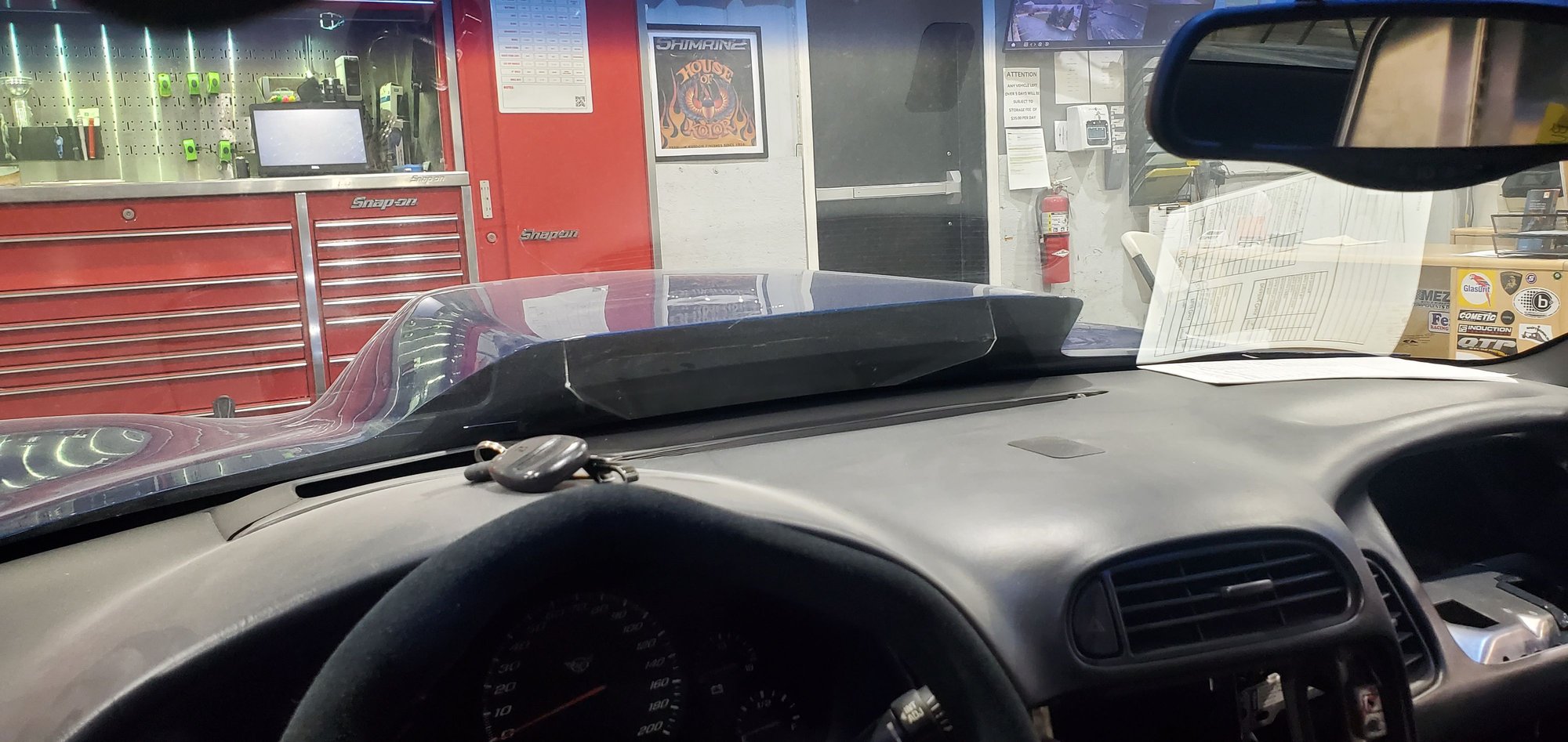

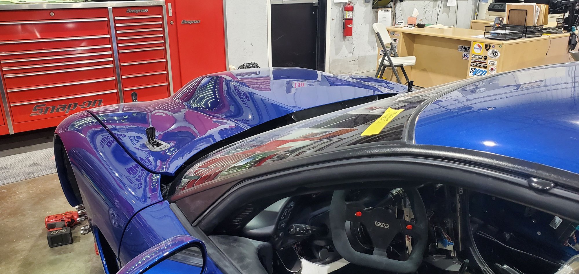

So the glass company came a couple weeks ago to replace the windshield as it has been cracked for years. After 3 or so windshields that were either scratched or warped (or both)... They finally got a good one installed yesterday.

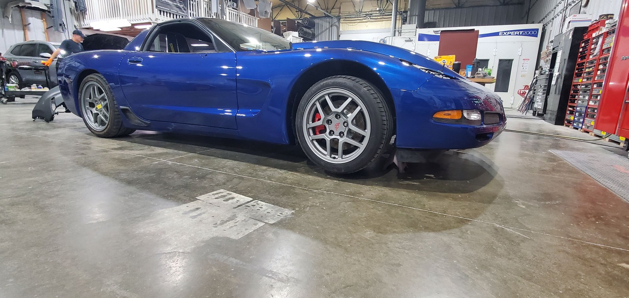

Old Nov 27, 2024 | 08:43 PM
  #35
mykream's Avatar
mykream
Joined: Oct 2016
Posts: 1,209
Likes: 363
All done and ready to come home! Gonna load it into the trailer Friday and haul it home.

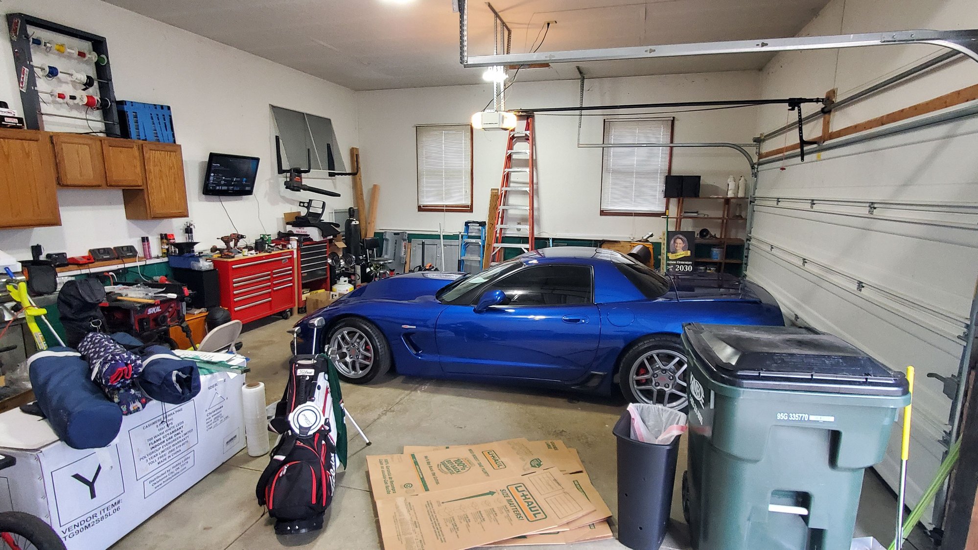

Old Nov 29, 2024 | 08:50 PM
  #38
mykream's Avatar
mykream
Joined: Oct 2016
Posts: 1,209
Likes: 363
Safe and sound at home!

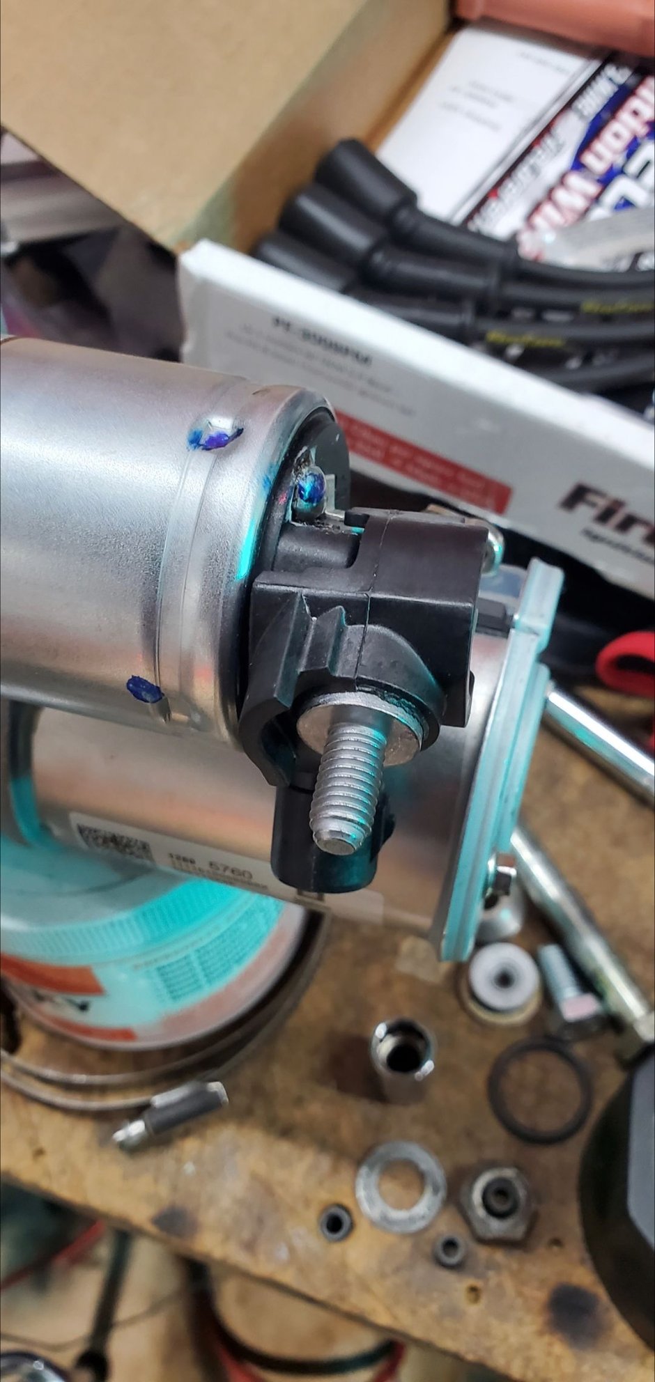

@mykream I broke the plastic input terminal off my stock starter yesterday, so I figure if I have to pull my Kooks off to replace it, I may as well get the truck starter. Is this a plug and play deal, or do I need to change connectors or anything? Thanks! Your car is looking real nice, BTW!
Old Dec 1, 2024 | 09:41 AM
  #40
mykream's Avatar
mykream
Joined: Oct 2016
Posts: 1,209
Likes: 363
This is how it comes, I pulled the adapter off though.
Then this is it with the adapter off.
It'll hook up just like your current starter
