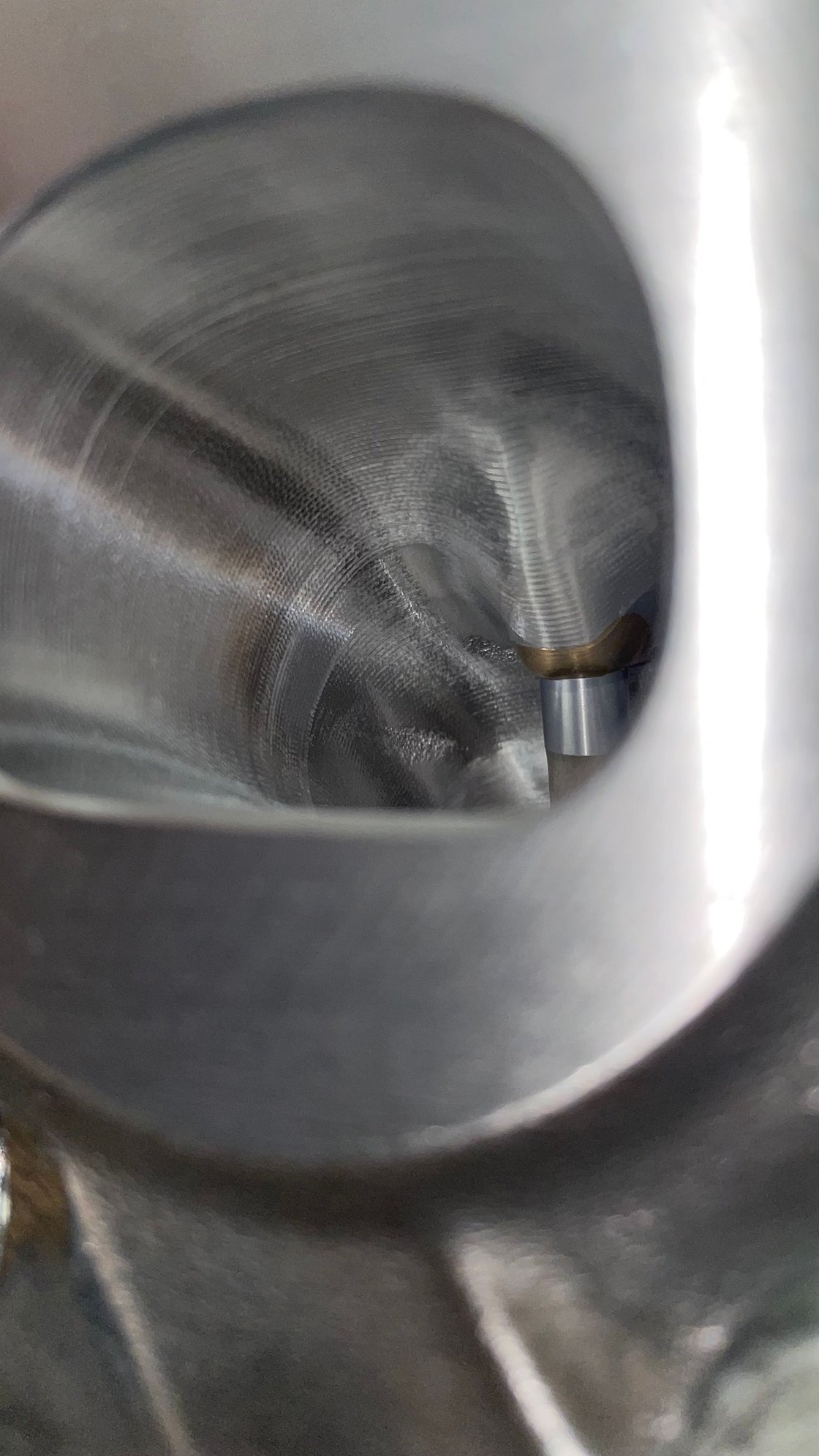

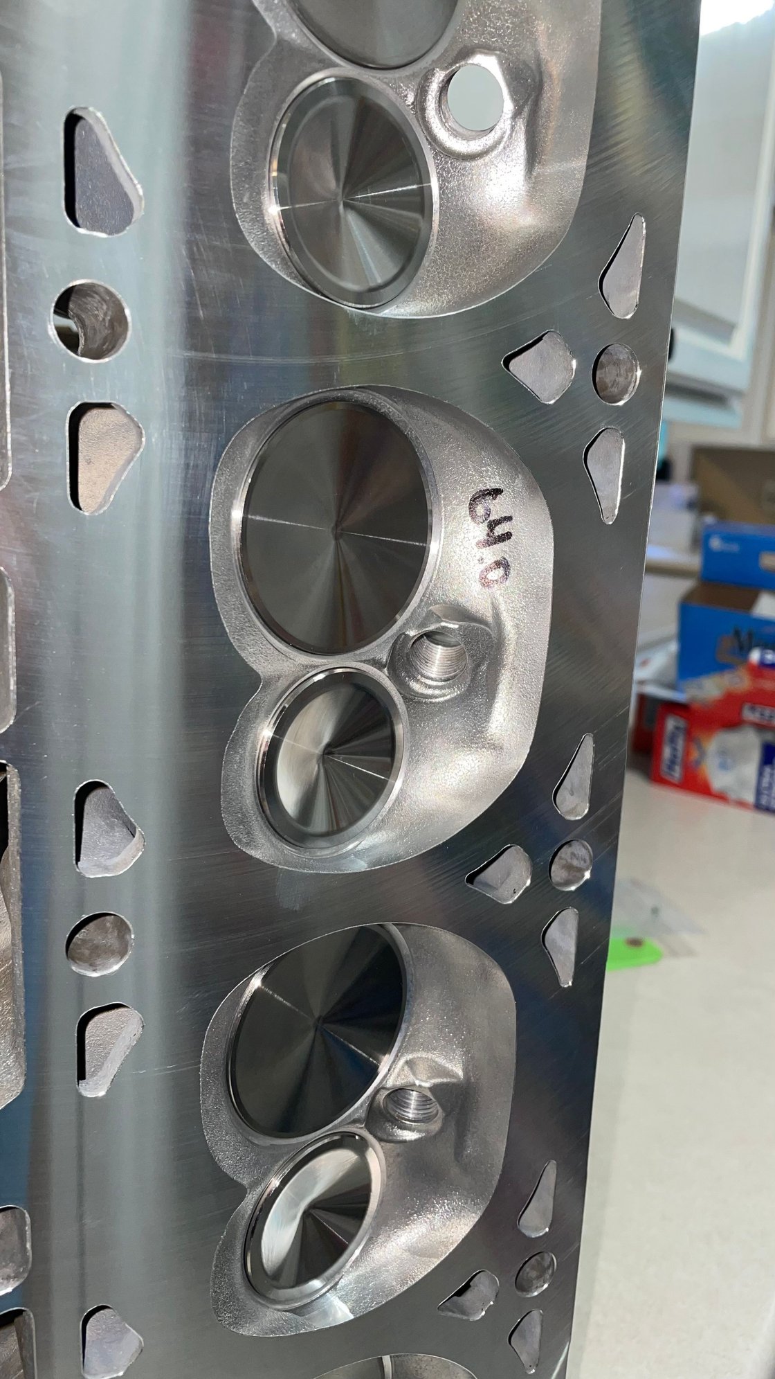

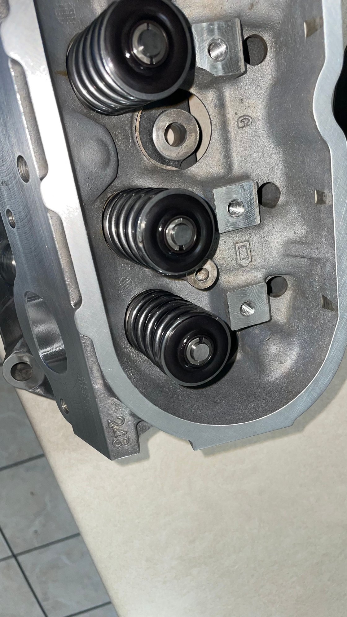

Well... this took a little while. I got them yesterday. The CNC machine work looks great.

Wow! That CNC is definitely better than anything else I’ve seen…

Yupper, especially on the exhaust side where more material was removed...
...anyway, I think a very good use of a set of factory 243s I had laying around.

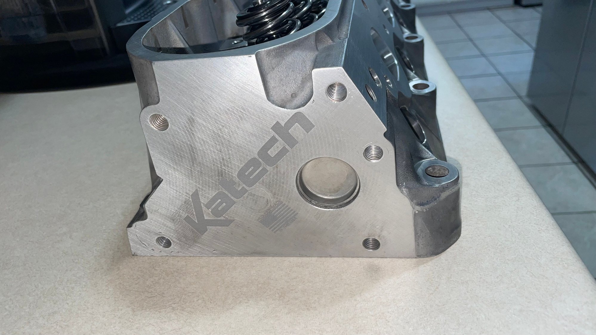

I had a set of 799's done @ Katech for the standard CNC package and they look fantastic!
They're local to me (i.e., Metro-Detroit area) so it was easy enough to just drop them off. I did have to remove valves and springs, etc., and re-assemble everything, but no big deal.

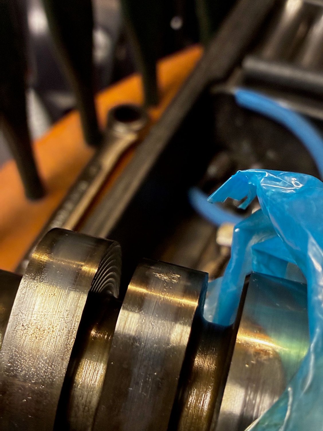

  • The factory ZO6 cam had some pitting on one of the lobes
