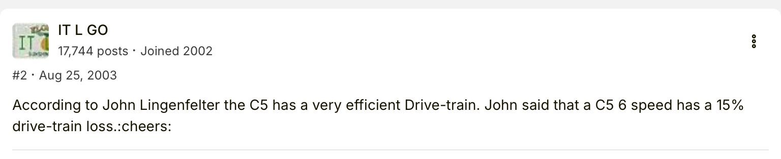

365 / .85 =429.412.
344 / .85 =404.706
I believe the accepted power train loss on a manual C5 is15%. In that case 405 hp would make 344 at the rear wheel.
Who knows for sure…but I have found this to be the case with my two C5’s…

Originally Posted by vette4fl
365 / .85 =429.412.
344 / .85 =404.706
The multitude of people who've dyno'd know for sure, unless dynojets are unrealistically optimistic. Those (DJ) tend to be the numbers that I see quoted the most and they tend to land in the 355-365 range. Stock manifolds, free flowing catless exhaust, and a dyno tune should have an LS6 at 380whp all day. Just ask the Spec Corvette guys.

Wow…. Looks like only a 7% power train loss ! That’s amazing.
380 / .93=408.602

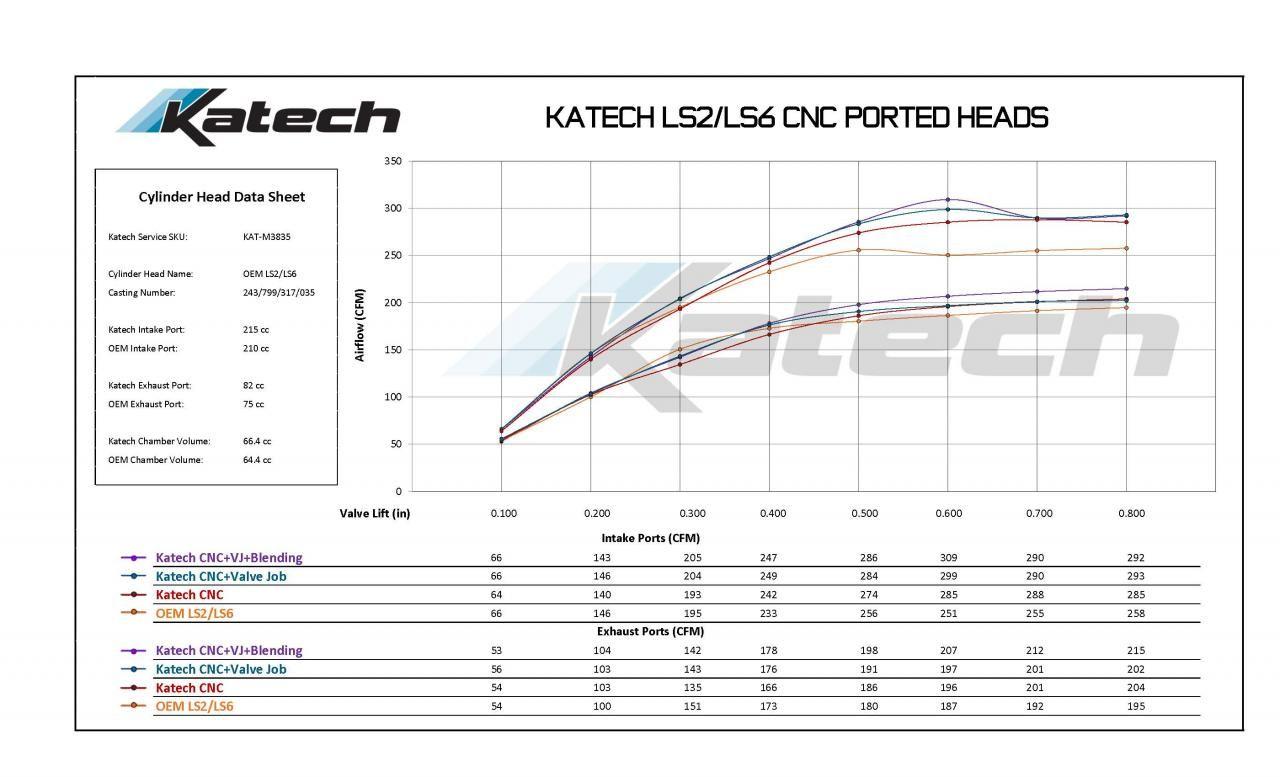

I know the below link is a very old post on the subject, but it is from TonyM;
https://ls1tech.com/forums/generatio...ml#post5181827
Below is the image from Katech's website which seems to agree with what TonyM was saying nearly 20 years ago. I would think that Katech's 215cc intake port would help any combo breather better at top end vs stock 243/799 castings - while also helping to minimize any torque lost below 4000 RPM due to lower intake charge velocities, which dyno testing has confirmed with the larger CNC 225-228cc intake ports on say a 5.7 to 6.0L LS engine.
Basically it comes down to where you want / need the power to be in the RPM range. Personally (due to the -2cc valve relief in my forged pistons) I would also want Katech to mill the heads slightly to get back closer to the 64.5cc chamber size to maintain the stock LS6 CR target and / or at least run a set of Cometic 0.040" compressed MLS head gaskets for the same reason.
For most of our street driven miles, I would also think mid range punch from improved torque is more important than top end dyno bragging rights, but as always YMMV.

That’s precisely why I had my cam configured with .587 lift (I told CamMotion .590 max and they decided on .587 …). I’m no expert for certain, lol, but my “research” indicated stock 243 heads potential is around .590 lift. So with CNC and headers, I hope to break out of that flat spot (shown in the Katech graph) in the .450 to .600 range. I strictly street drive so a strong midrange rip to about 5,200-ish is the most it’s going to see before speed, even in second gear, becomes the performance limiter.
Like others have said, the dyno is a tuning tool, so not too hung up on numbers, as long as the butt-o-meter approves.
