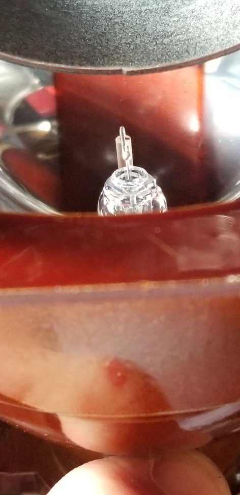

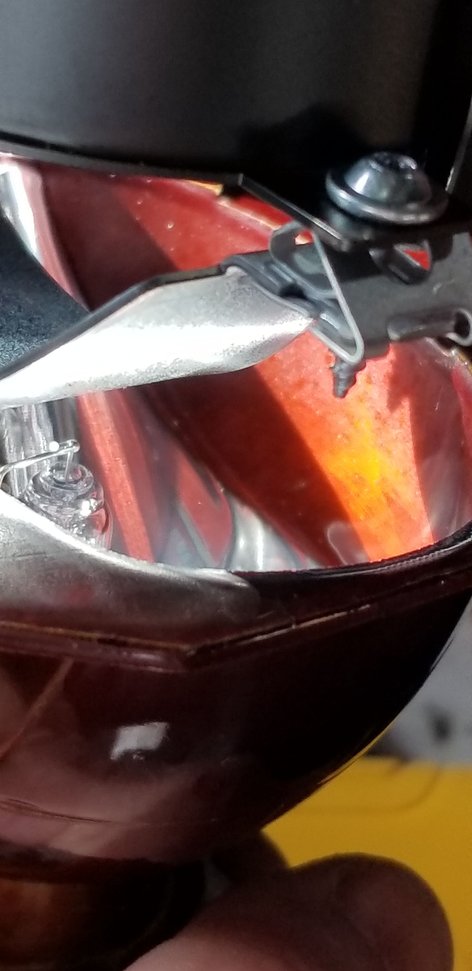

This is the inside of the projector. Top and bottom don't have chrome.
