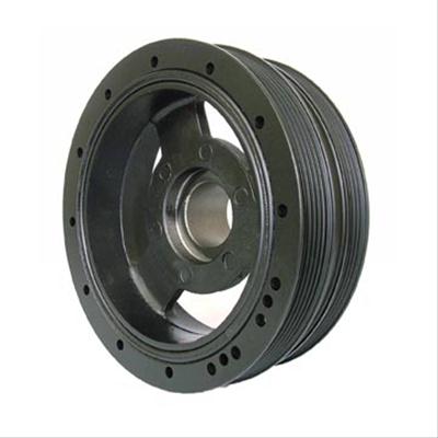

As for why the ATI is better that the SS for superchargers, the SS still have the rubber piece that is glued to the both piece in the center, while the ATI has the pulley bolted to the center hub instead. Hence on the SS, with enough super charger torque to the HB, you can break the SS rubber bonding free to allow the pulley to slip on the hub isntead (although it won't wobble if it slipping due to side retainers).
The down side on the ATI, if you ever need to pull it (will need to remove the outer pulley first), replace the pulley bolts with brand new bolt, and don't try to reuse the old ones. Hence it not pretty if you try to reuse the old ones, since they only want to take a torque one time like the main HB bolt, and will end up snapping isntead.
