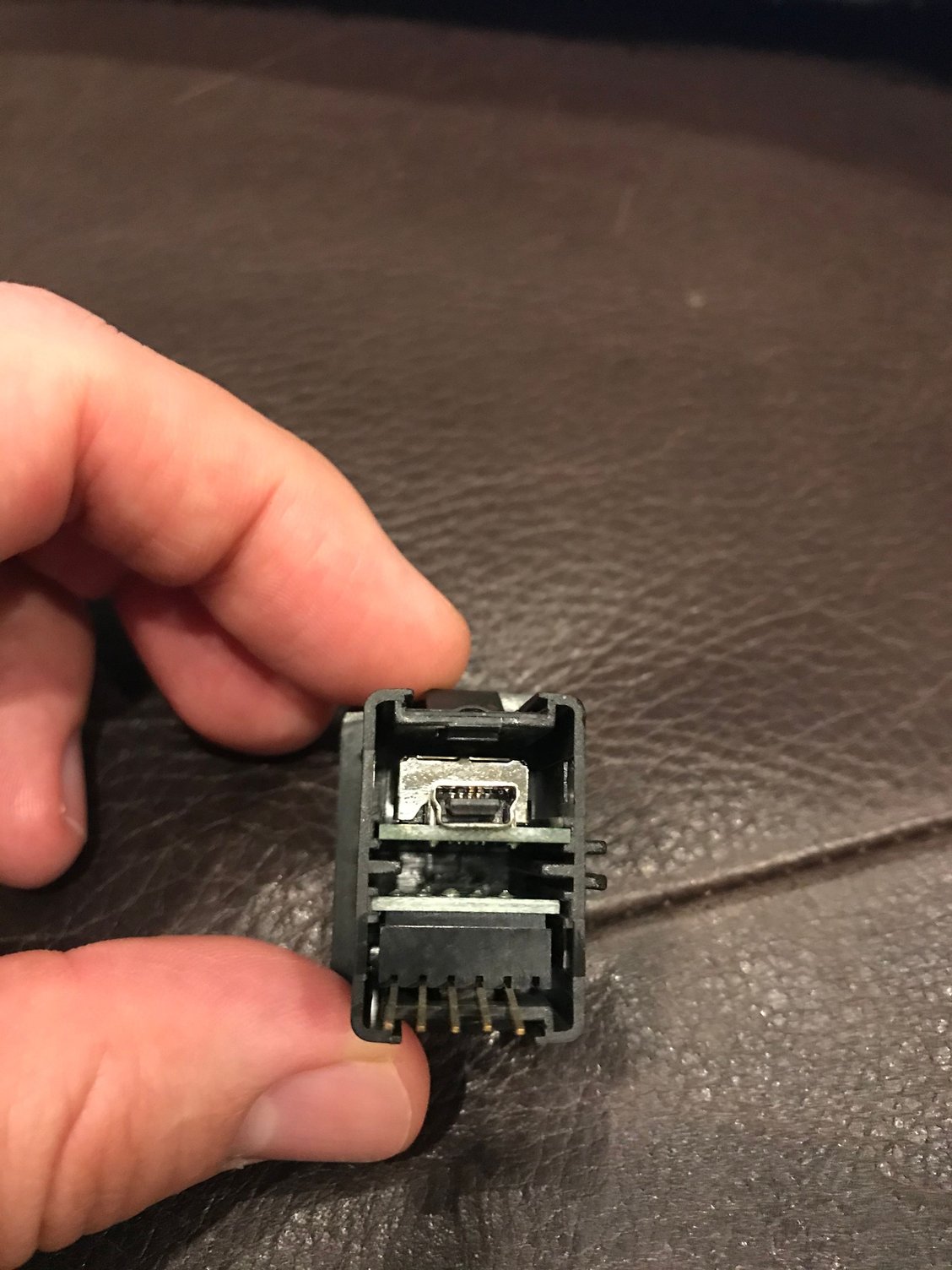

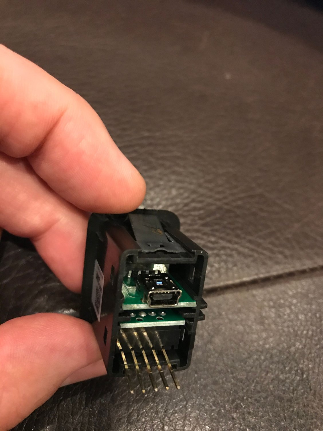

I took it apart a little more. On the front side, Aux is on the bottom and USB is on top.

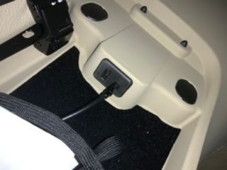

Not trying to fit a square peg in a round hole. I was trying to keep the power outlet. 2011 may have been the first year and maybe only on 3lt cars with Bose (not sure) that Chevrolet put USB and Audio in connectors in the rear of the console. The OEM is more rectangular than square but the Amazon one doesn’t give accurate dimensions.
I have that in my 2012 2LT. I've considered trying to make the old parts work with the new, like the microphone, etc. but made the decision to leave all of the old stuff in place and functional again someday if anyone ever had any reason to put the old head unit (which I'll be boxing up and putting away) back in the car. I never use those plugs in the console and almost never need to plug my phone in when in the car, which is why the wireless carplay was important to me. I'll probably take one of the usb cables and make sure it's exposed somewhere for the eventual usage of it but doubt it will get used very often. I want to be able to hop in the car, put my phone in the ProClip holder and then not have to touch it until I get where I'm going.

Using a mini-USB to USB cable from the stock late-model center console jack to a Kenwood works fine for CarPlay (that is what I did and tested, although I actually use wireless CarPlay now that it is setup). Yes, it is USB-2 cable, the 2019 Kenwood's are USB-2 in any case (the 2020s might be USB-3, I don't know).
