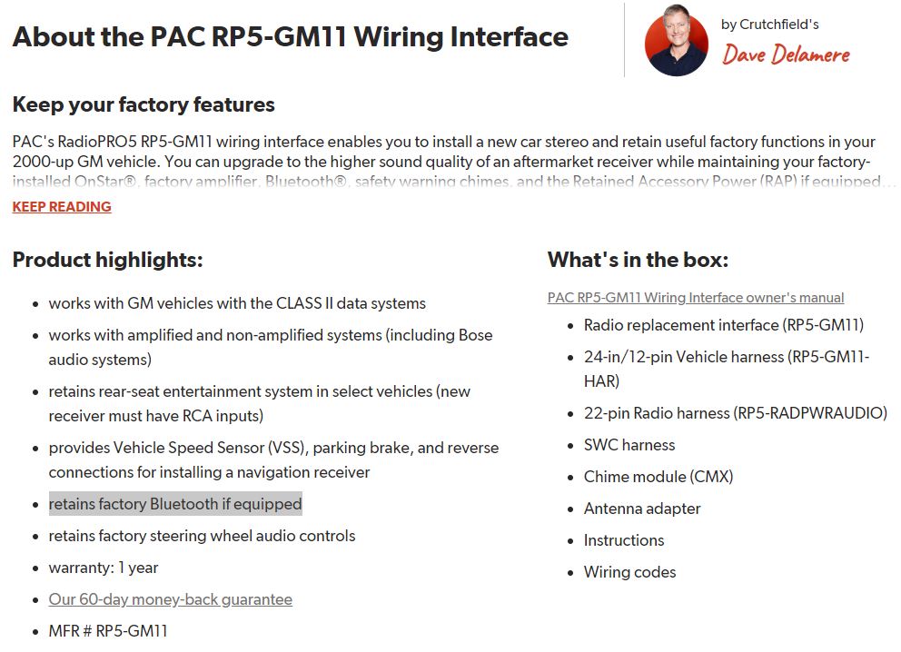

My first question, now that I've come up with the list of components, is regarding the PAC wiring interface. I'm posting an image of what is stated on the Crutchfield website about it. Highlighted in grey, you see where it states that it retains factory bluetooth if equipped. Does anyone know if that's the case with our cars and/or to what extent? I would assume the unit has it's own bluetooth interface that has nothing to do with the factory system and that I'll probably even have to run another mic for phone calls as opposed to being able to use the factory mic.

The highlighted part above does not pertain to the C6. You can splice into the factory mic if you choose or you can run the mic that comes with the head unit to your desired location. I ran the mic and installed it right next to the factory mic. You would never really notice that it is there.

Okay, makes sense that a new mic will need to be positioned. I'm not even sure what they are referring to about keeping factory bluetooth, unless they are referring the the mic anyway.

I'm taking advantage of the Crutchfield service to pre-wire my interface harness for me. The PAC adapter description states the below with respect to the parking brake. However, I've read something somewhere about a wire needing to be run to the parking brake. Does this adapter take care of that? I realize I could somehow just ground that wire and fake the system out, but I don't care about being able to do things while moving that it doesn't want me to do. On the other hand, I almost never set my parking brake and having to do so just to access something on the radio (not sure what that would be) would be a pain. Or is this all a non-issue since I am not adding on-board NAV and doubt I'll be playing videos.
provides Vehicle Speed Sensor (VSS), parking brake, and reverse connections for installing a navigation receiver

The green parking brake wire according to the head unit manufacturers is normally connected to the parking brake circuit of the car, this is a safety feature to prevent people from accessing the navigation menu to enter information while driving. This can be bypassed however on most systems, see this video.
So to enter info in the system, either the green wire needs to be connected and the parking brake applied, or the bypass done, otherwise you won't be able to access it.

Yes the Pac wiring harness takes care of all of that. I would suggest grounding the parking brake wire so that you don't get locked out of certain features while the car is in motion. Here is a vid.
