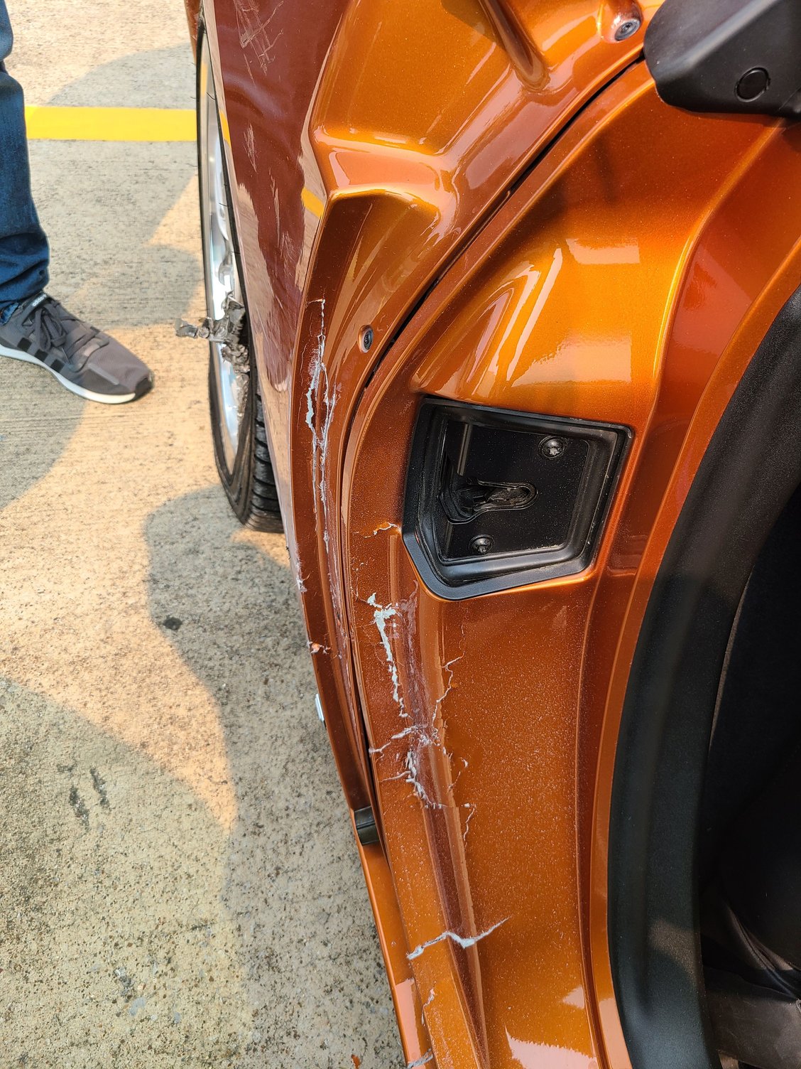

Some dumbass with no insurance pulled out into traffic yesterday and hit my beautiful 07, Atomic Orange Metallic Vette. The impact was right on the rear passenger wheel. Got the door, side and rear. Rear suspension is messed up pretty bad. I could see that. Three rims damaged and some other body damage. One of my concerns is when I opened the passenger door, the fiberglass in the door was all busted up. I was just wondering if this can be fixed? I've attached a pic. I'm still sick...

Most importantly you are okay. The damage to the door and other areas appears quite severe, not sure if the door damage can be repaired it is possible you are looking at a total.

Man that sucks, the rocker being split is an expensive fix

Looks like all replaceable parts. The only one that could be more difficult than the others is the aperture panel around the door. That goes from the A pillar, to the B pillar. It is glued to the frame so and you have to take off other things before you can get down to it. More than likely there is no damage to the structure of the car (it is a plastic body on frame and I suspect the frame wasn't touched). Will probably have to replace the upper and lower control arms, knuckle, wheel bearing, and tie rod on the side where you were hit. Again, all bolt on parts. Any good body shop should be able to repair it to like-new condition with not much effort.
The door damage is easily repairable but I would see if the insurance company would pop for a new door.
The thing about Corvettes is they can take one hell of a beating in a crash and be easily repairable. Unlike a unibody car warped cracked, broken body panels don't mean much since they aren't part of the car's structure.
