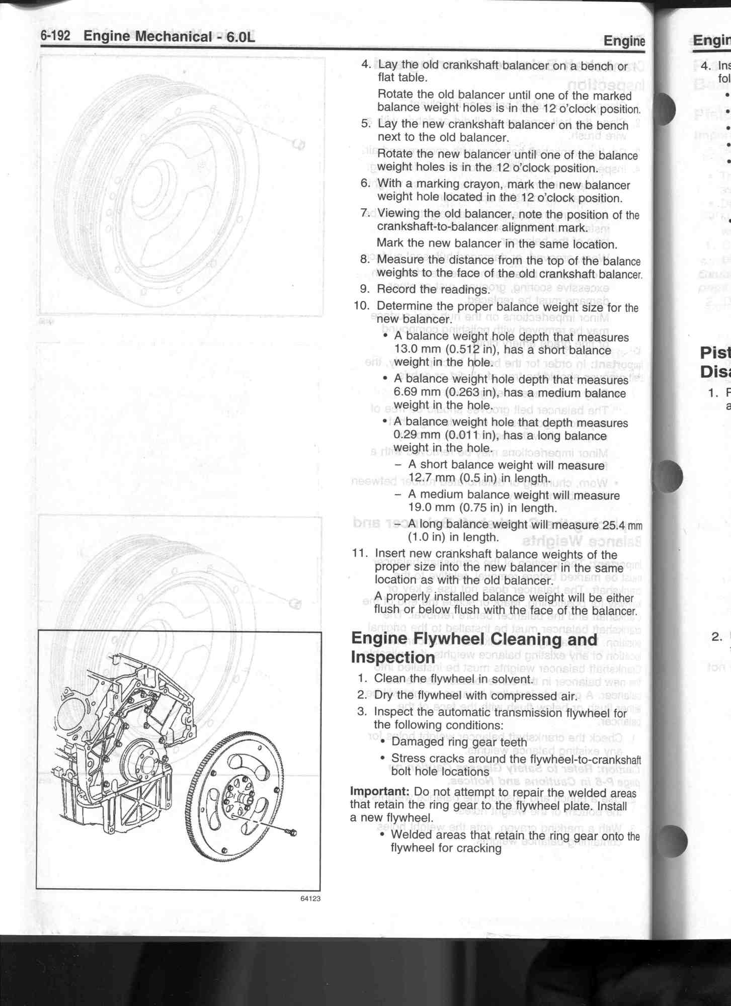

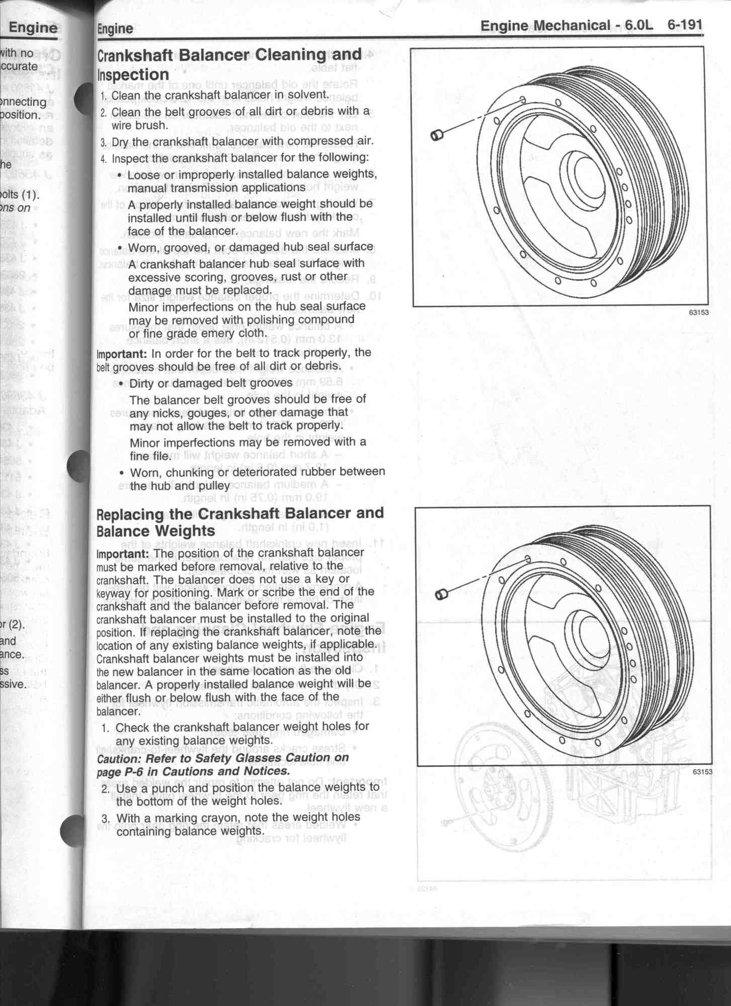

I know if mine needs to replaced will use the GM replacement. Would be concerned about not following the factory replacement procedure balance weights. 2012 LS3 M6.

FYI your LS3 balancer is neutral balance. The engine is internally balanced. Powerbond works just fine. Rock auto around $200.00 plus tax and ship.

Just ignore the balance weights and GM service manual?

Yes. There are no balance weights on an OEM harmonic balancer. Even if there were where would you mount them ?
If mine ever needs replacing going to use OEM. Reinstalling the weights exactly where GM placed them when my engine was hot balanced at Wixom.

Fact: There are balance weights in every stock balancer and the GM procedure explains how to make sure you remove them from the old balancer and put them in the new replacement GM balancer at the same locations. How important are they? I don't really know but I'll guarantee you that they are there for a purpose.

Great. However why do we not install them on a ATi or Powerbond balancer ?

Because those are a totally different designs and there is no way that they can be balanced to your specific engine like your original balancer was. So those aftermarket balancers just ignore that fact and keep their fingers crossed that it doesn't cause a problem that you blame them for.

Well Walt. I am not going argue with you on this but we all know about the longevity of an OEM LS balancer.

Bet some of the trick aftermarket dampers do cause problems over time. GM does not spin balance engines for no reason.
