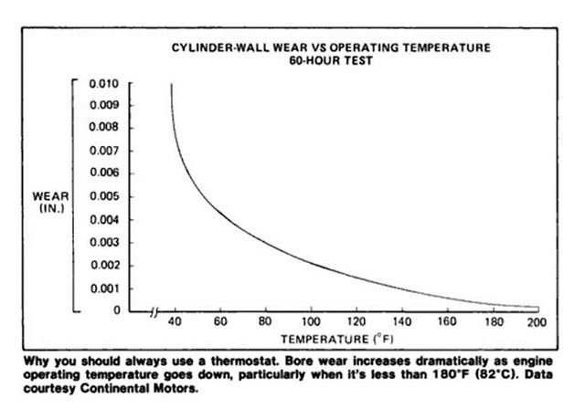

Want 200-220*F for reduced engine wear, and to maintain efficiency and economy.
All power plants no matter what type are more efficient when temperature is higher.
Engines which make frequent short trips are known to have excess wear, so this is both a wear/tear issue and efficiency issue.

Yes, normal temps, since the engine wants to get the motor oil hot enough to boil any water out of it.
Lower temp T state will decrease the normal temps that the motor will be at during light gas pedal use crusing about 20 degreese, but as soon as you get on the pedal harder, temps will climb back up to normal.
As for changing the temp that the raditor fan comes on to a lower ones, double edge sword since the OEM fan was not designed to be run that much. So what happens with the fan temp set too low, fan runs too much, and will do a melt down on the radiator fan on the right hand side of the radiator. Guys will remove the connect, do a hard wire of the wires at that location, causing the next melt down to be at the PWM (radiator fan controller instead)..
So yes, by holding the engine temp lower with better radiator/fans/controller, you can gain some more HP with the motor running cooler, but since the motor oil temp may not get hot enough to boil any water out of it that it collects when you shut the car down and oil cools off, can cause water corrosion problems in the motor isntead.
Simply, how far down the rabbit hole would you like to go, to only gain a few HP in the end.
Hence lower T stat and radiator fan table tweaks are just a short cut band-aid, and will pay for these cheap short cuts in the end with outer problems isntead.
