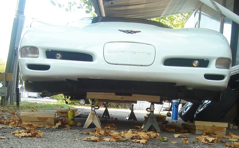

I use two Harbor Freight race jacks; one on either side of the car. I can have the entire car in the air on jack stands in about 5 minutes.
Got a pic of it up in the air?? I'd like to see if it matches the vision in my head. lol. There's a HARBOR FREIGHT up the street here.
This is my previous C5, but same concept.

If you're not aware, there are four slots in the frame, two on each side, made for "pucks" that are available on line and probably e-bay. By using the pucks it not only places the jacks in the right place but also spaces the lifting points about 1-1/2" lower so there's much less of a chance of scratching the body with your jack. The pucks are quickly installed and removed, made of hard rubber and fit into the slots and twist to lock in. I use them anytime I want to lift the car. You do need to get down on your hands and knees to install them, although I believe there are a few out there that are permanent. Still best advice is two floor jacks even with the pucks. Other option is build some blocks like Corvette Ed in the picture of his C5. PS, look close at the picture and see the car is only resting on 3 of the jack stands!!
