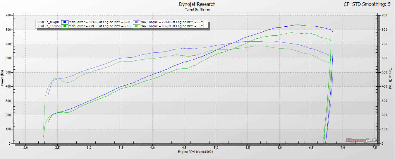

Originally Posted by Downmented
2010 Grand Sport
- ECS Novi 1500 kit
- 14psi (8rib setup)
- 779whp/ 686tq (made several 830+whp pulls on 6rib belt during tuning, with minor belt slip, so it was backed down to a "safer" area where it sits at 780whp.)
- Stock LS3 with 224/240 .612/.603 115+5 cam (stock head bolts, stock head gaskets)
- 42,000 miles on car at time of install
- 50k miles and counting as is.
- No failures as of yet (fingers crossed)
- 93 + meth, Alky control kit with dual m10 nozzles, pure m1 methenol
- manual 6spd trans, mantic 9000 twin disk
- 10* timing
- Mod list - "Me-too-bro" kit, ECS Novi 1500 SC kit, custom cam, valve springs, pushrods, ECS stg1 fuel system, ID1000 injectors, Alky Control kit, Mantic 900 clutch, Kooks 1 7/8 headers and catless x-pipe, stock NPP exhaust. done.
- The car has been raced constantly since the completion, 1/2 mile racing, formal roll racing events, drag racing, ect. Its performed flawlessly the entire time.
//Downmented

Originally Posted by Rob Pod
1/4 Mile #s? (60', ET & MPH)
I am still learning the car, but so far my personal best is 10.3 @136 with a 1.5 60'. That day was roughly 90* out, and a DA of +2700. I still have a lot of room for improvement, but I am getting there.
