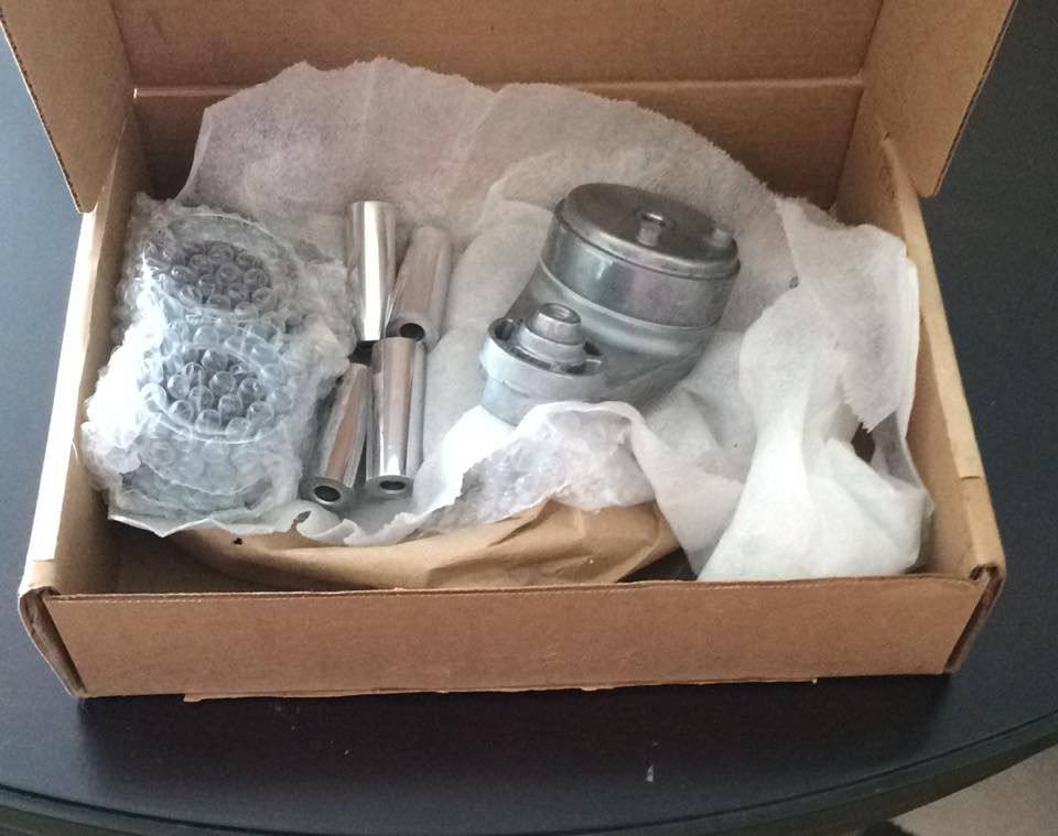

They're finally here. Time to start putting it all together again.

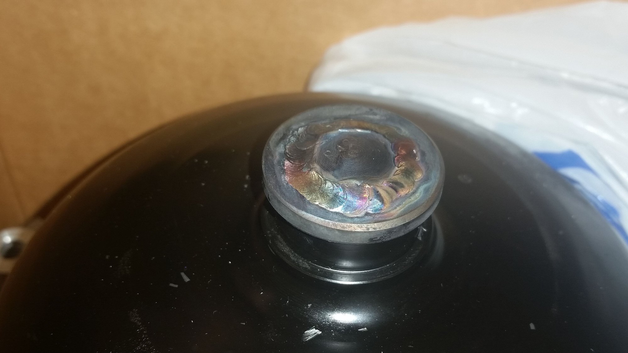

I ended up having to take everything back off and space the tensioner. Put everything back on again. Went to put the supercharger belt on and the ls3 water pump pulley was to narrow. Never even thought about the water pump. So I had to take the supercharger, all brackets, intercooler intake pipe, water pump, coolant hoses back off and drain the coolant. Good news, I went with a ls6 water pump and thermostat. Couldn't find a thermostat housing so hopefully my ls3 housing works. I ended up welding the pulley to the water pump. That way it don't back off.
Tested to see what material its made of. It's definitely carbon steel.
Done! Took literally 2 minutes.
I used 316L stainless steel wire and once it cooled down I painted the bare area to prevent rusting.

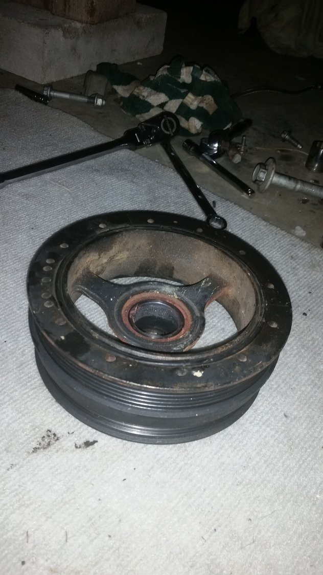

In order to take the balancer off. You have to take out the steering rack. In order to do that you have to take the wheels off, unbolt part of the suspension, unbolt the brackets holding the brake lines and power steering lines. Unbolt the steering rack and pull it through the small opening on the driver side.
This allows you just enough room to remove the balancer.

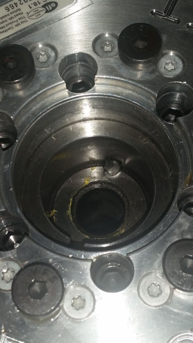

We didn't have a dowel pin kit so my dad being a CNC machinist and me being a fabricator. We decided to just drill it.
We also used a threaded rod and my dad made a spacer to put on the balancer. That way we couldn't strip out the threads.
Dowel pin fit perfect. We drilled it so it wouldn't be able work its way out.

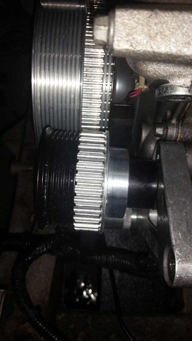

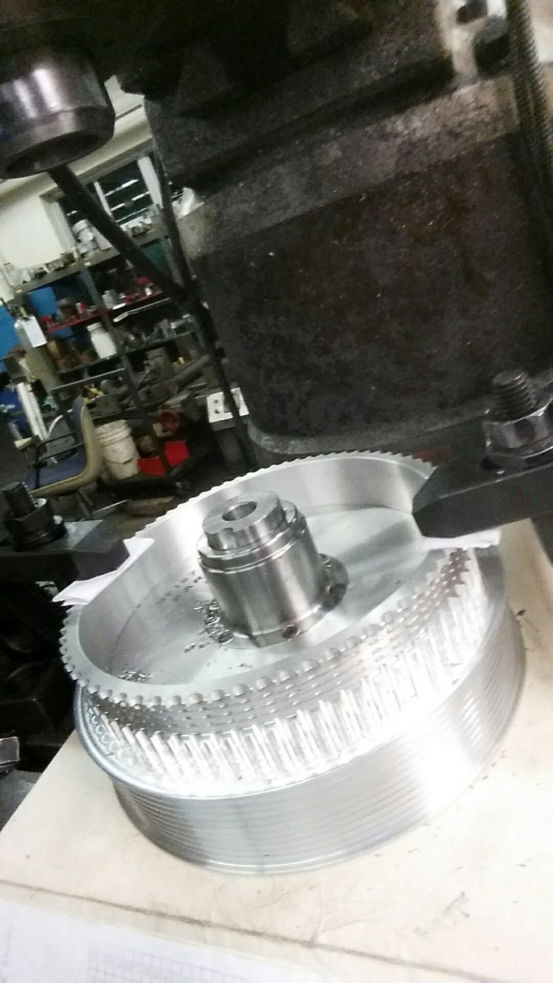

Installed the cog drive pulley but left off the pulley that puts tension on the belt cause its pretty obvious I would not be able to get the steering rack back in.

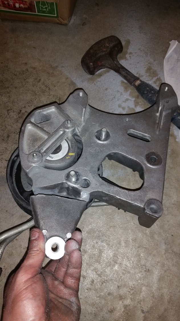

With the cog drive on. I now need to trim the power steering bracket. I marked it off and cut it off with small grinder.

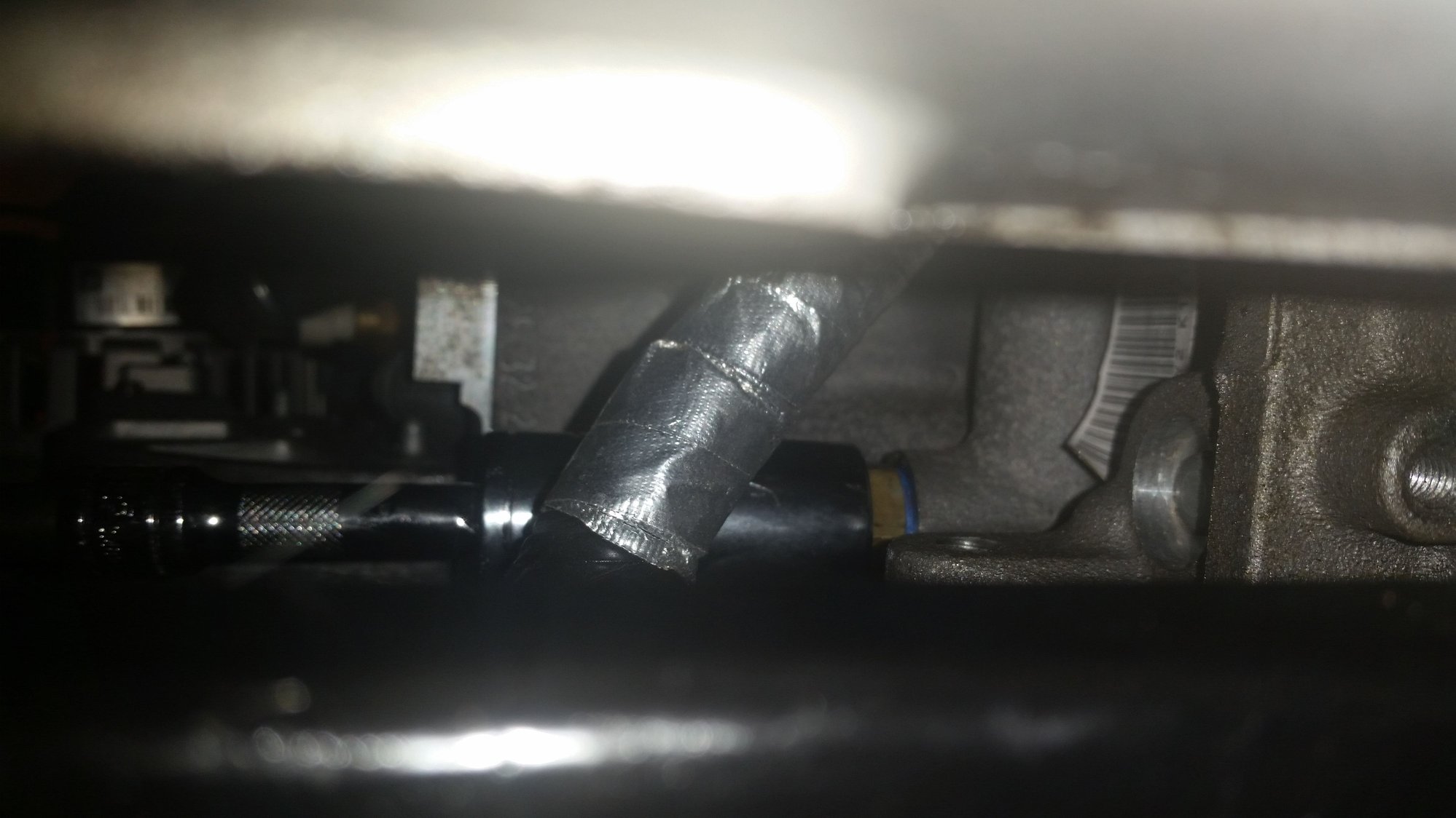

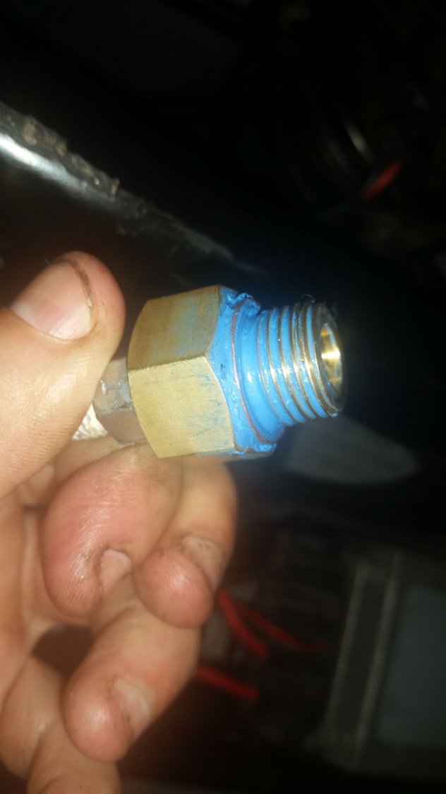

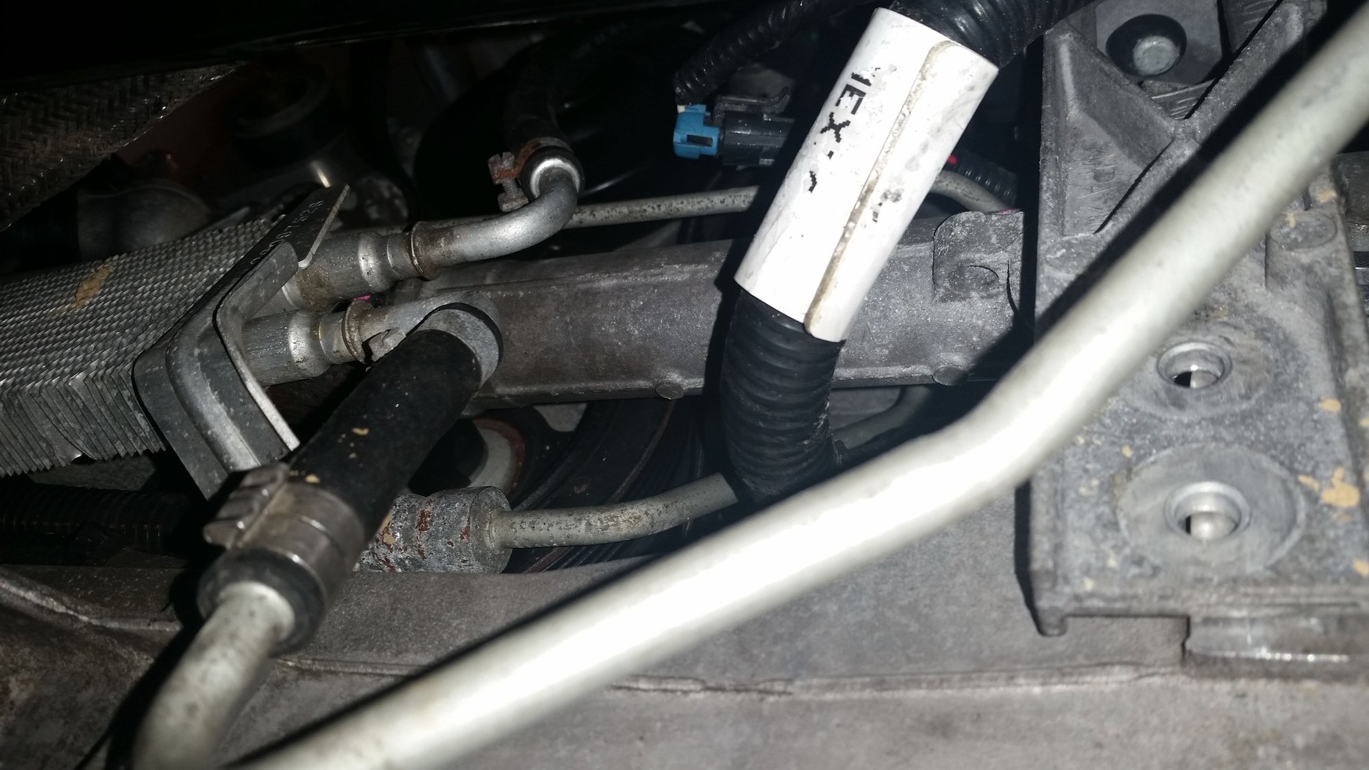

Now running the oil feed to the supercharger. The easiest way I found was use about 18" of extension.
This is the view from under the car. Not much to see. That's why I used the evened and went through the drivers side as pictured.

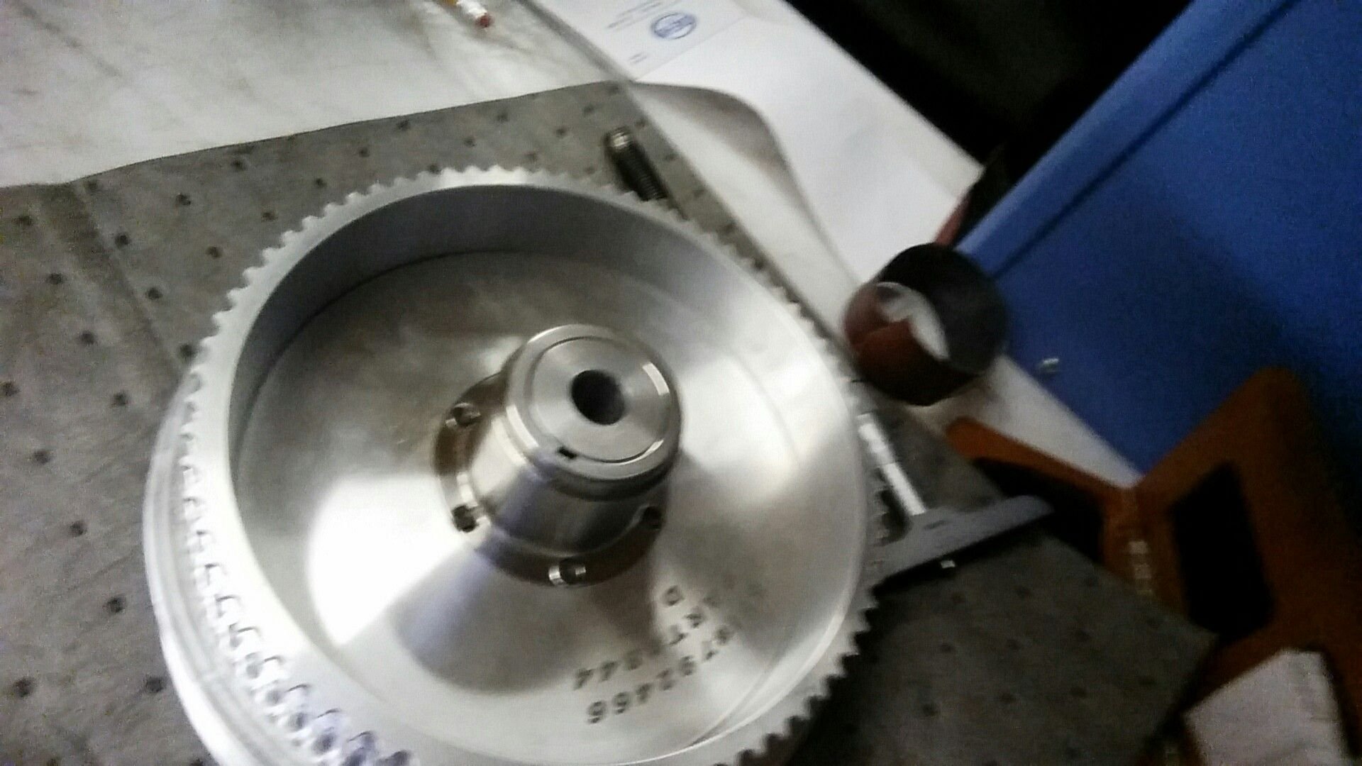

The bracket should be stamped with OD. I have a spare I think laying around. Just moves it enough so when it is there it doesn't touch the balancer.
You can see where it says OD on mine here

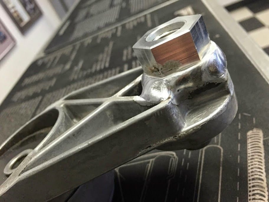

Another great mod if you have access to welding/maching is to do something like this
I welded a 1" aluminum nut onto the balancer. I kept stripping the 3/8" drive. Now just put a 1" socket on it and super easy to open the balancer with no issues.

Liking the 1" nut idea. I've almost stripped the 3/8" drive slot on mine and wasn't looking forward to buying a new tensioner.
