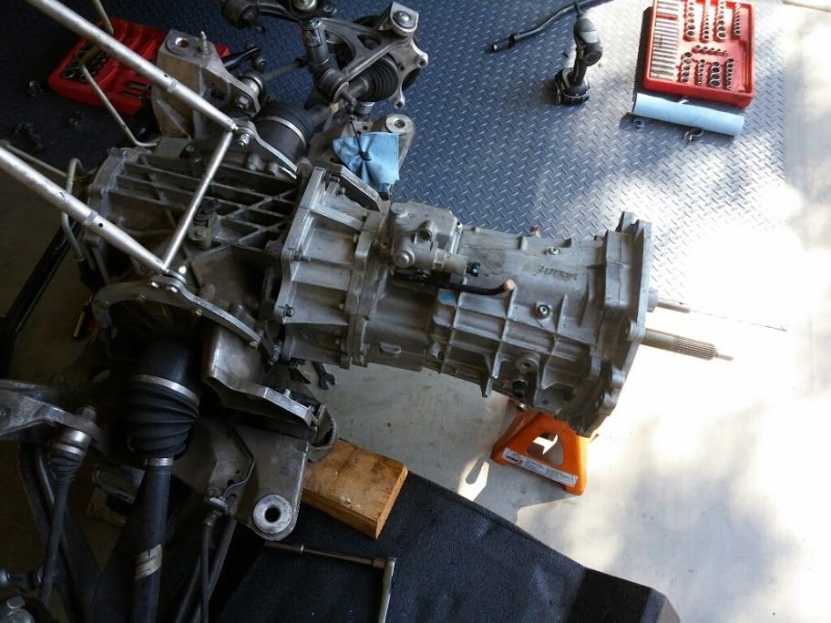

Tranny fluid was clean and bright red, just like when it went in. Amsoil torque drive FTW.
I thought one of the studs for the ECS brace was just a threw stud, but it was theaded into the tranny, so once I popped that out, slid right apart. Was in Houston this morning, 3 hour flight, early lunch then popped it apart. Got old tranny in 2nd garage resting with the new one, and need to go pick up parts. Got 4 days off Fri-Monday so hopefully I can have it running by Monday so I can start trouble shooting and tuning.

From: Gilbert AZ
Can see the new tranny barely hiding back by the mustang wheels and red funnel.
