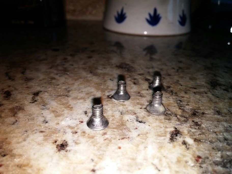

Bad news, while watching the coolant and topping it off, I noticed the balancer wobbling. Stopped the car, and my 10 rib IW balancer is jacked up. Missing 1/3 of the bolts and many others loose or broken.

No idea. I know it has been back to IW to be rebuilt, and last time it was out was at ECS to get the cog mod done. Not sure if they take it apart to do that or not. All I can think of is whoever took it apart last didn't torque or put it back together correctly. Lots of the bolts are snapped off in 1/2, others are gone, and many were just loose and hanging. Only a few were tight. Inside and outside allens were all coming out.
You can see several missing, and that is after I tightened up a bunch there were about to fall out. Will have to pull it next weekend. Hopefully this doesn't mean me buying a whole brand new one, because that would suck.

More pictures. A lot of the bolts in there are broken, just won't pop out.
To Car updates
Old Sep 8, 2015 | 02:55 PM
  #138
Unreal's Avatar
Unreal
Joined: Nov 2007
Posts: 24,035
Likes: 2,342
From: Gilbert AZ
How most of the screws are. Sheered right in 1/2.

I have seen that on another car too, we sent the balancer back to IW and they repaired it using larger bolts. We got the same balancer back so the cog mod should not be an issue.
I would contact them ASAP if you are short on time so you get it back as quick as possible.
Just an FYI, we do not disassemble the balancers at all to do the cog mod.
Fluid usually leaks from them too when the bolts break, have you seen any red fluid being slung around?

There is signs of fluid around the bolt heads. Good to know. I contacted Chris who was going to get back to me. He was going to work with IW to help me out. I'll get in touch with them. Just didn't want them freaking out blaming you if this is an issue with them. I can't get it off until this weekend anyways. When I talk to them, I'll see if they can get it done in time, or I maybe ordering another cogged one, or have to cancel the race. Sad. Was 3/3 for fastest LS car out there and want to keep my streak going.
