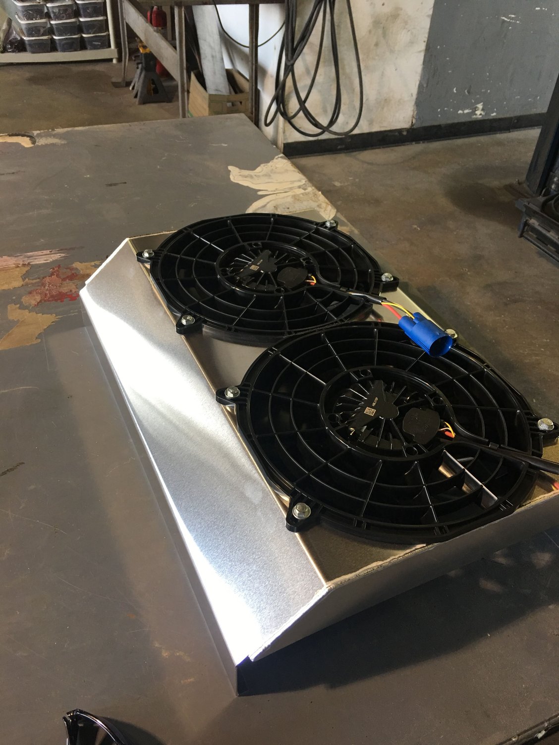

Got the new fans in, how has yours been cooling with the hotter weather Unreal?
