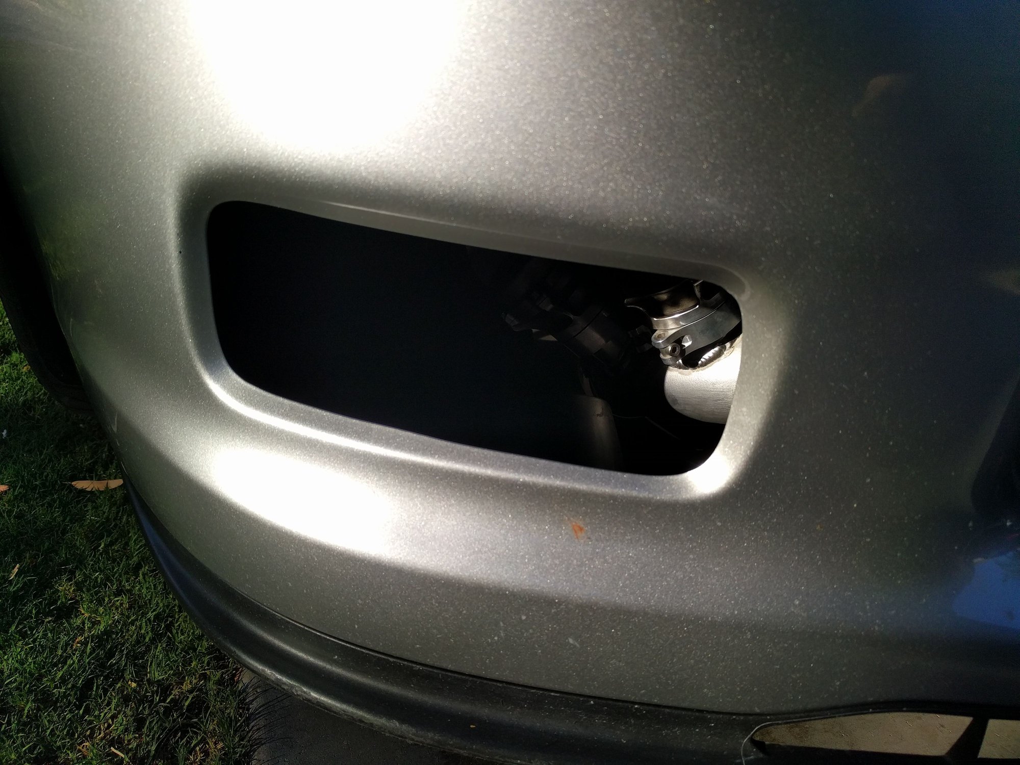

B&M 70298
Fog light had to be removed, and cooling duct, and bottom part had to be cut up/removed.

Originally Posted by Unreal
B&M 70298
Do you have any good pictures of your fog light holes from the outside looking in to see the cooler? I'm wondering how "finished" it looks and I assume it gets enough air directly across the cooler. The only reason I'm thinking about doing more is that the oil temps are driving my coolant temps right now. Coolant temps hover at 175-185 until the oil temps pass them. Then the coolant temps creep up with oil temps, especially in traffic.

Are you even having a cooling issue? Everything you said sounds like your car is running perfectly normal.
It looks unfinished, and if that is a concern, then doing a bunch of race car stuff may not be the best solution. You have a big gapping hole on each side. I know Jody put some screen or something to make it look better. I don't care, so it will stay as is.
If you aren't seeing 235+ in traffic I couldn't imagine spending $800+ and hackup up the car for something like this.
