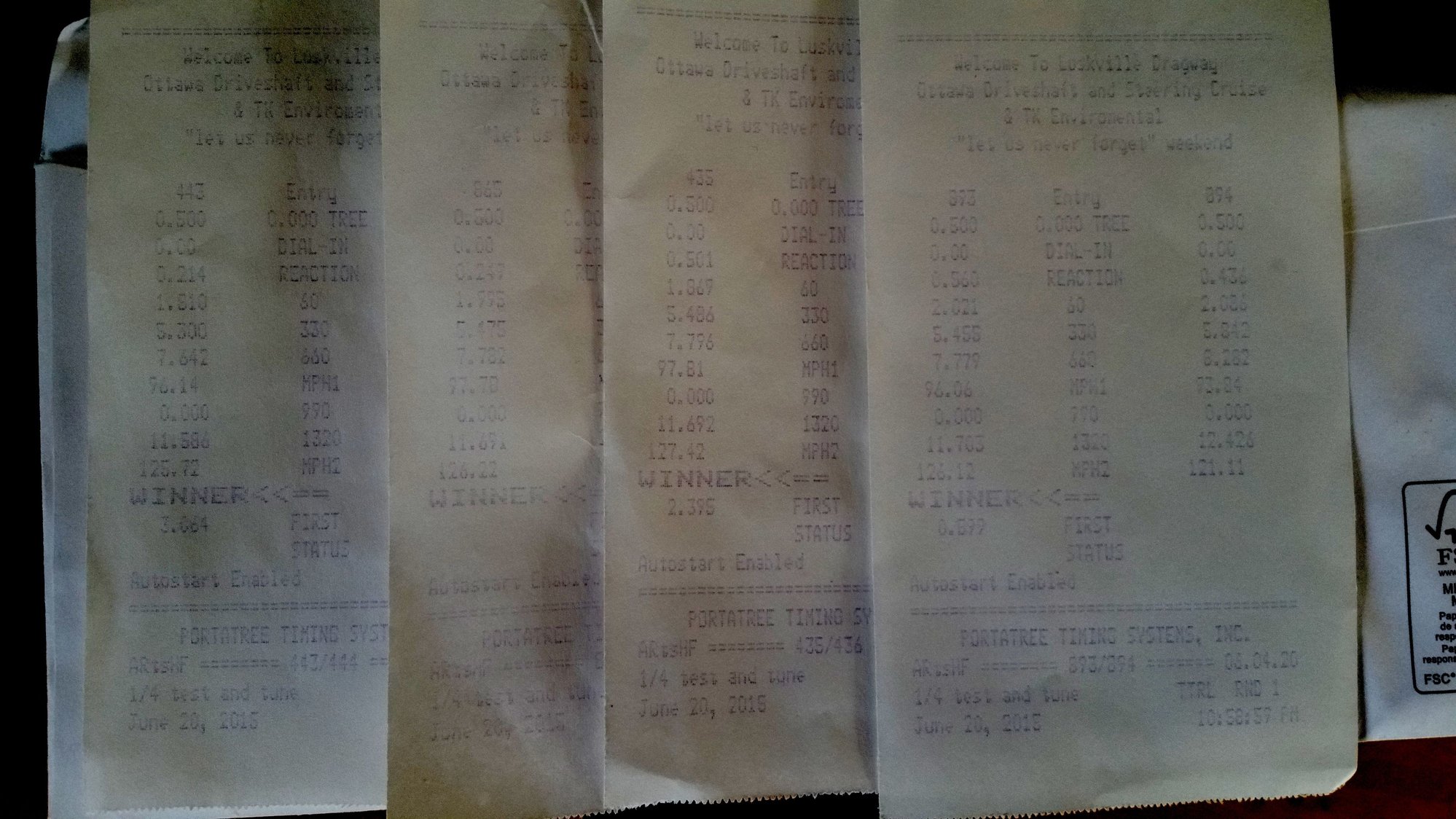

Here's my best 4 passes with a total of 18 under my belt. I think on the right track, the car should be 10 worthy. I understand I need many more passes for getting it all down, but hoping I could help the learning curve from guys who are willing to spread the knowledge. thanks in advance

Well they all say winner is all I know, so chicken dinner

LMAO i love chicken dinner
We don't have many "fast" cars around here, or at least spending time at the track. I know everyone that chimes in will say seat time, seat time, and more seat time. It's just a little fustrating that with all the extra power and set of DR's I'm barely besting the 11.7 stock numbers and miles off of Rangers 10.71 stock with DR's.
To be completely honest, and that's not going to put me in the record books, i'd be more than thrilled to match Rangers time even with and extra 150-175hp lol
I feel like if I could get that 60ft time down to 1.50 I may have a chance accomplishing my 10's goal.
are you supposed to roast Drag radials, or just a good 4-5 second burnout?
was just looking for some first hand experienced input from other vette drivers that's all. No point asking the Impreza STI guy that runs AWD and launches at 6500rpm. Need input from veterans with the same car I think at least.

You are on your way. It takes time and the car will pickup a lot in the cold air.
A few answers for now.
You don't need to roast the drag radials. 4-5 seconds is fine as long as you are seeing white smoke. Keep in mind not all drag radials are created equal.
Yes, shift at redline for best result when the car is dialed in.
Are you on the stock clutch??? If so then you will have to get off it quickly and but not fully dump it. The stock clutch changes the launch approach completely.
With your setup and experience level, I'd like to see you launch around 4000rpms and adjust tires, tire pressure, shocks, launch technique from there. I'd probably start around 17 psi cold at this point with a drag radial and a clutch.
Ideally most all manual vette guys should run bias ply tires out back with skinnies and you will enjoy the race experience so much more. As you know there are a ton of variables and we can help you better if we know more specifics about your setup and if you provide some launch audio and video from the side.
