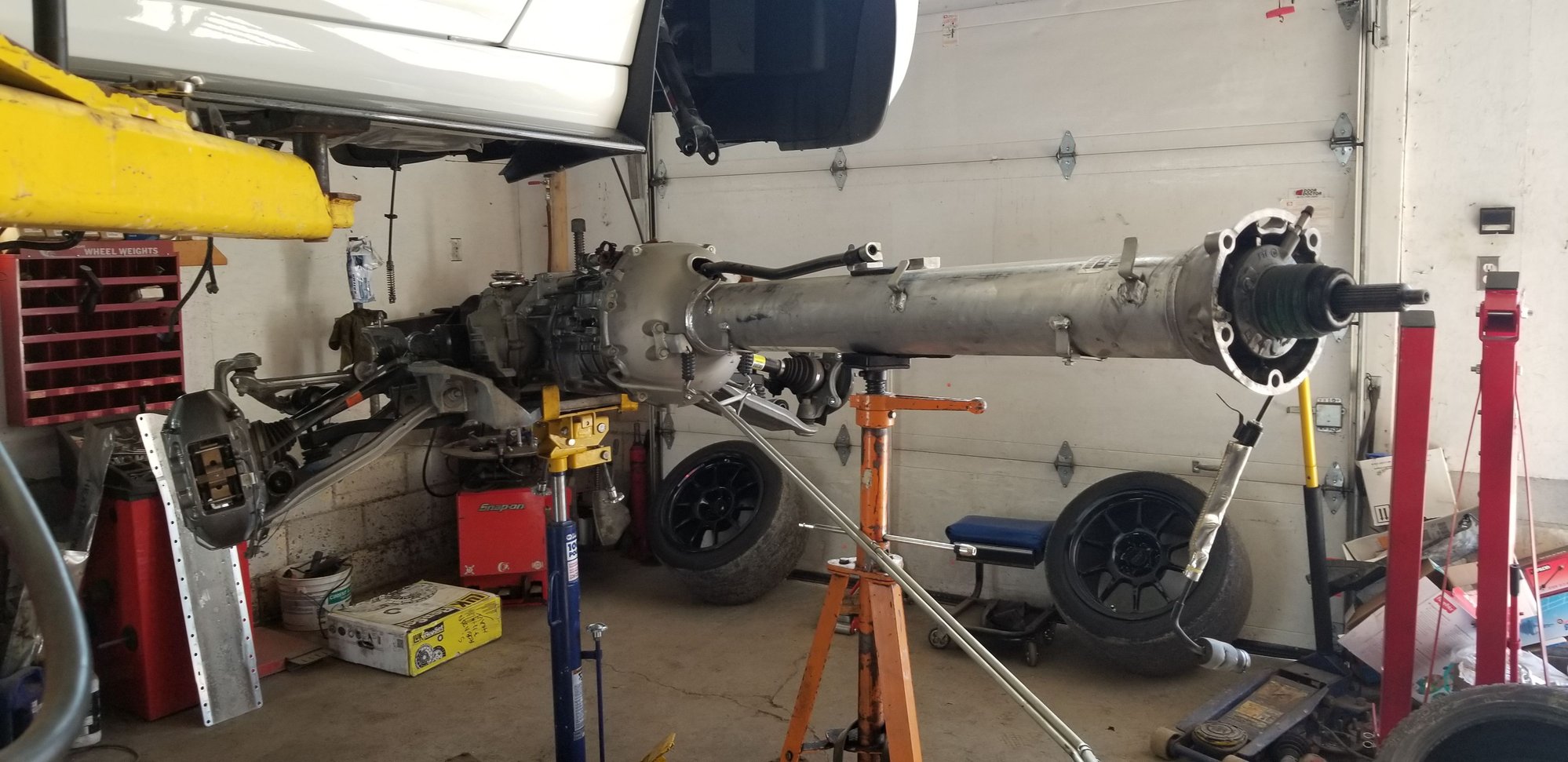

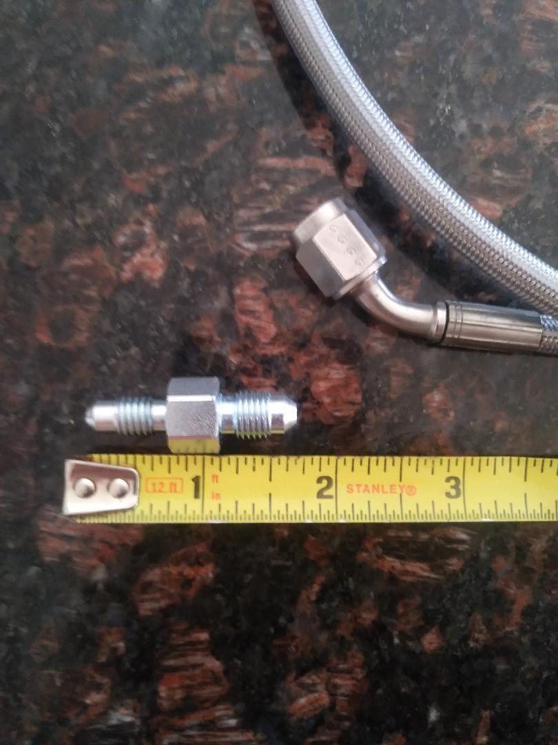

Half way done with my first clutch change!!! These write ups have made it much less intimidating and enjoyable even on jacks!!!....THANK YOU... Could you possible lead me in the right direction of getting that extension fitting between the slave and the speed bleeder? I got a Tick performance bleeder and it does not have that piece. Thanks again.

Originally Posted by captain trash
.... I got a Tick performance bleeder and it does not have that piece ....
I ordered the same part from Tick and it had the fitting to the slave, the braided cable, and the bleeder on the end. I'm sure if you're missing a piece Tick will send it to you.

Thanks Dutch. It did come with a fitting it just looks about half as long as the one in the pictures????

Yep that's it, just install that and then the braided line into it in place of the long bleeder that was in the original.
(BTW: I didn't want to have to redo the fitting so I used a thread sealant for hydraulic fittings in addition to proper torque. Don't use Teflon tape. )
Oh I forgot, be sure to point the elbow connection toward the master, if you can, makes routing a lot easier.
Yeah, this is the best clutch install how-to I have ever seen and I used this when I did mine.
As for the Tick bleeder, I advice being very very careful when you re-install the torque tube as it seems to be relatively easy to bump the fitting and crack it and then you only realize this when you have a massive leak but everything has been re-installed.
A lot of people recommend going with the Katech bleeder because of this potential issue.
Captain trash, where is the jack stand located in you picture (or is that one just off to the side)? I have mine on the rear lift point but I would like to move them aft, if possible. Thank you!
I had all four of them under the main lifting points by the rockers. Sorry for the late response.

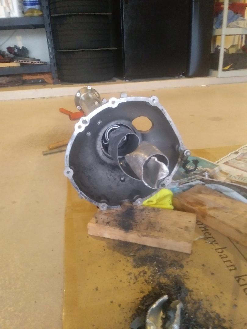

And of course this happened shortly after the clutch replacement.......I put about 400 street miles on the new clutch no issues, sounds, nothing. Went to the Mondo event at Wild Horse and was on my last session of the day when this happened. Obviously I drive the heck out of my car but it happened at a moderate acceleration in third gear after a nice straight down the strip. Didn't have any warning signs; my RPM's suddenly went through the roof as if the car had come out of gear. Tried to put it back in gear (it was still in gear) and nothing...Called the tow truck! Just wanted to share this with everyone. I of course initially thought the mechanic (me) F'd something up, but to my surprise all was good with the clutch and what I actually touched (unless anyone can speculate otherwise)....anyways like I said just want to share my epic failure with everyone...feel free to laugh at my expense.
This hurts my heart. I just completed my first clutch install using this guide (and I disagree, this is NOT enjoyable on jack stands ). Getting the torque tube lined up was a bitch, let alone having this happen. Sorry, brother. Hope you get it fixed soon!
