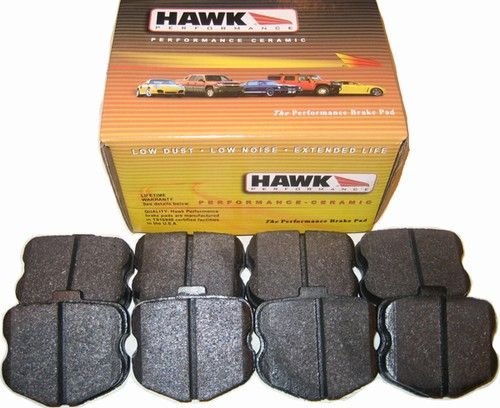

Yes I never they say didn't Kevin. As we discussed at the very beginning, you should not have to pry the pads out as you did. Also cleaning the pins up and making sure that everything moves easily is key for your pads to clamp down evenly. I have no experience with those modified version of your pads you purchased, but that design might be part of the issue. I myself would have never went that route. I was planning to go with the hawk pads I showed you earlier when the time comes. They are proven to be quiet and create very little dust. If you cleaned up everything and the pads can move freely, that should fix the uneven wear. Unless you have a caliper problem that is. I suggested that you compress your pistons 1 by one and see if any have resistance. You hadn't mentioned anything about that so I am assuming it was all good.

Ok I get it. I'm not sure I'd like that design. Each piston (4) per caliper is designed to work by itself not together one pad. The pin going through the middle of the pad begs for dust collecting and eventually start to bind.
Why not opt for the hawk pads if the dust and noise were a problem, but stick with the proper design. I have about 32k miles on my Z06 and still have stock pads and I have no noise issues but they do make dust.
