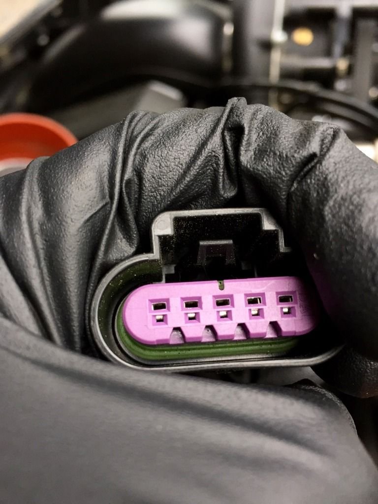

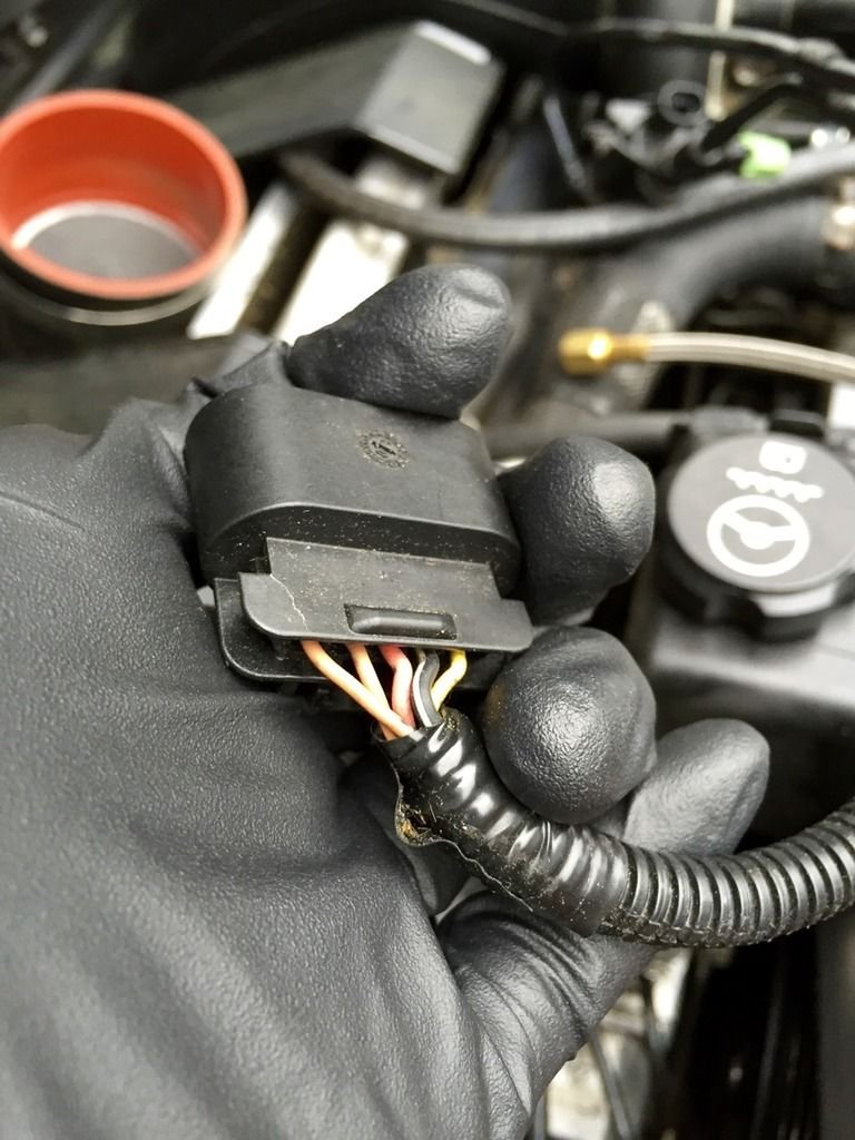

You have to pop the purple thing off the bottom of the connector and insert a very skinny tool into the smaller opening near the pin(s) you want to remove. The purple thing comes off by prying it gently from both ends.. it will pop off without too much trouble
There's also a cover on the opposite end of the connector that you may or may not have to pop off (I've seen it missing on a lot of cars for whatever reason). It's already removed in this picture
The wires in the picture are from a 2005, so the colors may be different on yours, but the locations should be the same. The two on the left are the same color and are for the IAT sensor. The other three are for the MAF sensor. Pulling any of the three should do the trick (power/ground/signal)
